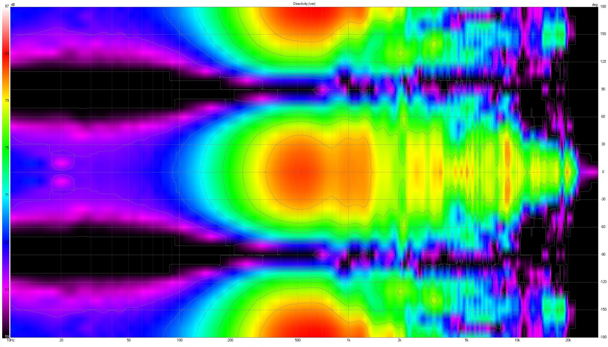

I covered with foam sides of beams and speaker, so beam outer edge radius is much bigger, but no significant change in to better direction in directivity. Changes are very minor.
Correction is also made to on axis response, it is also different with previous version.

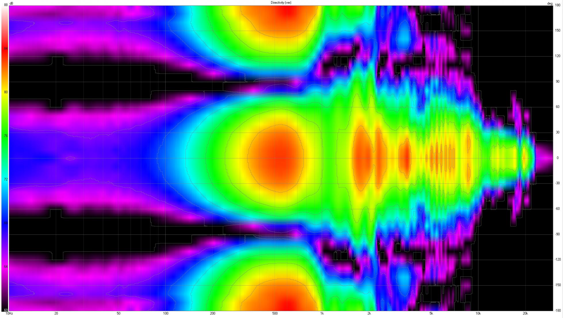

Made some new measurements.

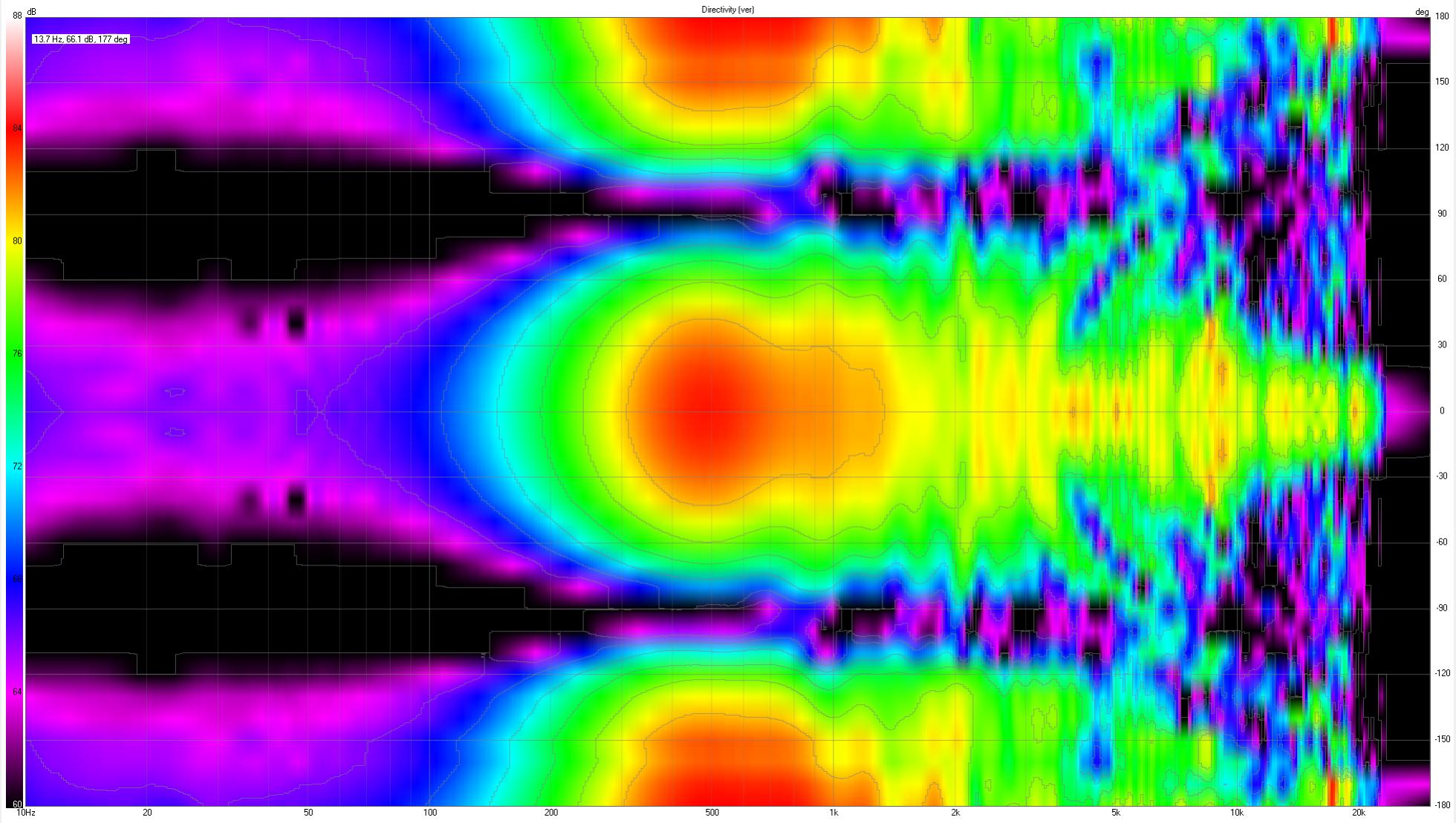

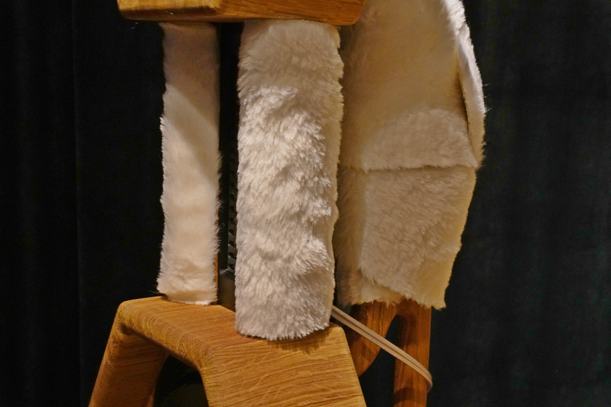

First wrapped support in "dead cat" (fake fur) like material in multiple layers and get this:
Then added same on the beams from front to speaker magnets, under that is also insulation foam layer.
Improvements are visible, only drop at about 4.5 kHz at 30-60 deg. remains.
But on image plot without fur on beams looks better.
This is how it looks

You've build a very nice cat scratch post there! 😀 Just kidding, that is a real improvement, that looks a lot better!

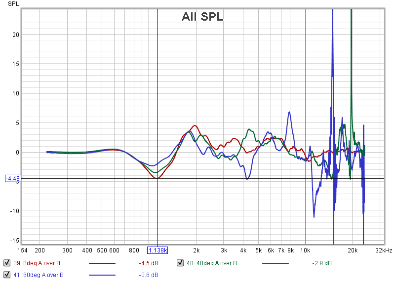

I was not sure about peaks and minimums and made measurements with ATMPRo4 closed back, closed with supplied felts. Mid is still as OB and filter is on 1 kHz.

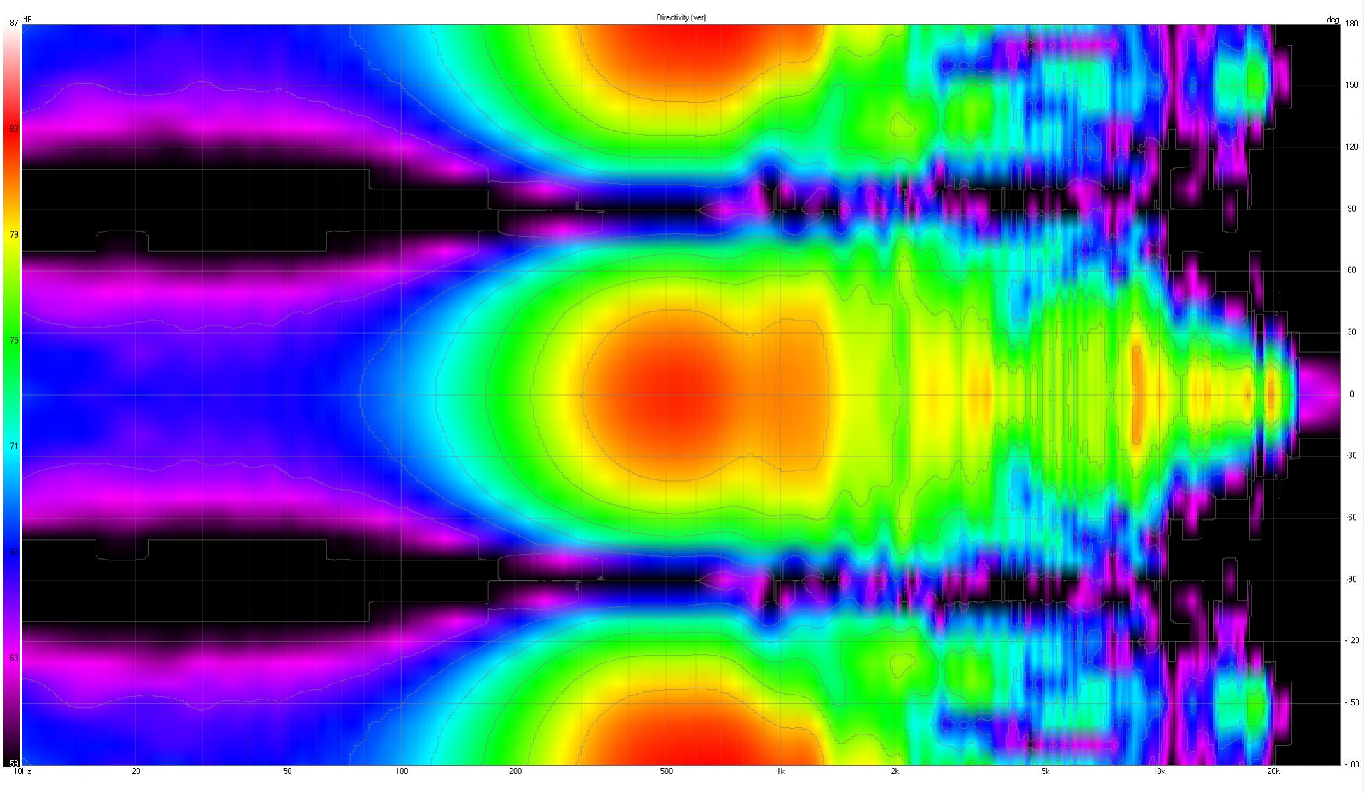

First polar plot
and on axis OB and closed back comparison in way closed/OB response.

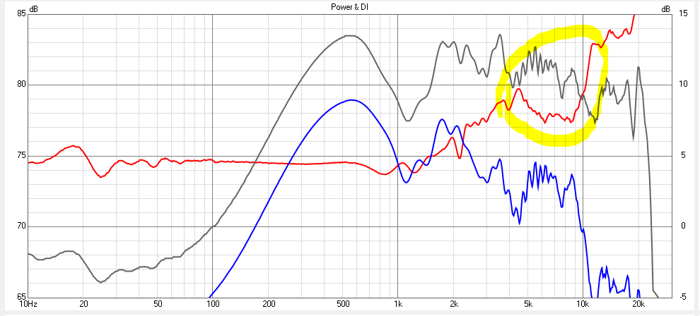

From this measurements I understand first dipole peak is at 1 kHz somewhere, and first minimum at 2 kHz. Drop at 4 kHz is caused by speaker rear radiation and horn formed from beams, also horn is probably compensating dipole minimum on 2 kHz in OB configuration.
Can anyone tell how to change horn/beams shape to make directivity wider on 4,5kHz, or actually in range 4-10 kHz as seen from DI plot?

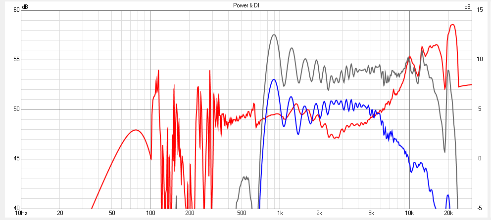

For comparison I dig out data based on what was generated images in first post, where ATMPRO4 is in original OB configuration without any beams or foam. I modified data to same gating window and polar plot range as on latest measurements, but it is without mid range speaker.

Beams had also some advantage. If you look measurement of naked/original open back AMTPRO4, its polar plot is asymmetrical, minimum level is not on 90 degrees over all range. Beams made polar plot in OB configuration more symmetrical, but created dip on 4.5 kHz.
Closed back measurement was made to see pure forward radiation pattern, effect of beams and to understand in comparison with OB measurement where are peaks and nulls.
Partly question is also what is better: symmetrical font and rear radiation with dip on 4.5 kHz or asymmetrical radiation without 4.5 kHz dip.
Third option is to modify beams in way that symmetrical radiation is preserved and 4.5 kHz dip is removed.
Forth option is to live with this 4.5 kHz dip and enjoy music.
I can do changes, but first I am interested to find reason of the dip and to be sure changes will improve polar plot.
