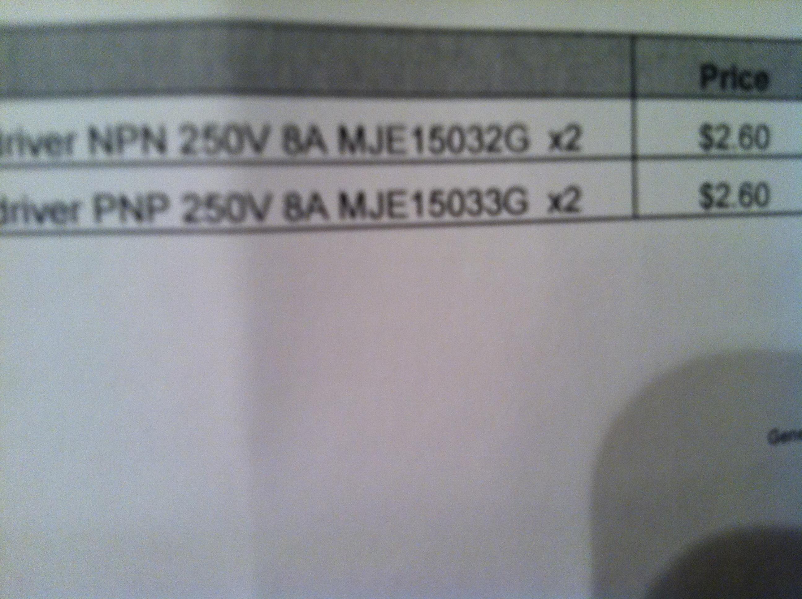

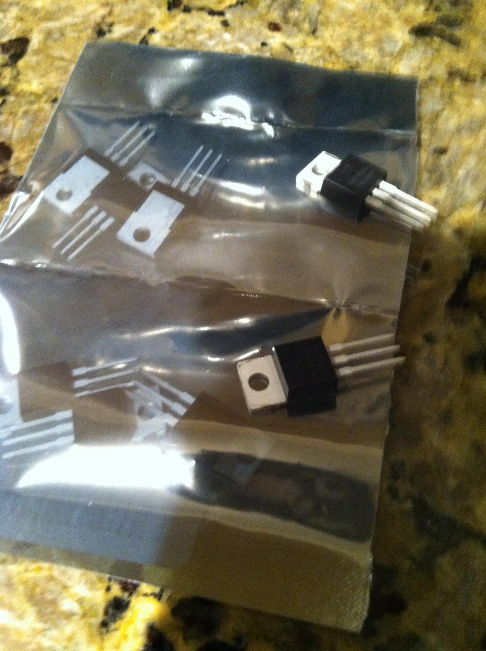

djk said:I'd like to see you replace the 200V 2N3584/6421 in this circuit with 100V TIP41/42 parts. They are not the series connected drivers.
Looking at the voltages stated in the GAS schematic for the 121F driver boards, the driver transistors Q117, Q118, Q103, Q104 each have 1/2 of one side of the B+ supply from C-E, 40V out of the +/- 80V supply, so they are within 100V ratings in static conditions. At the 44VRMS output voltages that I observed, they would experience peak voltages of as much as 88V C-E unless I'm wrong. That would also be within 100V ratings.
That's not to say that TIP41/42 would be ideal components for this purpose, but the application appears to be within their C-E voltage rating.
Please clarify if I've misinterpreted.
Q107, Q114 are the ones in the Ampzilla II that need to be the high voltage types (2N3584/6421).
Q7, Q9, and Q10, Q11 on original Ampzilla also require the high voltage type.
djk said:Q107, Q114 are the ones in the Ampzilla II that need to be the high voltage types (2N3584/6421).
Thanks for the verification. For safety, I used MJE15032/33, which are 250V rated parts.
