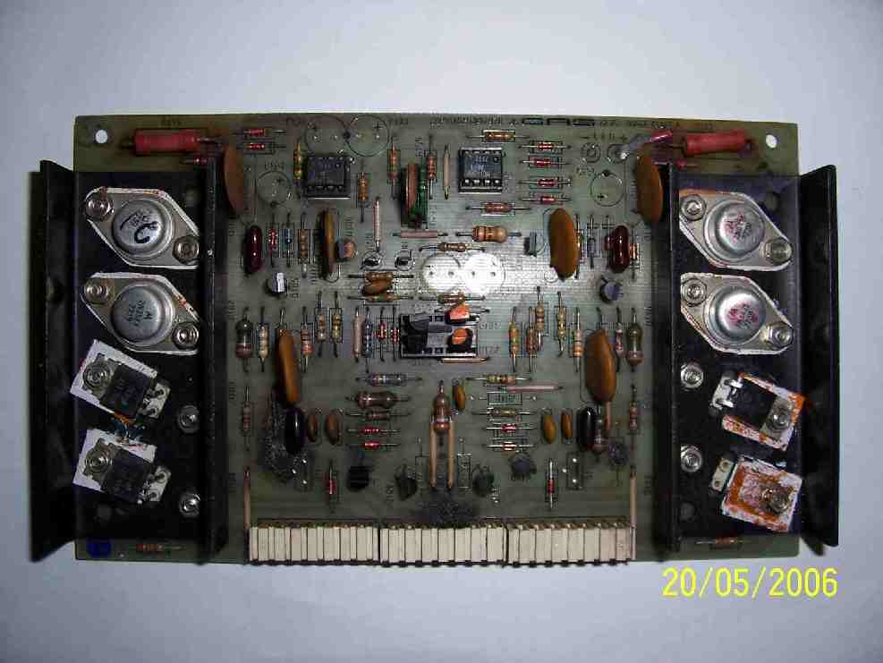

On my ampzilla II one channel has blown. Now i am looking for a
replacement for 2N3584 and 2N6421, also if it´s no TO66
Do you have any suggestions which transistors i can use wake up this amp again. Also i would like to buy a working PCB.

For the TO -66 mounted on the side? MJE15030 & 31

yes i am looking for the TO66 on the PCB like you can see on the picture. The GAS116/117 are already changed to MJE150028/29 in TO220
Did you already replace the 2N3584 and 2N6421 with the MJE15030/31 ?. Iam a little be worry because for 2N** the Uce =350V, for MJE Uce=150V and rail is +80V to -80V

As long as you are not bridging them there will be no problems. The SAE forum will also tell you that no one is capable of rebuilding the SAE or Ampzilla except for JB of course and several other hand picked boys of JB's.
I get most of my spending money from rebuilding the SAE's and Ampzilla's that are sent to me from people off the SAE forum because I will fix them for a decent reasonable price.
Pay particular attention to the large resistors on the board because they can and will change value and this will cause you some heart ache.
Good luck. Take your time and you won't have a problem. Also change the bias pot because age will cause a problem here also.
"DJK, Dennis has corrected my numbers."
The MJE15030/31 are probably OK at ±80V, even though only rated at 150V.
The MJE15029/29/30/31/32/33 family are obtained on a selection basis. They start out the same, they make them, and then grade them. Ones that aren't good enough to be the 250V group become the 150V group, etc. This implies that the 120V group cannot do 150V, and the 150V group cannot do 250V, but may be a bit better than 150V (enough for ±80V)

Here's one question to start with: I'm looking for replacements for the 2n6421 and 2n3584. Earlier in this thread it appears to indicate that 15028/30 and 29/31 can be used as substitutes, with the only concern being the voltage rating. I have 30, 31, 32 and 33 on hand, maybe a dozen each.
My question is about how to select the devices by Hfe. According to the datasheet that I have for the 2N3584/2n6421, the Hfe is rated at 8 min and 80 max.
The datasheet for the 15030/31 states the Hfe as 40 min and no max. I have a pile of 1503x devices here, about 10 - 15 of each. I ran them all through the Hfe tester on my DMM (for what that's worth) just to see what ranges they turn up in.
The results:
15030: 100 - 150 (NPN)
15031: 190 - 225 (PNP)
15032: 20 - 50 (NPN)
15033: 75 - 130 (PNP)
That looks like a very large difference in Hfe ranges, and much higher than the 8/80 rating of the 2n devices being replaced. Won't inserting new devices with much higher current gain change the performance of the circuit?
Any guidance would be appreciated.
Background: Elecrtronics school in the '70s. IT Professional, audio hobbyist. Primarily tubes. I can do anything with tube audio & have a lot of experience. Solid state, not so much. Direct coupled SS power amps with 20 active devices in the circuit are difficult for me because I don't have an intuitive sense of the method of operation the way I do, say, a Williamson tube amp. I'm also active on AudioKarma, where I was the Speakers forum Mod back in the Jurassic when it was a few thousand people.
Those old amplifiers will work fine with a modern driver transistor. They don't really need one, however, because the outputs are in series and each only sees half the total rail voltage. Well, maybe a bit more if those large power resistors drifted over time/temp cycling. You could get away with 100 volt grade devices (TIP41/42C) as is used in the Dyna 400. MJE150xx is a better device, and even a 120V grade version is plenty good enough for the application.
As far as how much beta you can get away with, just about anything reasonable. It only has two stages of current gain and I doubt you could over-do it and make it oscillate unless you tried really hard.
Thanks for the reassurance. I had rebuilt one channel and it passed signal but had too much DC offset for the servo to deal with. I knew there had to be some drifty parts. I pulled all of the 2n5551 and 5401 xstrs, replacing them with matched pairs. For the 2n6421 and 2n3584, I pulled them all and replaced them with 15032/33. The channel fired right up (on the Variac!) and settled down smooth and quiet. IT now makes 220W at clip with both channels running.
The other board from this set had some parts fail catastrophically (flames). I pulled every semiconductor and every cap, and all out of spec R's. I'm rebuilding this board with teh same parts I used on the first one so they'll be the same.
