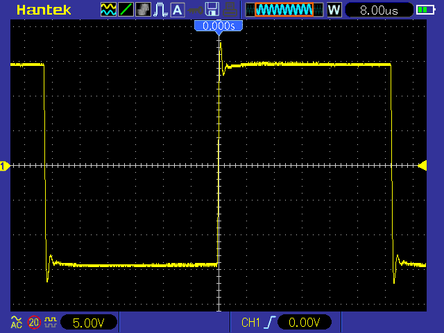

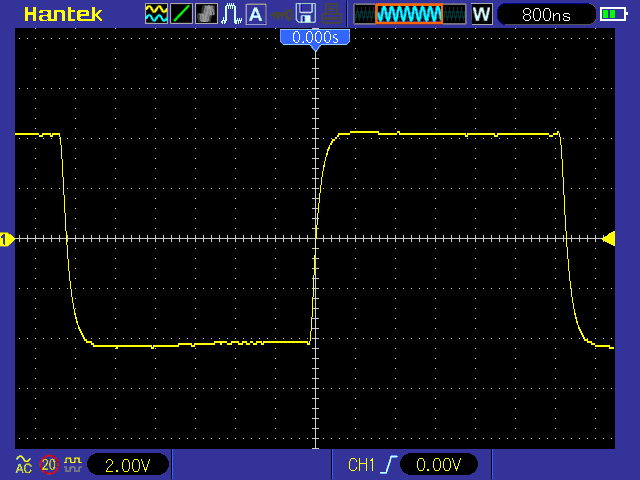

Yes, it has nothing to do with stability stability, that’s why it has to be removed as a confounder during initial testing with a resistive load.
10 kHz 28Vpp response into 150 nF+10Ω || 8Ω
No signs of any instability and we could now identify if there was any oscillation from amplifier.

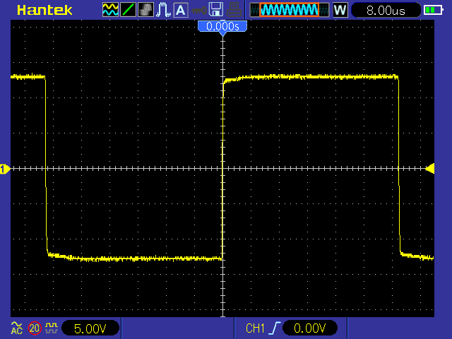

Yes, as said, it was adjusted at the signal generator. Not caused by amplifier.

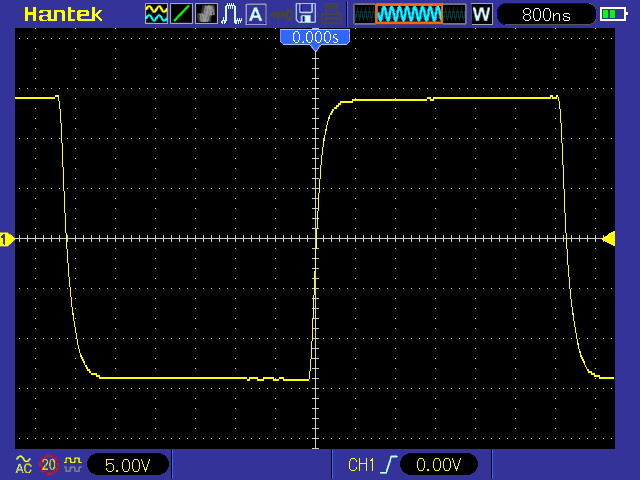

Here are unlimited responses at 100 kHz. Amplifier has +/- 17 V supply.
4 Vpp/8Ω
28 Vpp/8Ω
I see the resistive load - I missed it in my earlier post. Apologies.
The rise time <> bandwidth rule of thumb indicates a closed loop bandwidth of 1.16 MHz. Do you think that’s a good idea?
Depending on my goals, nothing wrong with that.
Actual closed loop bandwidth is 1.3 MHz. During development, amplifier was operating as perfectly stable with any capacitive load at 1.8 – 2 Mhz. All above tests are without input RC filter, which this amplifier has.
My goal was to see how far I can get with low power class A amplifier at all parameters: distortion, slew rate, output impedance, noise, EMI immunity, consistent harmonics profile through all power levels and loads, while not compromising stability at all.
PCB is 4-layer with outer layers used as static shields, so amplifier is safe even from some high EMI pulse affecting stability. Needles to say, this design was thoroughly tested (harassed actually in all imaginable ways) for half a year and it passed.

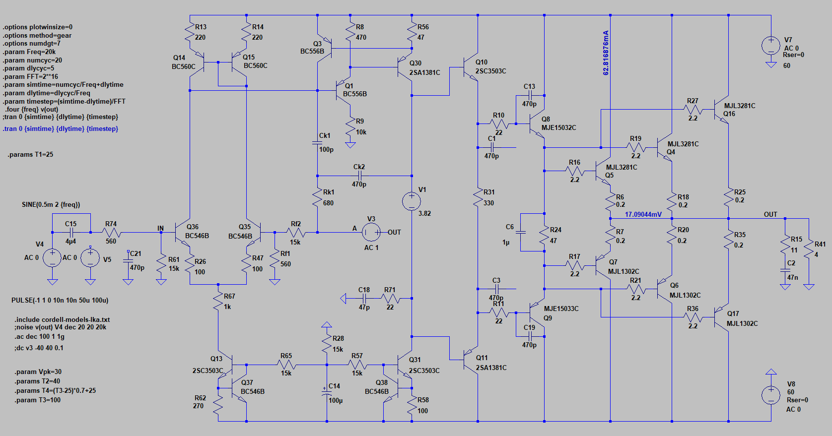

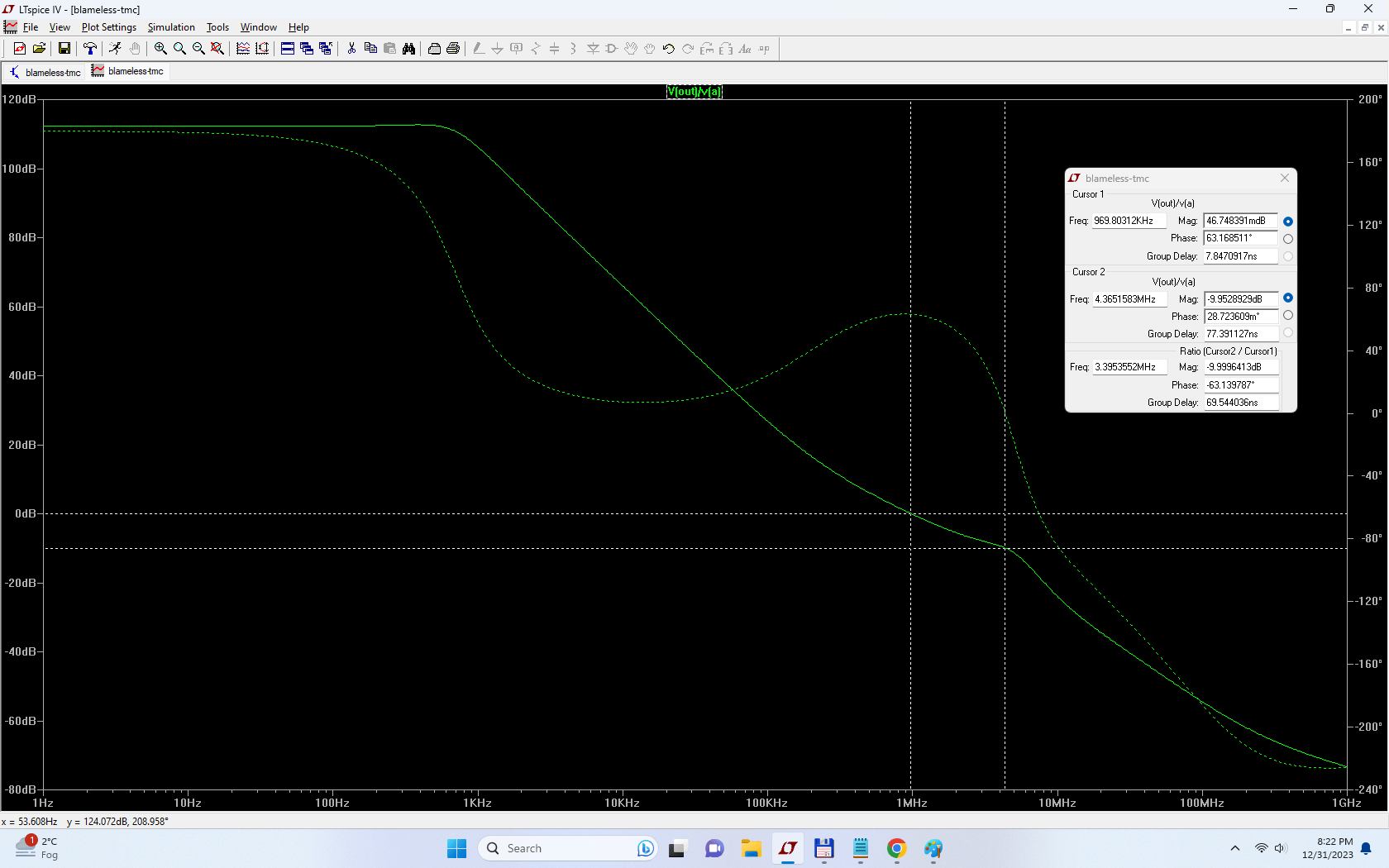

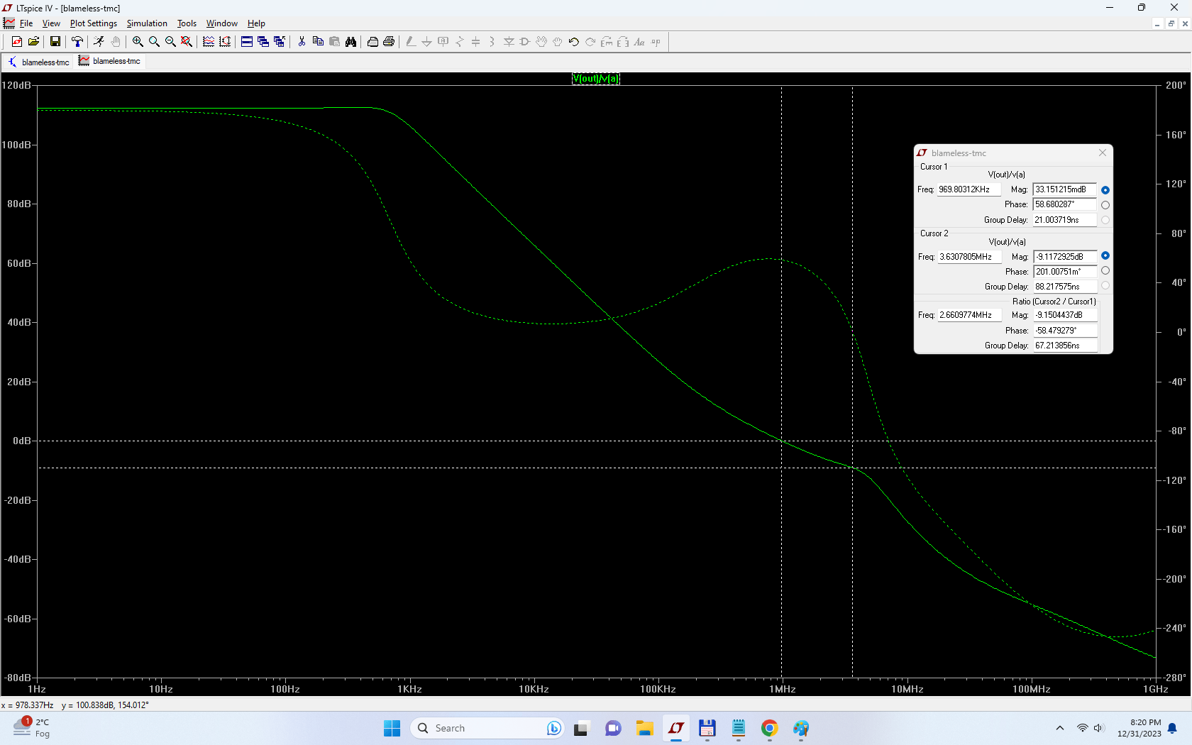

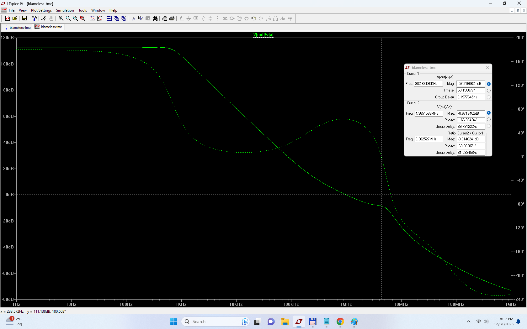

My simulation of the blameless with tmc compensation. The ULGF is about 1MHz.
The differences are greater when higher ULGF is used.

I still don't really get your point. I put data derived from your plots into a table for my convenience and easier comparison:
no capscaps to railcaps parallel to base stoppers
UGLF980kHz970kHz970kHz
Phase margin63°59°63°
Gain margin9dB (4.4MHz)9dB (3.6MHz)10dB (4.4MHz)
Group delay8ns21ns8ns
Delta3.4MHz 9dB 82ns2.7MHz 9dB 67ns3.4MHz 10dB 69ns
It is obvious that the caps to the rails do have some impact on the speed of the OPS, but I don't really understand how this affects loop compensation that much.
Local instability of the OPS may be just swamped by simulating a whole amplifier with the OPS in the loop.
Have you investigated the OPS on its own and the effect of different options to tame the beast?
Adding some real world wiring inductance (at least a guesstimate of it) to the simulation makes a big difference, too, especially in OPS.
What don't you understand ? Data says everything.
I have also verified it on my real amplifier.

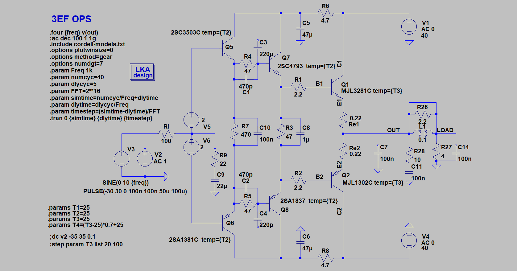

Another example
blameless topology, 3 pole TMC, 3EF
driver tr 2SC4793/2SA1837, base stoppers 47R
no cap across base stoppers, no BtoC cap on drivers
ULGF 3.2 MHz
PM 64 deg
GM 8 dB
no cap across base stoppers, 220pF BtoC cap on drivers
ULGF 3.1 MHz
PM 44 deg
GM 9 dB
470pF cap across base stoppers, no BtoC cap on drivers
ULGF 3.1 MHz
PM 64 deg
GM 17 dB
470pF cap across base stoppers, 220pF BtoC cap on drivers
ULGF 2.9 MHz
PM 50 deg
GM 17 dB
The 220pF caps on the drivers degrade the PM by about 20 degrees (LTSpice says, not me)
I have nothing to prove anymore, try it.
