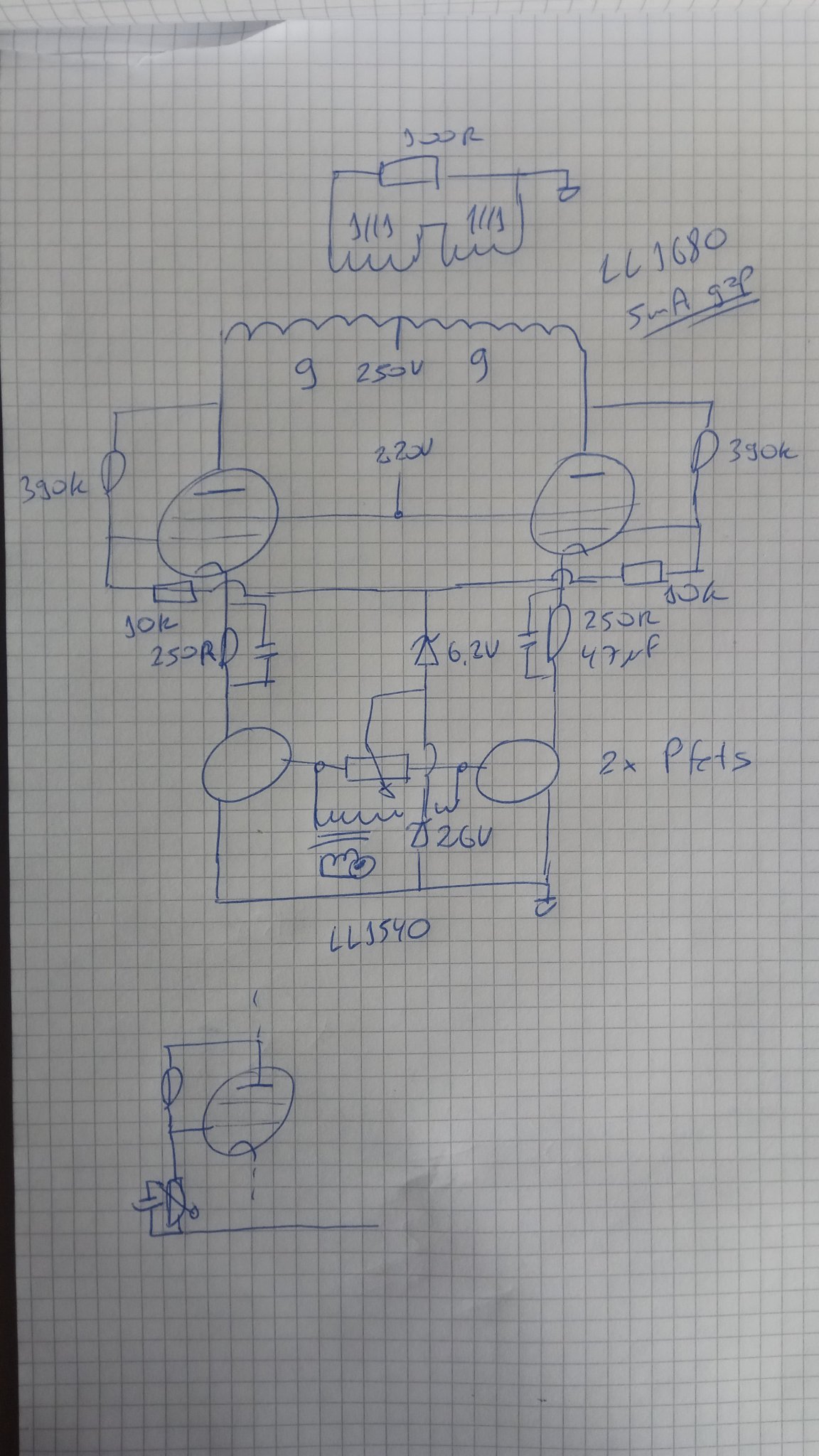

Eventually I went for an UNSET @Tubelab_com concept as testbed for this amplifier. Contrary to George, I am currently happy with 0.5W of power 🙂, as a possible first application will be a headphone amp.
The OPT is a LL1680, gapped for 5mA, ratio is 9+9:1//1+1//1. Currently using a 100R load resistor, should actually be more like 150R, which is the impedance of my HD590 headphone. The input transformer is a LL1540 1:1 driven from my test soundcard. The tubes are 6E5P. The 250R resistors were chosen to get around 30mA through each tube.
Currently there is only one pot (100k) in there, the extremes go the PFet gates, the wiper to a bias point. And the concept works: when the wiper is in the middle, total THD is smallest, with 3rd higher than 2nd. Turning to either side the 2nd and 4th starts increasing fast, at certain position the 3rd goes down, overall THD is higher.
At the bottom of the picture you see what I still want to implement: replace one 10k resistor with a potentiometer, with a cap from wiper to ground. This is why I choose the UNSET as it allows to simply change the feedback amount around a single tube, as the "gain" of the tube is set per individual tube with two resistors. With the 10k bypassed, there is no feedback, so pentode, with the 10k non-bypassed, there is feedback. The idea is to eventually couple both pots, in one extreme both tubes get the same signal and feedback is applied (so two triodes in PP), at the other extreme only one tube gets (double) the signal, the other has no feedback and acts as a relatively good CCS.

As you have found, a cap and pot in series from G1 to ground will change the feedback ratio above a frequency determined by the cap value. The action at DC remains the same.
Operating the control grid at a fixed low impedance DC voltage source while driving the cathode with a mosfet follower or low DCR transformer winding will result in pentode like curves for the tube / mosfet combination. Operating the control grid with a resistive divider from plate to ground will result in triode like curves whose shape can be controlled by the ratio of the feedback resistors.
It is possible to make a tube / mosfet combo with a variable adjustment from pentode to triode operation in this manner. As with their all tube counterparts the pentode mode will have more overall gain than the triode mode in the same circuit.

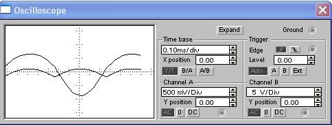

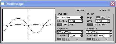

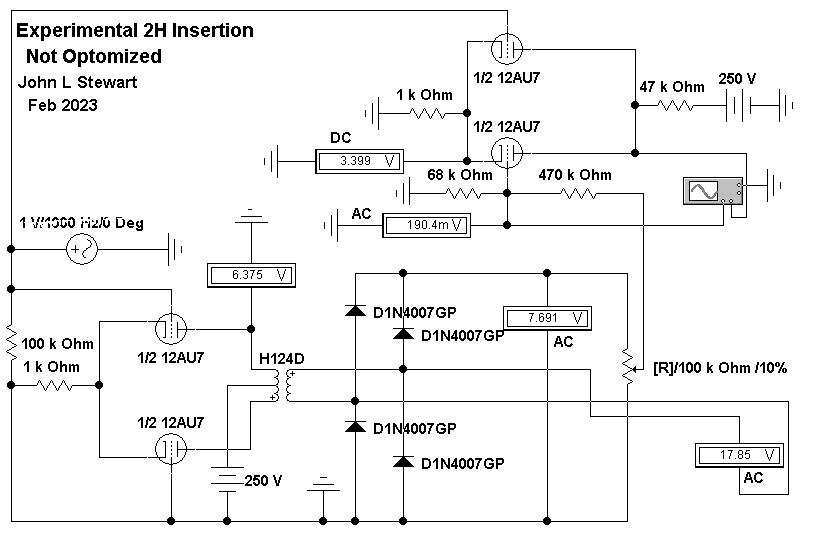

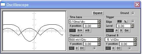

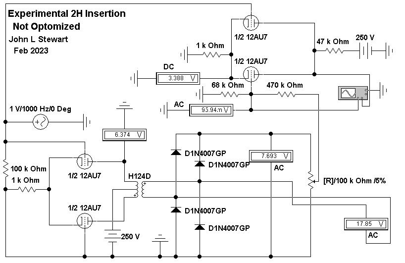

Here is the bones of a circuit I posted here on DIY a year ago. It makes it own odd order harmonics by a separate channel.
These are added in whatever degree the user would like. Something to think about.
Or not.🙂
