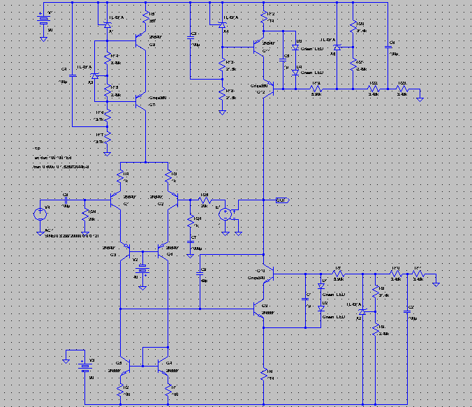

I've got some results of Hawksford cascode vs. Baxandall super pair for the VAS of the Lin topology. I'll just summarize what I got for the second and third harmonic for each configuration. Output signal was 20 kHz, 69.28 Volts peak, corresponding to 300 W into 8 Ohms.
Note that this is a low-feedback design, with very large emitter degeneration resistors in the diff amp (1k). Before you complain about the 1k resistors and tell me it's not a real world design, go look at the schematic of the LM3875 gainclone chip 😉 .
I've posted the LTSpice files so you can duplicate the results if you're interested in doing so. They use a nifty TL431A behavioral model from analogspiceman of the Yahoo LTSpice user's group. This fixed all the convergence problems I was having with the TI-provided model.
Hawksford cascode:
2nd harmonic = -91.8 dBc
3rd harmonic = -106.2 dBc
2nd harmonic = -90.2 dBc
3rd harmonic = -95.7 dBc
As you can see, the second harmonics are about the same with the two configurations. But the third harmonic is about 10 dB better with the Hawksford cascode. This is certainly much less of a gap than what I saw with the complementary design (20 dB difference for the third harmonic).
Based on this data, I'd conclude that the Hawksford cascode is a better solution - at least for this configuration of amplifier with +/- 90 V rails, 2N5401/5551 for small-signal devices and MJE340/350 for the final stage of the VAS.
Also, if anybody knows how to get rid of the phase inversion when clipping on the negative half-cycle of this design, I'd appreciate hearing about how to do it. I'm about ready to toss it into the trash bin in favor of the complementary design for this reason.

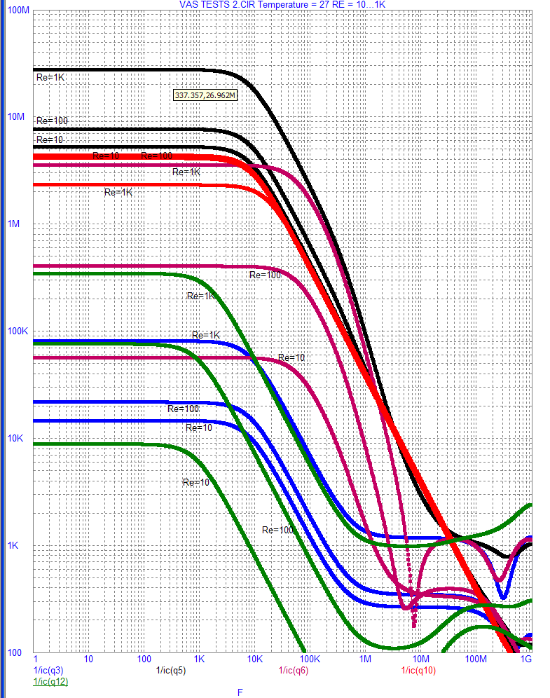

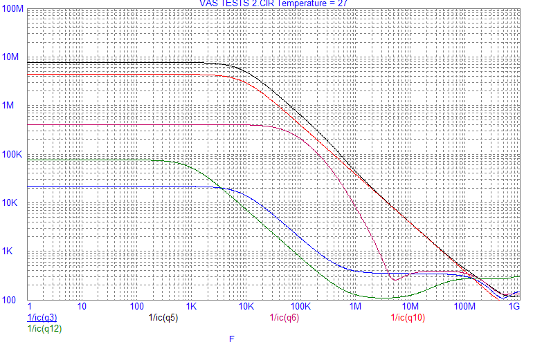

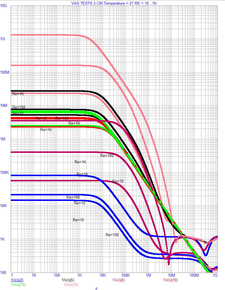

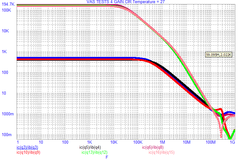

VAS Sims
Hello,
I just made a few simulations. Here is the circuit :
All the VAS stages ate fed a constant current from a constant impedance, which is the measured impedance of an input diff stage + current mirror, ie. about 70k.
These current sources are simulated by a constant voltage source in series with the source impedance (70k)
All the .define's below are here to calculate the right parameters for all the stages so they are all biased to 10mA no matter what emitter degeneration resistor we use. This works.
Thus we can study them open-loop. I took the problem in reverse order, put a voltage source on the collector and am varying collector voltage and looking at variations of VAS's Ic to calculate VAS collector impedance. As my collectors swing 1 VRMS, collector impedance is thus 1/delta Ic. Does everybody agree with that ?
Now for the results.
Q3 (blue) = classic single transistor VAS
Q5 (black) = Hawksford Cascode
Q6 (purple) = Baxandall Super Pair
Q10 (red) = Normal Cascode
Q12 (green) = CFP

Hello,
Q12 (green) = CFP
From what we see here, if highest colelctor impedance is desirable, Hawksford and the normal cascode look good, the others do not look so good...
Interpretation
Yes, I pushed frequency to 1G even though it's rather meaningless, so we see better how the CFP wants to oscillate, for instance. These closely coupled transistors are touchy to get right.
On for the results. We are looking for the highest collector impedance, because this means less parasitic currents running through non-linear capacitances. A distortion analysis would be useful, but this AC analysis is a lot easier to do and gives a starting point for a better understanding of how these things work.
Black :
Hawksford cascode has the highest impedance, and it increases with Re (what's interesting is that the corner frequency does not look like it's moving). This is because this Hawksford Cascode needs a Re to work ! And the increase also depends on the source impedance : as the coupling cap transmits Ic variations as a voltage on the emitter of the lower transistor, the feedback will be stronger with a lower base resistor. Unfortunately we have a current source feeding this so high impedance can't be avoided.
Red :
Normal Cascode has the reverse effect : its imedance decreases as Re increases, but it still looks good.
Purple :
This one really needs a Re to work. Looks like collector impedance is proportional to Re. With Re=1K it is as good as the normal cascode but its flat impedance goes higher. However the rolloff is sharper and there is a hint of instability.
Green :
CFP does not look good.
Blue :
Normal transistor
Re matters, so I guess I was saying ******** in my previous message. Sorry for that. However, even with Re, collector impedance is rather very low compared to the others.
So if the objective is to have a high collector impedance (hene high OL gain) to be able to linearize it with a Miller cap local feedback, these solutions look good :

Ready to rumble
The new performers are :
Bright Green : Cascoded Baxandall
does not perform any better than normal Baxandall.
Pink : Hawksford + Baxandall
Gets into unbelievably high collector impedances. This is meaningless now, as PCB, air, and compensation cap leakage will probably swamp this (with what linearity ?).
Still, this is interesting. And what's more interesting is that it does not need a high Re to perform. And high Re are annoying, because voltage across Re is varying with the VAS current, introducing uncertainties in our perfect simulated world...
Current Gain
Plotting the current gain (Ic/Ib) at constant collector voltage, we see the one-transistor VAS'es are all equal (beta = about 500) whereas the two-transistor VAS'es all stick to beta squared.
No surprises...
As it is very difficult to simulate the transimpedance as d(Vc)/d(Ib), we have to use our brains to relate these results to the prevous ones, and conclude that the Hawksford+Baxandall combo looks like the best (highest gain + highest impedance = highest overall transimpedance).
No surprises...
