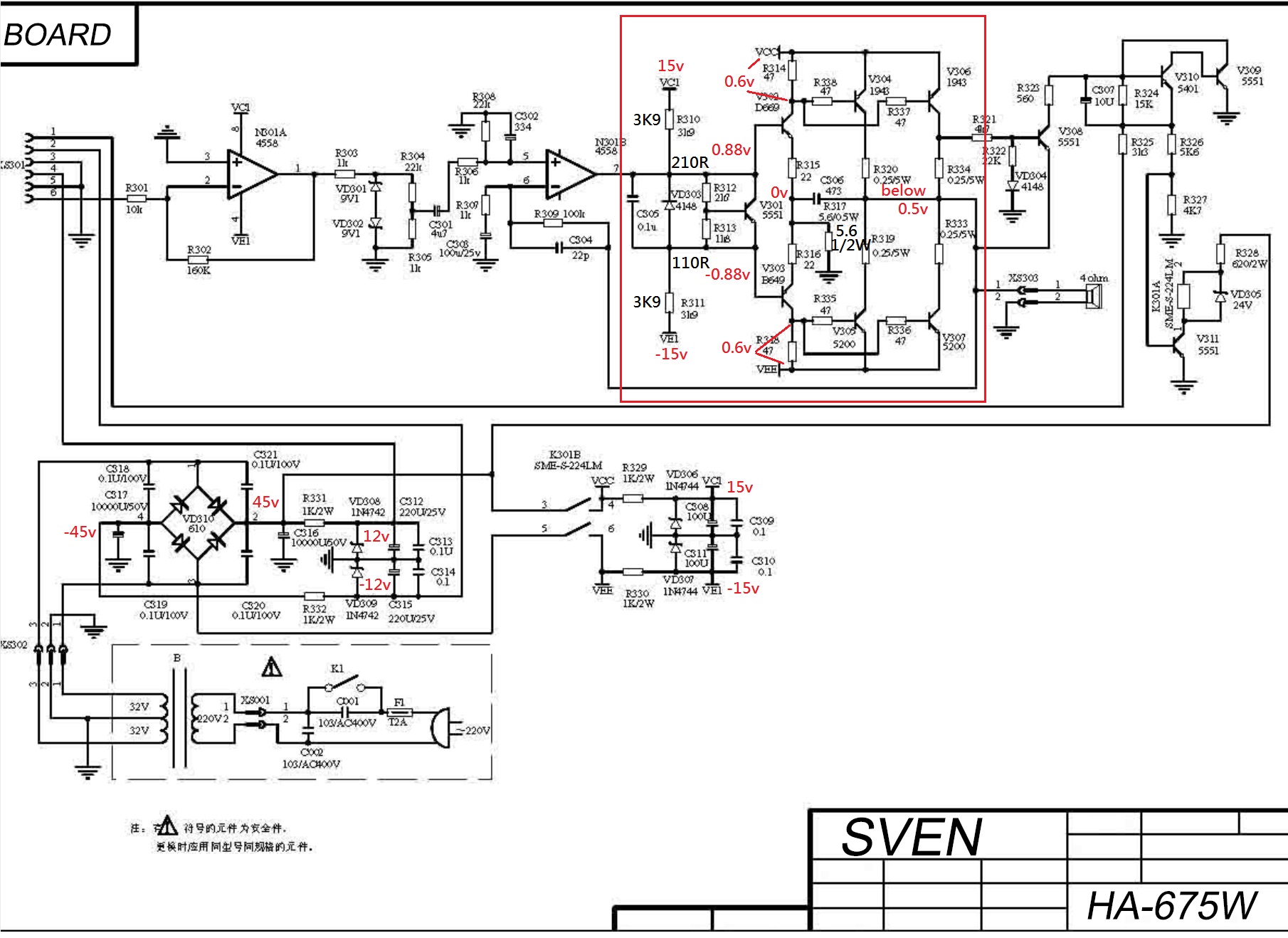

This repair Sven Ha680w subwoofer is same to your model
Ремонт сабвуфера SVEN HA680W. Часть I. Усилитель
Circuit diagram
http://zakatayrukava.ru/files/SVEN-HA680W-shema/ha-675-input-board.pdf
http://zakatayrukava.ru/files/SVEN-HA680W-shema/ha-675-amp-board.pdf
I attach the power amp section normal operating voltage for reference.
You should check all the supply voltage, for the power amp section check all resistor and transistors ok or not
