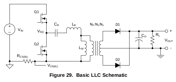

http://www.ti.com/lit/ds/slusc18a/slusc18a.pdf
The location of the sense resistor is perfectly valid given it is the upper switch that sets the input current to the bridge. The lower switch effectively just free wheels that current.
Of course if your supply has placed that resistor in the wrong place, source of the lower switch, then it is measuring free wheeling current and whilst still feasible would be sub-optimal.
