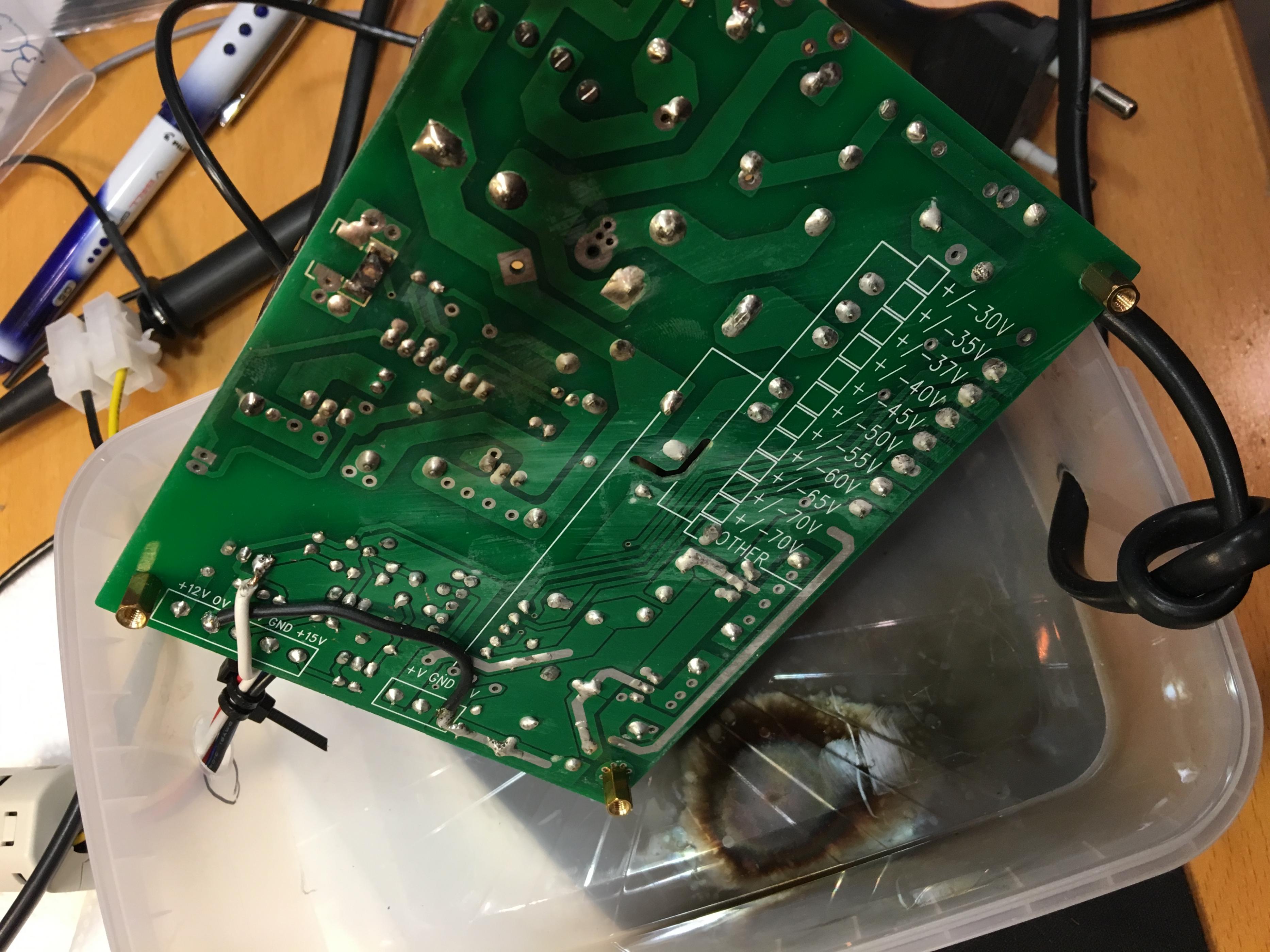

Yes at least the FETs and maybe also the driver ... not easy to fix if so as it is molded into a plastic "box".You have probably blown the mosfets on the SMPS.
Possibly the driver too.
You could try getting a replacement and just say it broke on its own ?
I think I just have to purchase a new as it was obviously my own fault .... had reversed a power diode on the amp board!! from Vss/-V to an internal -5V ... shooting through to GND .... must have been tired when mounting the components 🙄
The other chanel built at the same time works like a charm 🙂
So rebuliding the burned amp right now.
... and this time testing on a much lower voltage with PTC fuses on the supply lines 😉

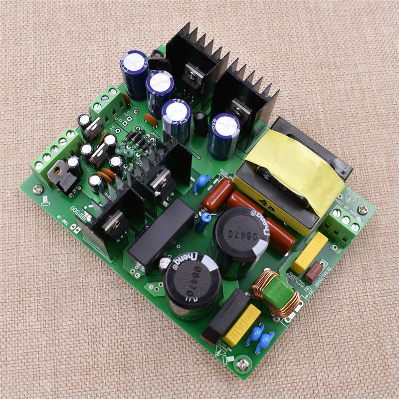

Look at the silkscreen, then put some effort in by overlaying it with an SMPS1200 its 1:1 identical. Also the recommend SMPS for the Ncore would obviously be an SMPS800 or 1200 as the designer recommend, the logic protection board from the NCORE that drives the protection scheme for OV, OC and OT interfaces with THAT SMPS.
Hmmm ok Reactance you are probably right, sorry .... but I didn't start this thread to either bash Hypex, you or anyone else .... Just wanted information on my bown SMPS and maybe find some good cheap alternatives 😉

Hi
I did some degooping on the "black secret module" soldered, with some sharp blade and hot air it was pretty easy.
you can see pictures here : SMPS - Google Drive
unfortunately secrets remain secrets as soic8 IC were sanded...
I tried degooping because that module is the hottest part of the entire board, perhaps it will helps a bit.

I use one +/- 40v with an ljm mx50SE amp for a few days and I had to say that ultra cheap Smps works as expected.
Amp is for now in a cardboard box and is really quiet, not any noise in my 93db speakers.
