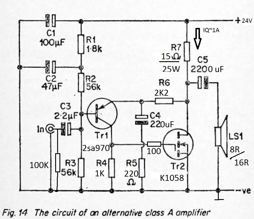

Class A means that the output device, whatever kind it may be, is running constant current all the time.
Can you give an example for an amp where the active device is running at constant current?
What is this amplifier?
Is it Single End or Push Pull?
It is obviously PP, a strange question coming from you. Another way to create a PP amp is to bridge two SE amps.
This is simple Single-End A-class amp under my development , very similar two stage A-class amp is already done by one famous Russian designer , it is energy very inefficient but with his HQ sonics outperforms some high quality 3W 2A3 SET tube amp.
