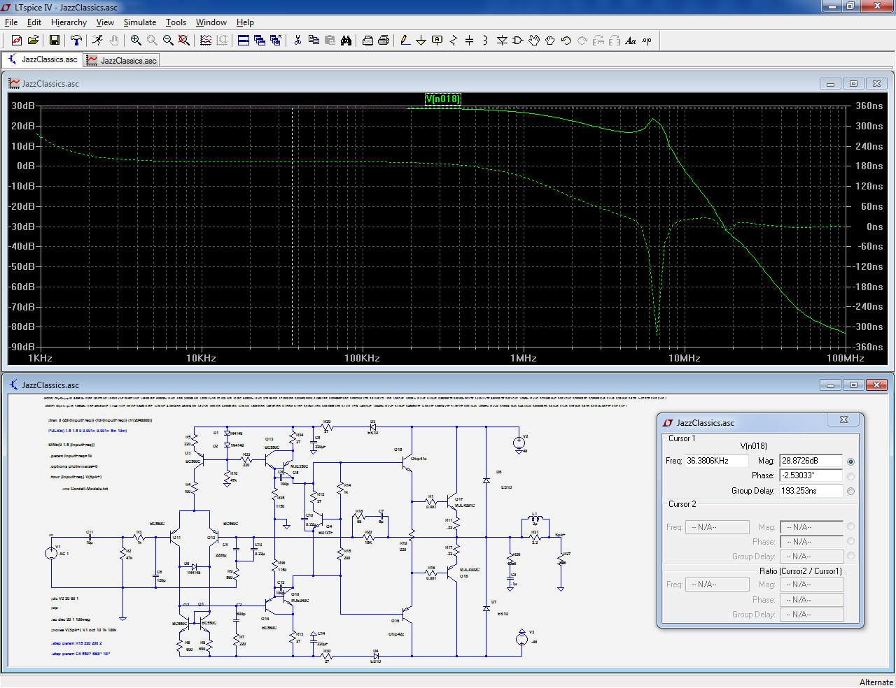

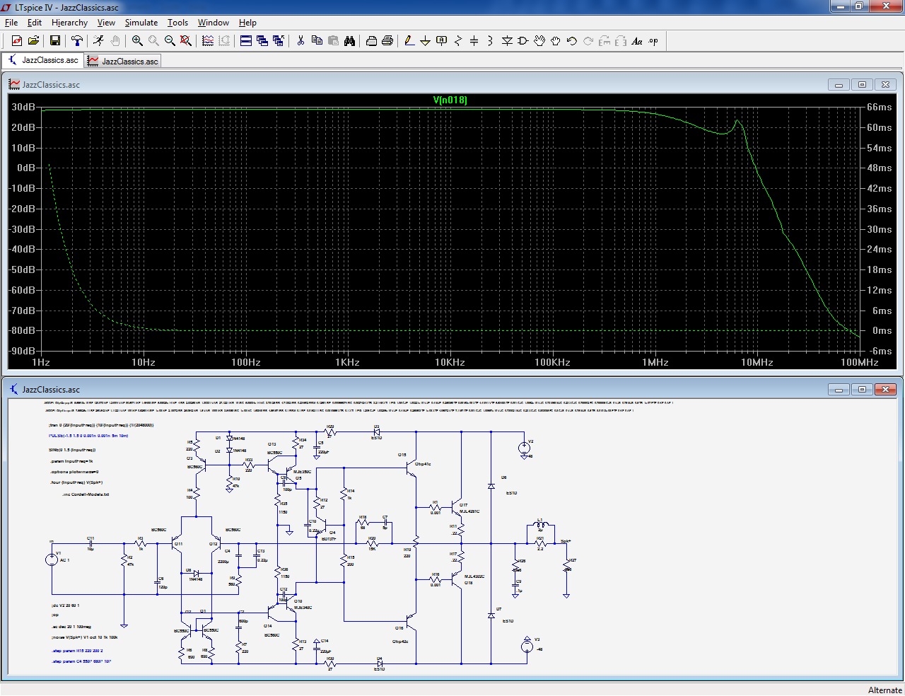

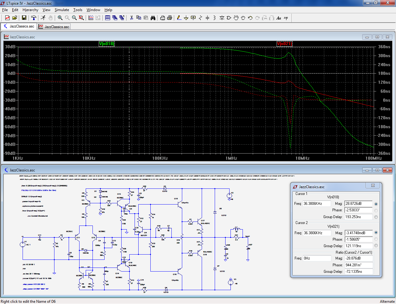

The parameter linking the two is called group delay, but there are some caveats: it has to do with cutoff frequencies, etc.So do you call that propagation delay or phase delay?? Where I come from it is propagation delay, which is different from phase delay as timing constants and cutoff frequencies have nothing to do with it.
In addition, it isn't flat with frequency, unlike an ideal transmission line.
Here is an example with a real amplifier:
At low frequencies, there is a large increase due to the time constants, and it looks like ~zero at higher frequencies.
It isn't in fact: it becomes much smaller and more constant, but not perfectly constant, and at the top of the bandwidth there are once again serious variations.
Note that most of the ~190ns delay are caused by the input filter: 120ns.
But do not confuse this with an actual time delay: such a first order filter reacts instantly to a stimulus, it is simply the amplitude that is affected
