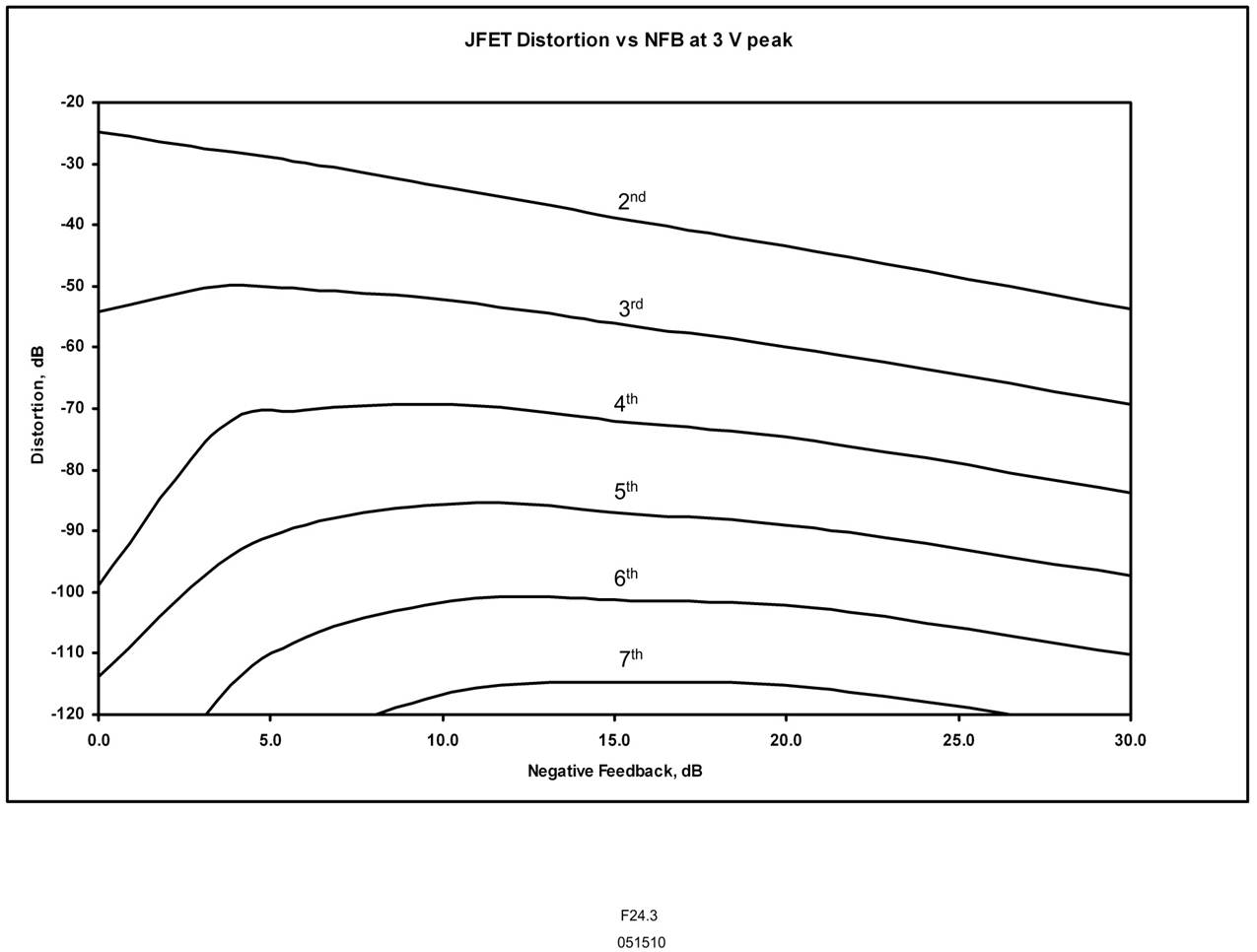

To illustrate Atmasphere's point: the attached is a single JFET stage.
Just for illustration - this is the famous Peter Baxandall graph everybody gets so excited about.
On the vertical scale is the distortion of that stage for several harmonics. On the horizontal scale is the feedback factor.
For instance, on the left side, where the feedback is zero, the 2nd is at -25dB (a bit over 5%), the 3rd is at -55dB (about 0.05%), the 4th at -98dB etc.
The interesting bit is that when you increase feedback (go from the left bottom corner to the right) you see that the 2nd and the 3rd decease as expected, but, surprise! the 4th INCREASES! Similarly for the higher harmonics.
So, aha! feedback increases higher harmonics!
Yes, IF you have low feedback. The graph also shows that if you make the feedback high enough, ALL harmonics eventually decrease.
Now remember, this is a simple single FET stage, very crooked transfer curve.
Got that?
To be continued.

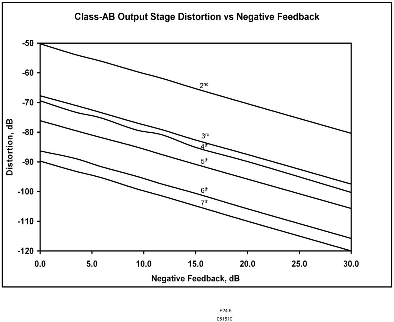

So now let us look at the same situation with a reasonably linear amplifier, not the single crummy JFET. See attached, courtesy Bob Cordell (read his book).
Aha! When we NOW increase feedback, ALL harmonics decrease, no new ones emerge from the noise!
This my friends is the situation with a reasonable linear audio power amp. The point with the simple, no feedback (global) SET (tube) amps is that they have NOT ENOUGH feedback - they are like that JFET. That gives you coloration and 'emotion' that some like, and that's entirely their prerogative. And this also explains why some SET amps may start to sound worse when you aply feedback, unless you apply A LOT.
And only if you have a severely poor quadratic transfer function to begin with. But you knew that...
Part 6, Figure 2 will be your next post, I predict.
