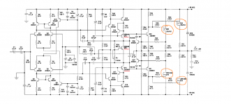

Now, am trying to build this amp. I think most of you are familiar with this amplifier or may not. Anyway. I've marked some driver transistor with RED color in the diagram. Question is, do these transistors require heatsink? Experts please clarify me on this area.
I've also marked the output mosfets with ORANGE color. Now the mosfets that have been used here are lateral ones. The place where I belong, it's very difficult to get lateral mosfets. So, one way ticket for me is to use vertical ones.
My second question is, if I really have to use vertical mosfets, are there any changes that I've to correct in this design?

Yes the driver chain is current limited at 120mA or so at the cascode, suggesting heatsinks are needed.
You can't replace laterals without adding thermal bias stabilization circuitry. The
transconductance of VFETs is different too, so compensation is likely to be affected. The gate thresholds are different too IIRC.
Careful. The doubled-up full-complementary push-pull LTP-VAS construction, with current mirrors at the load of the LTP, while looking good, lacks a determined and stable mechanism that decides the VAS standing current, other than the 120 mA limiter at the VAS collector circuit which is meant for protection instead. The VAS standing current is at the mercy of odds of randomness offered by the parameters of transistors being used.
This problem has been brought up many times in the forum. Many would ditch the current mirror for a simple resistive load. Bob Cordell has a good discussion in his book too where he offers a simple "patch-up" solution as well, by adding a shunt resistor across the current mirror to reduce the sensitivity of the VAS standing current to the "randomness". He traded for the VAS current stability with loss of the gain in the LTP stage.
I put that solution to test in my own Meistersinger amp project and it seems to have worked quite well. However in that project I used matched dual transistors for all the front end devices. I wouldn't know how well it would otherwise work in case if single transistors. The resistor value I used is 47K.

I'm afraid the only cure to that VAS standing current problem is a common mode feedback/control scheme that some of other member have proposed in the past and perhaps have tried/proven, which adds a considerably amount of complexity to the amp. Otherwise not much different from a "patch-up" solution like that of Cordell's, which dose effectively deal with the problem at little cost.
The hand-drawn schematic in #190 of Bryston-Clone thread probably would not work...the added pair of transistors common-based with the VAS transistors do nothing to equalized the VAS current between the NPN and PNP genders, as the common-based nodes are driven by the low impedance emitter followers ahead of them respectively, it makes no difference with or without the second pair of transistors after the VAS transistors.
You misunderstand the purpose of the extra transistors. The vas is one leg of a current mirror and the extra diode connected transistors are the other. The 2.7k resistor sets a 10mA standing current between the diode connected transistors and because the vas transistors are the other leg of the current mirrors then 10mA must flow between them too. I assure you that the prototype works as intended with very low distortion. This is exactly the same method of setting the vas current as used in the very successful Giovanni Stochino power amplifier - amongst several others.

You're right, chalky, I spoke too soon. I put your circuit in LTspice and saw the action in working....I keep forgetting the high impedance nature of LTP current mirror load nodes.
Would you think the 2.7K reference setting current needs some heavy filtering? Is noise from the power rails a concern?
I suspect the posted schematic.
If anything because it uses the stabilizing "ballast resistors" on the *DRAINS* of output MosFets ... where they stabilize nothing of course.
That alone shows designer has no clue, and rather than designed from ground up, this is just a copypaste collage or a"mod" bases on other designs.
