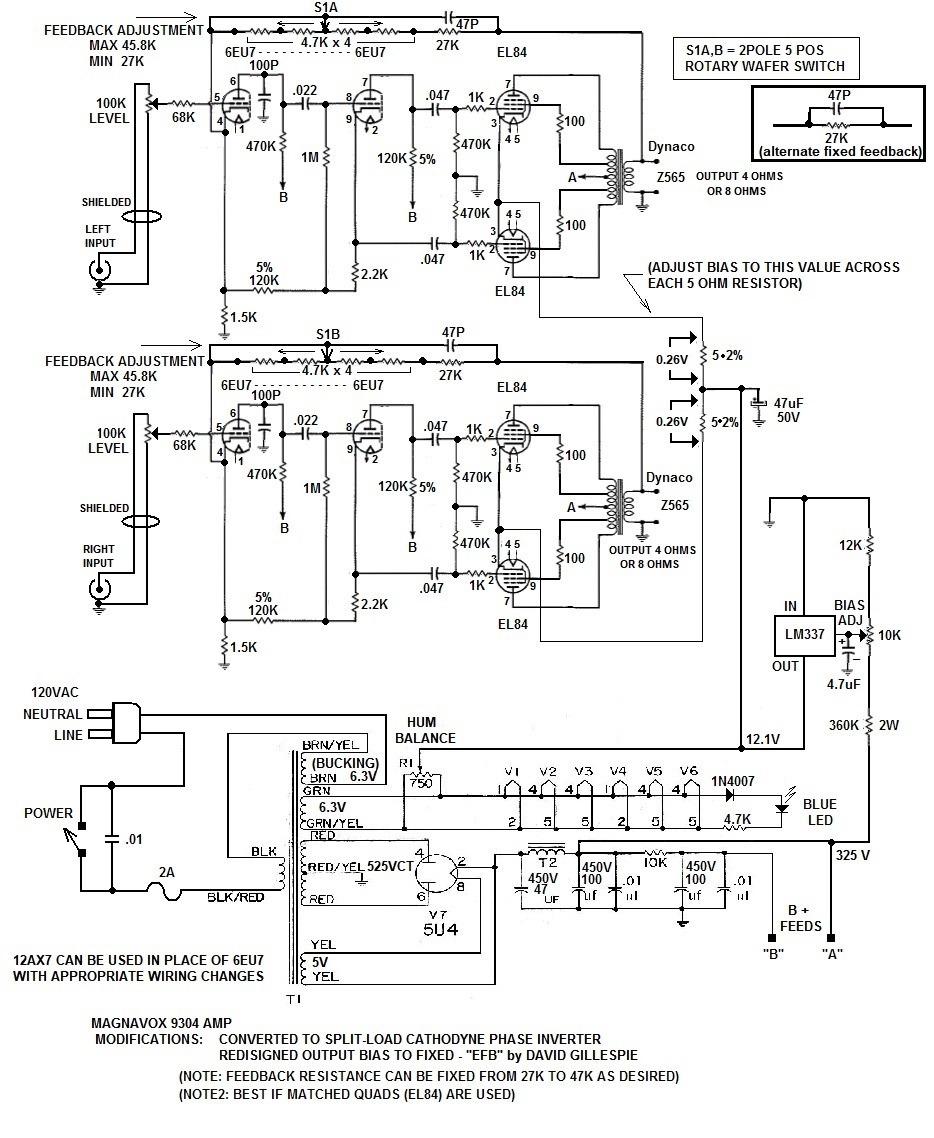

Thats a splendid starting point- It's hard to build a bad EL84 amp. I built the Audionote design and loved it- below...

I was just looking at this and at first glance, looks really similar, both dual mono blocks?
Would you please be willing to help with Audionote build?
Schematic I'm familiar with shown previous...

By the way, some of the text on the schematic isn't legible.

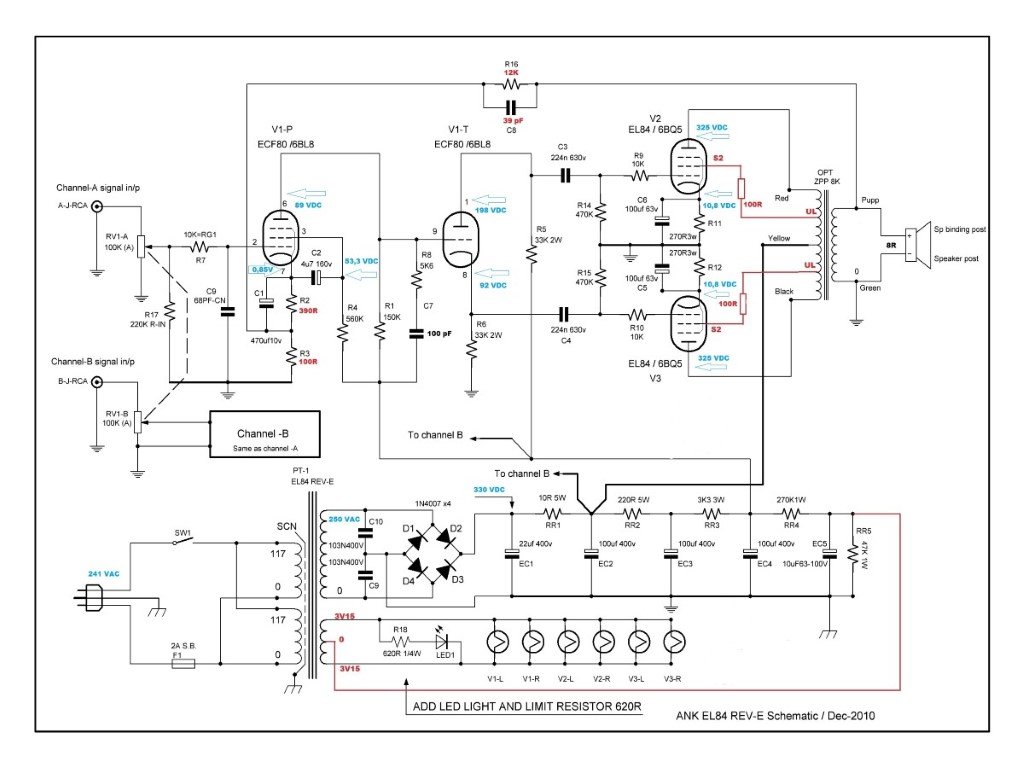

Since @oemcar offered assistance versus a recommendation, proceeding with the Audio Note L1 clone, which of course greatly appreciate (I know I am a dense and difficult personality, trying to correct that).

In this case, minimum heater amps is = (2*0,43amps)+(2*0,76amps)=2,38amps.
The trouble is the differences between the diagrams, one has voltages labeled and one does not. The one labeled has ECF80 plate voltages of 89VDC and 198VDC, neither the 170VDC specification. So which is correct? If the former, how many milliamps? Again, same for the EL-84, the biggest concern is the table of 325VDC, exceeding the specification of 300VDC. Which is correct and if the former, how do we adjust so as to get to the 300VDC and therefore known amperage?
Without this information, the parts can't be ordered and satisfy those desiring the build to proceed. ;)
