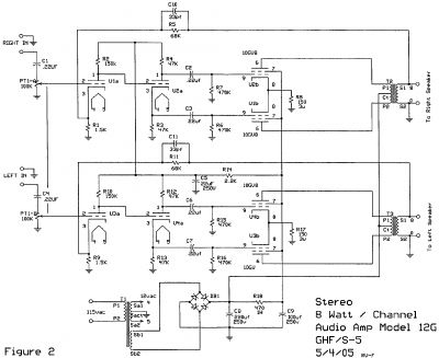

Thankfully the schematic still exists (just can't download): https://diyaudioprojects.com/Gallery/displayimage.php?pid=368. Per what I briefly read, it is well loved design. However, don't recall a mention of how many watts.
Right-click the image, "Save image as..."
Or https://diyaudioprojects.com/Gallery/albums/userpics/normal_S5-Electronics-K12G-Tube-Amp-Kit-Schematic~2.png
Yes, that small fuzzy copy seems to be all there is on that page.
Says 8 Watt / Channel on the drawing.
Reactions: 1 users

That isn't going to drive a 300 watt, let alone a 500 watt speaker, right?
Of course it will. 8W is not that much less than 500W. However if you want to buy a ready/kit 500 Watt tube amp, you will be disappointed. In ANY market. Is one of the Ampeg SVT amps still on the market at 300W all-tube? (Last I looked they were cheating with transistors.)
Reactions: 1 user
I can only go by what information on here and that was a 500 watt speaker needs 20 to 25 watts.
So then what is the correct minimum?
