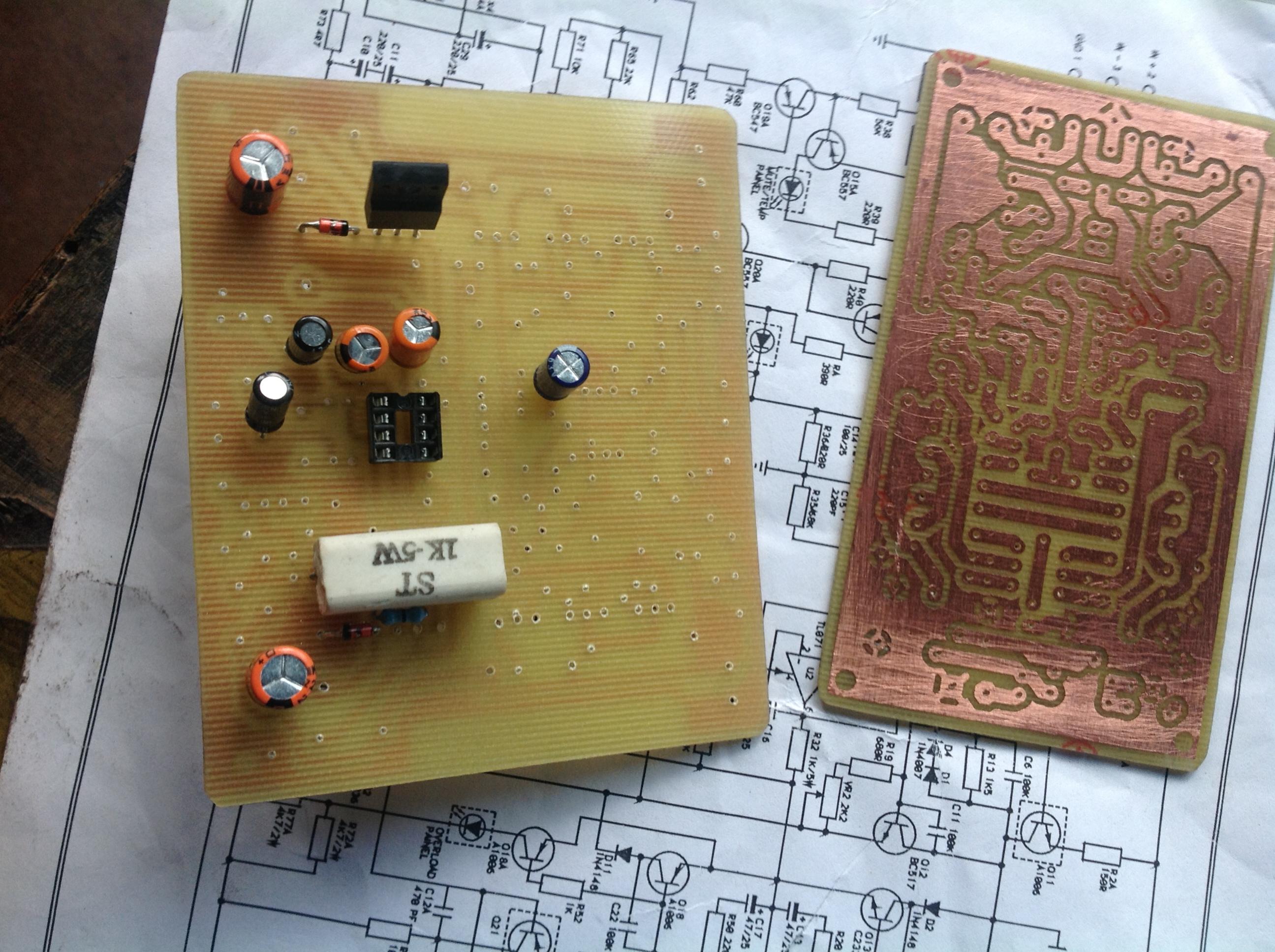

Hi renatoscp
greetings i am trying to finish it quickly managed to make pcb driver stage 8.0SBX just one doubt base resistance shown is 68 ohms is it 6.8 ohms😀
WARM REGARDS
andrew
Yes friend, the correct is 6.8 or 4.7 ohms which is even better. This error occurred because when I made the PCB, I used based on the initial regimen (before correction), and copied his values, see:
https://www.dropbox.com/s/9dox5y5ke1usubv/esquema inicial.pdf
I was correcting the layout, but for lack of time I ended up not doing it.
Follows the simulation file (multisim12):
https://www.dropbox.com/s/3uq8rilgc8s2hy1/Mod BX original.ms12
And here is a "supercharged" version with more power transistors (PCB do not have this):
https://www.dropbox.com/s/id9um3bdf5t2m6a/Mod BX12.ms12
