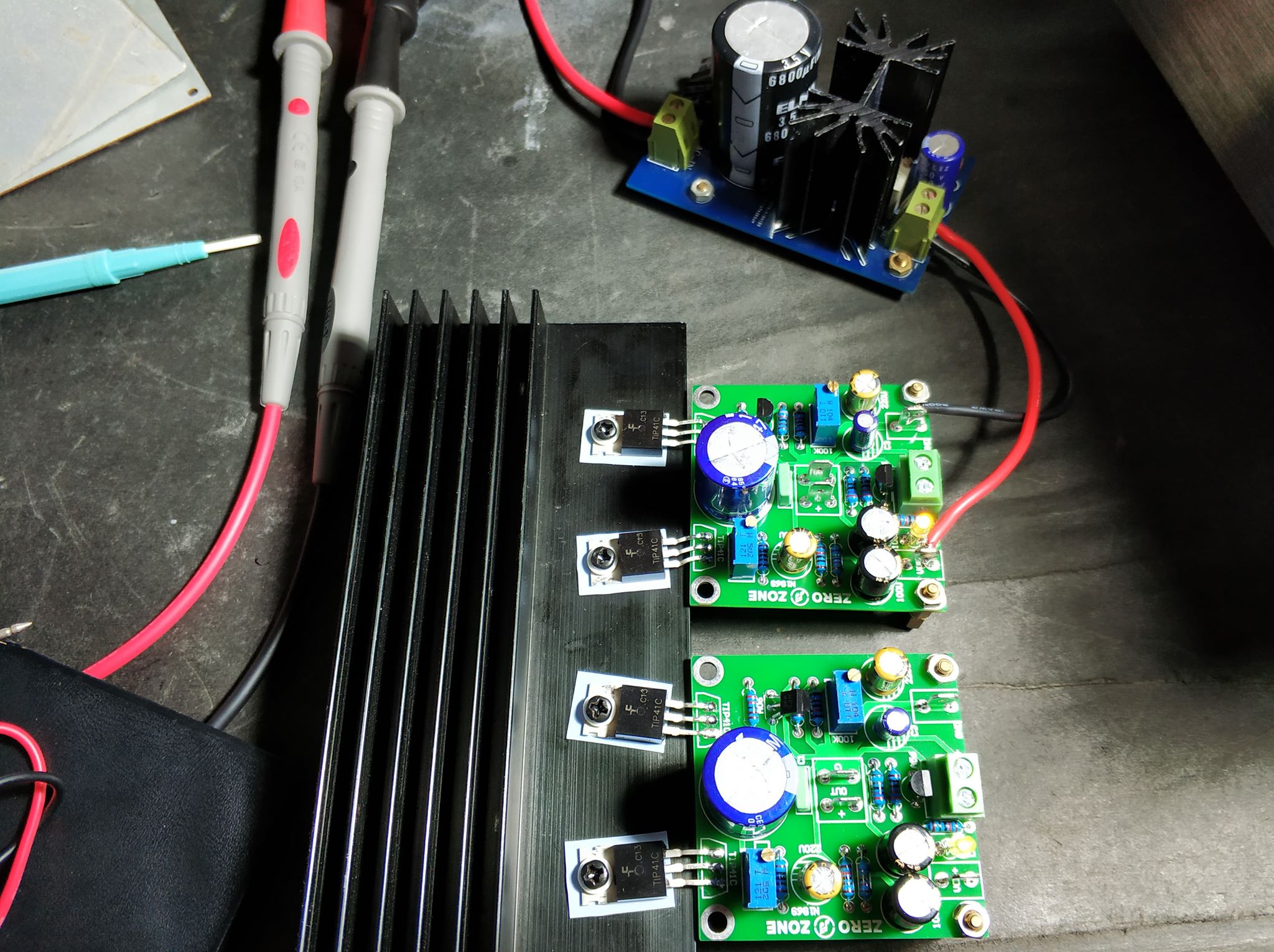

I am aware there is such a thread on the PASS subforum but I am not testing on a PASS amp just a simple 1969 with TIP41 transistors at a measely 500mA bias because the intention for this amp is a bit weird.
Reasoning behind trying multiple thermal interfaces :
1) I saw graphene pads in china so I figured I would find out if it's real
2) Silicon TIM pads and mica is actually quite crap.
3) Aluminium oxide (despite what it sounds like it's actually white) is pricier than both silicon and mica but I am about to find out if it's worth it for a Class A amp
Obviously, a Class A amp will benefit from any form of drop in case temperatures and more efficient case-heatsink thermal transfer.
Also, a similar package FET will have better thermal transfer characteristics than a BJT. Sounds odd, given that both have the same packages but a planar fet is constructed differently from a epitaxial BJT (that would be used most of all in a audio amplifier). Or at least, i know parts like the 2SC5200 has a thermal transfer from die to heatsink of 0.833C/W and a FET like the FQA19N60 is 0.42C/W+0.24C/W and it's not the full fat TO-247 package like the 2SC5200.
I know, it's not a equal comparison but I believe FETs are the way forward. Oh and 2SC5200s are still being made.
Test conditions : 30c ambient... yeah.. Singapore's an alarmingly hot country.

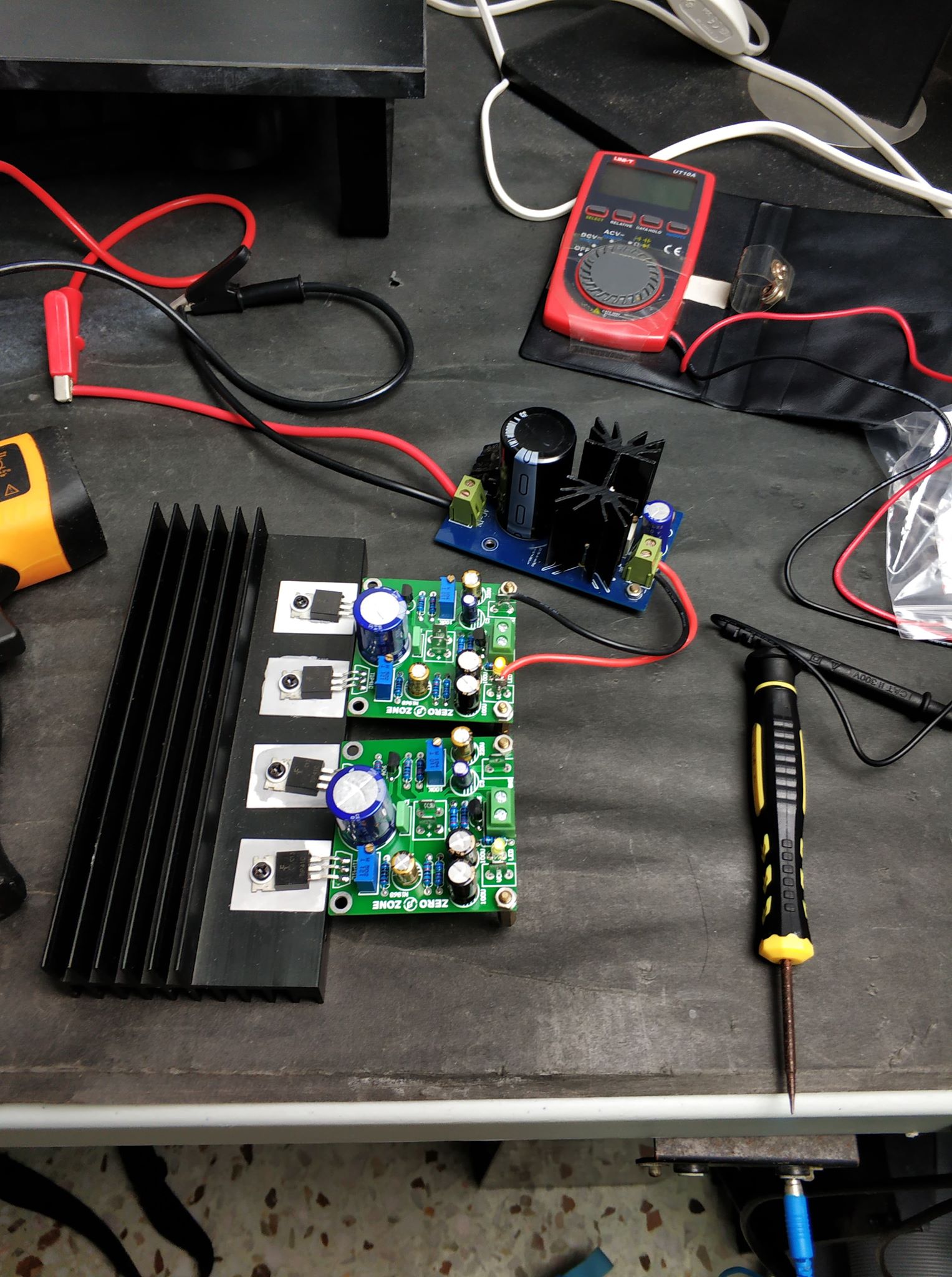

Equipment used :
30V 5A bench supply (I take current readings from the bench supply)
Keysight U1273AX for transistor case temp monitoring (Screen's shot, so I have to use the Bluetooth device to monitor using my phone)
UNI-T UT10A just to measure input voltage from the LT1083
Random dual channel thermometer for taking differential from heatsink to top of case. It was very difficult to keep it attached to the case so the numbers in the photo is not to believed
Obviously, anyone who knows anything about the JLH1969 is that the bias goes up or down as the temperature varies and that's also why they blow up when they overheat due to secondary runaway... It takes about half an hour, when the amp was cold it was 0.42A... 30mins later it was 0.63A when I tried to aim for 0.5A bias
I try to maintain 0.4A with all thermal interfaces because that's what I first build the board in this form. And the heatsink stays the same and I also leave the 2nd amp attached but not in operation.

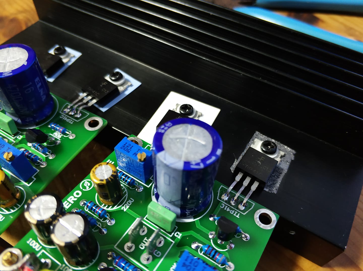

Graphene first up
The graphene sheet actually looks pretty weird. there were no documentations so I guessed that that you only needed to peel one layer off and rejoiced that it was actually non conductive! But I was wrong and had to peel off both layers of protective cover so I left the other thermal material on for the 2nd transistor in case I shorted them out.
Results were already positive, 56c was with silicon pads with a bit of TIM (yes you need that on silicon pads) vs 37c on the graphene
with silicon pads I had 14c temperature differential between the case and the heatsink whereas the graphene I have 2c between them.
The reason for the temperature differential is the extra thermal resistance between the transistor's case and the heatsink that is the insulating silicon pad.
The graphene was genuinely sticky but it was also electrically conductive. So no, you can't use it as a insulating pad...
Oh well.
Using no thermal paste on the silicon pads actually was really bad. 20c temperature differential... Do yourself a favor and use some thermal paste on them.
Moving to aluminium (yes it's written with two i(s) if any yanks are reading this) oxide thermal paste is NEEDED. don't assume it doesn't. and my suggestion is to use decent thermal paste that isn't conductive and certainly not garbage like Arctic Silver 5 or the big tubs of thermal paste that come from china with a crappy spreader with an amazing price.
The case temperature differential is a bit higher this time round, at
5-6c above the heatsink but heatsink still stays cool at 42c.
The amp board is just dissipating 10.5W but that is still a remarkable improvement.
Lessons to take away :
1)If you are using a TO3P package please cover the whole insulating pad with thermal paste but don't overdo it because TO3P doesn't have uniform pressure across the device
2)If you are simply testing or build a cheap amp, silicon is fine (LM3886 amps don't count... they're plastic cases but they still need thermal paste)
Traditional logic that soft thermal pads don't need thermal paste are kinda just fluff. My silicon thermal pads weren't cheap and performed like garbage without thermal paste.
3) A lower case temperature means a smaller heatsink required! But better to keep the same heatsink
4) Graphene is very conductive... I should have known
5) The more power you put into an amp, the more the temperature differential starts to slide so it will be even more crucial in say... A F5 Turbo V2?
6) Get aluminium oxide pads. Not only do they work even better even though they're thicker than silicon pads but they also are way capable of withstanding way higher voltages.
