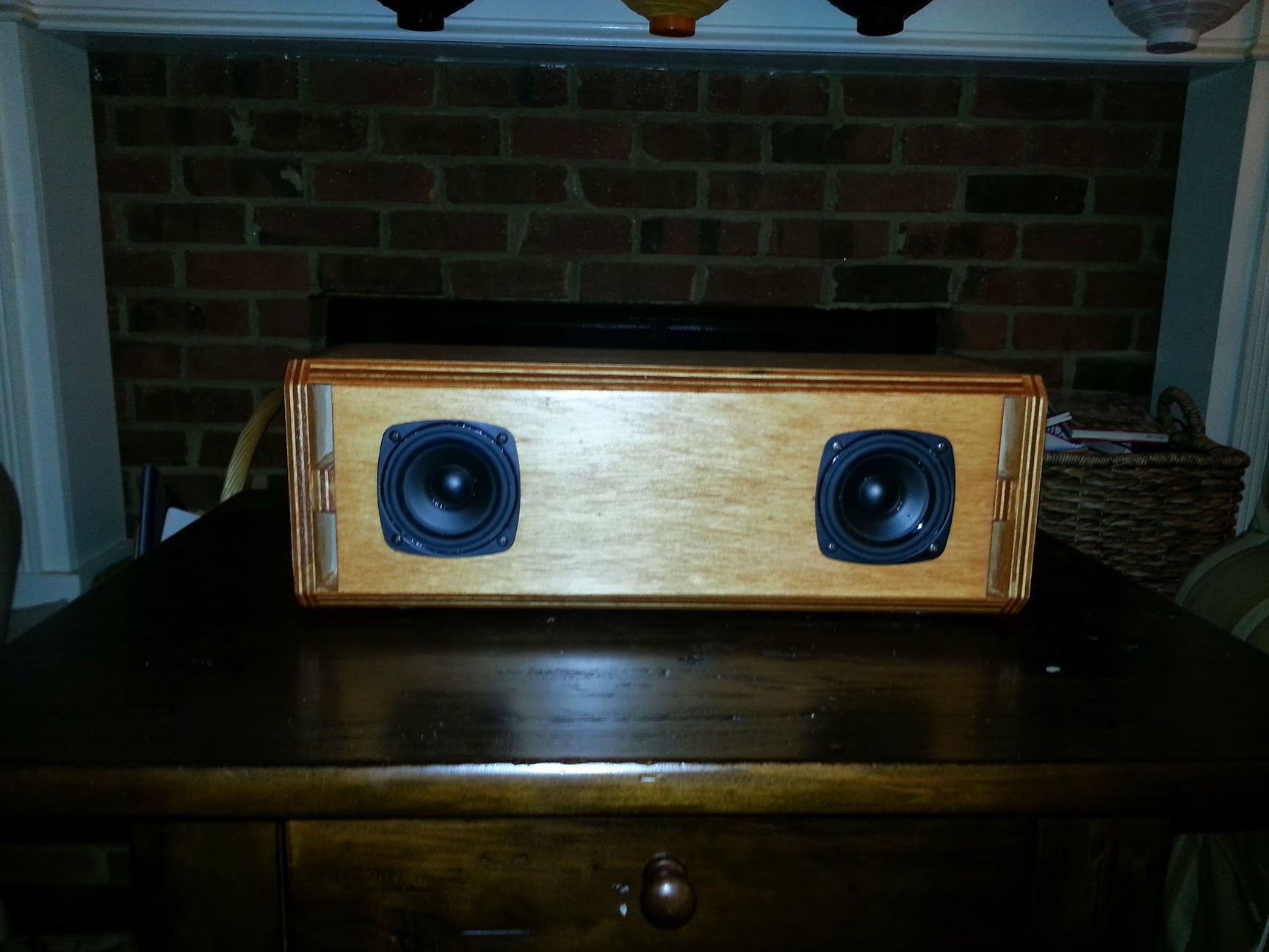

EBay tpa3116 amp and a sure audio bluetooth module and done...make an enclosure for added coolness.
I used a large square lead acid rechargeable battery and the cabinet is based on a planet 10 micro fonken. Drivers are cheap tang band full range drivers and it sounds great for what it is.
Sure Electronics AA-AB41136 Bluetooth 4.0 Audio Receiver Board aptX +EDR 12 VDC
Yuan-Jing TPA3116 Class D Amplifier Board 50W+50W
Did you used a lead acid 12V battery for amplifier and BT module? Doesn't have digital noise? Can you send more pictures, if possible?

Yes one of those square 12V lead acid rechargable batteries. Zero noise...since no charger is hooked up. I just take the batter out to charge it...the back is removable.
It is hooked up to both the amp and the BT module.
One charge can last for weeks with light use.
What amp is that? Is it a TPA3116?
