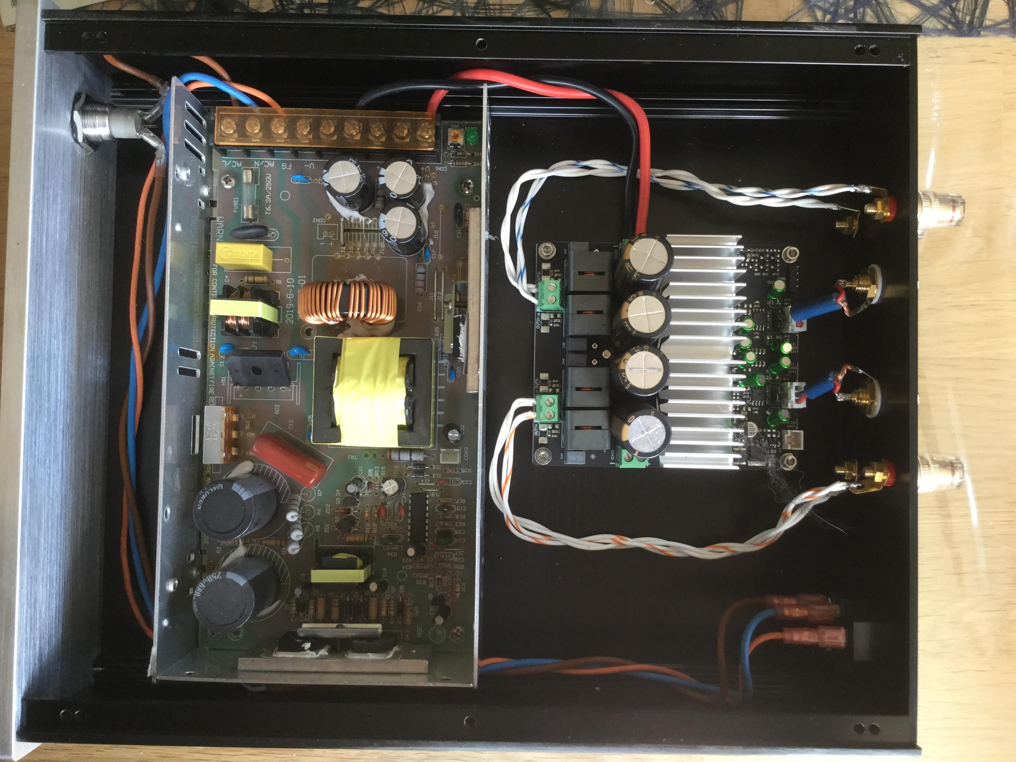

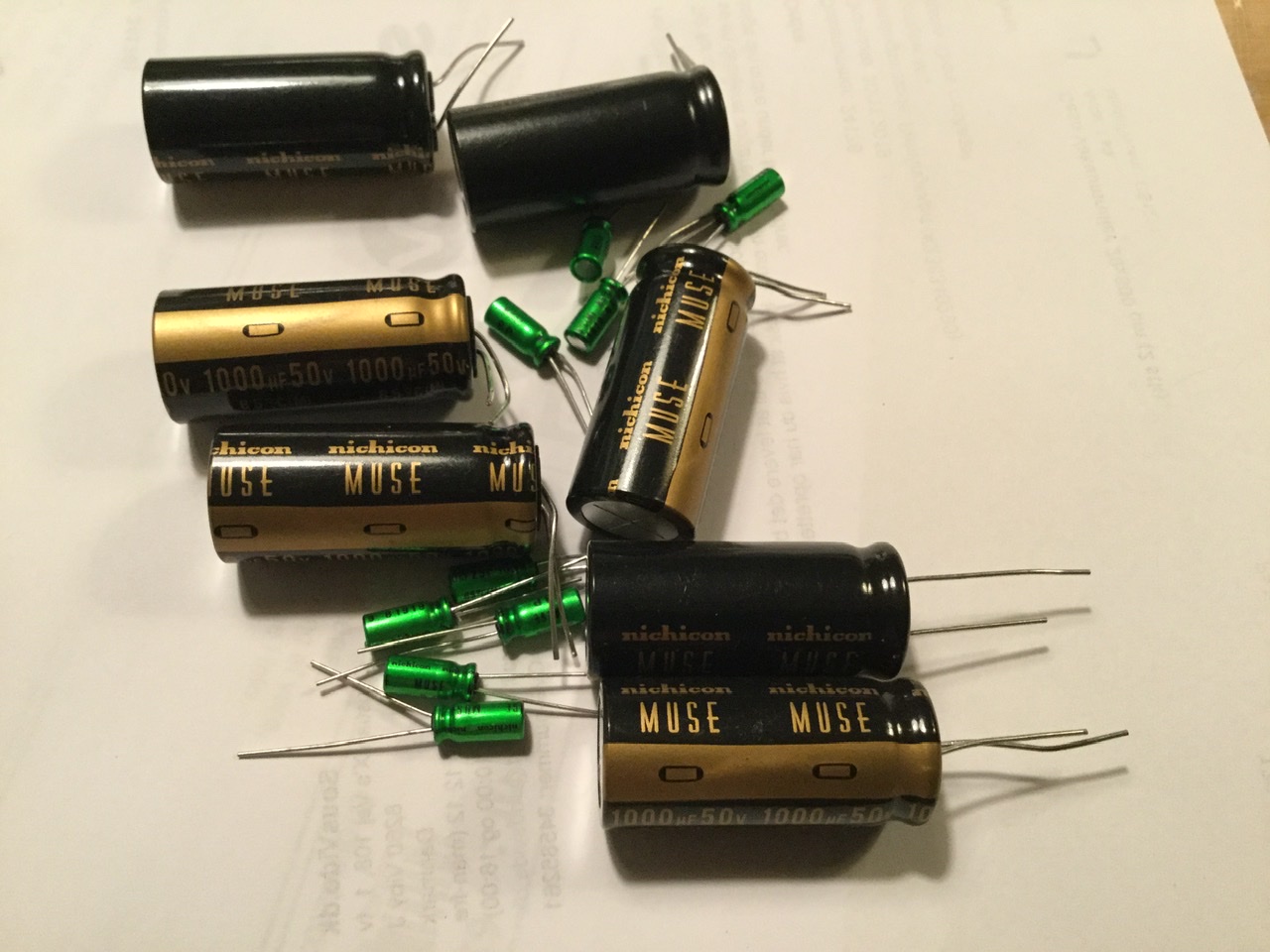

Just got new capacitors for the amplifier. So this weekend I’m planning on replacing all capacitors around the op amps. Also the four big capacitors are going to be replaced.

Bought Nichicon capacitors.
Going to replace the eight capacitors sitting before and after the op amps and also the four big ones.
Read about an American guy who replaced some of the capacitors in his SMPS, with apparently good results, so going to do that too.

The space for the four big capacitors are a bit limited, so they are a bit cramped.
The sound has definitely changed. Whether it is better or worse still remains to be determined. My hearing currently suffers from the change in weather, believe it or not. But I do suffer from tinnitus on both ears, and they are quite sensitive to changes in weather.
I will get back with a more thorough verdict when my hearing is better.
My wife though is not impressed with the changes......

So, got to listen a bit more serious.
Low end has become even deeper and more tight, not something I really need, was more than good enough for my needs before the mod.
Midrange and high end has improved slightly, with a bit more transparency, but not easy to hear, so very minor.
If I where to choose, I would leave the amplifier as it was built from the supplier, and if you need something with better sound quality, it needs more drastic modifications beyond my current skills, or else, go look for something else.
Still a very very good amplifier for the money (around €200,- complete build cost).
That's my humble opinion.

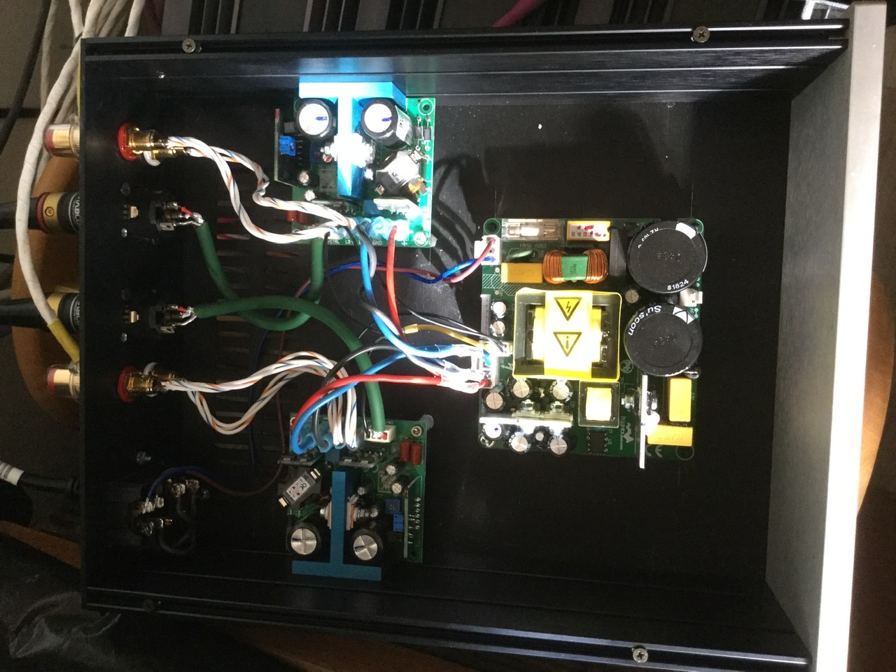

Finally got to finish my next build: a stereo ucd180 HG HxR with smps400 power supply.
Not as tidy as I would have liked it, but will be cleaned up when I change it to dual mono at some point. Used top quality components for connections and internal wiring.
And what can I say: First impression is absolutely amazing! Very neutral, with tons of headroom, very nice detailing throughout the whole frequency range. Still need to listen to more different music, but initial impression is very very promising.
Absolutely worth the money. This one is a keeper!
