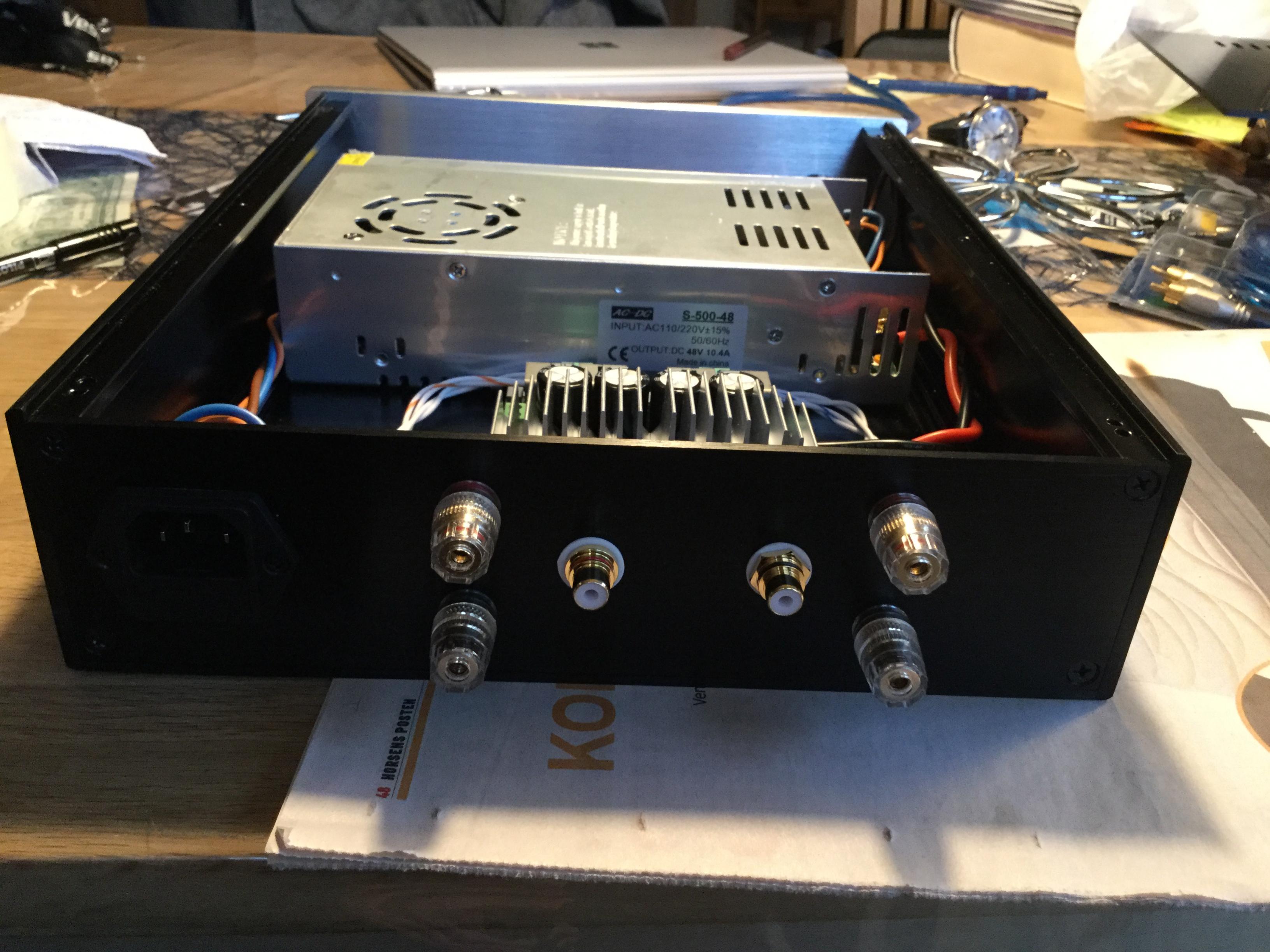

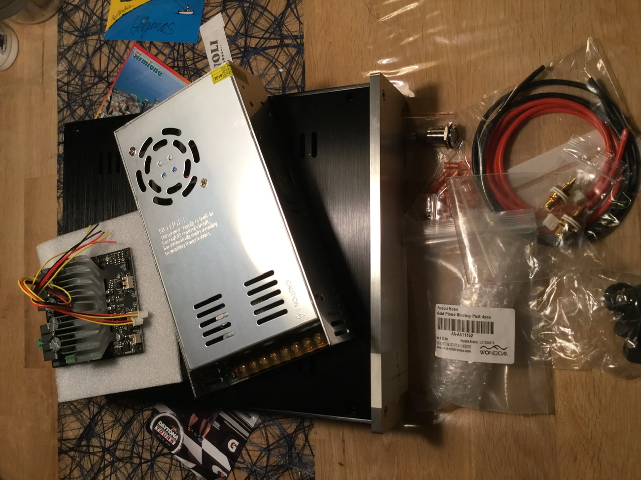

All parts finally arrived.
Time to drill some holes!
Or should I make a quick mock up to test that everything works? 🙄

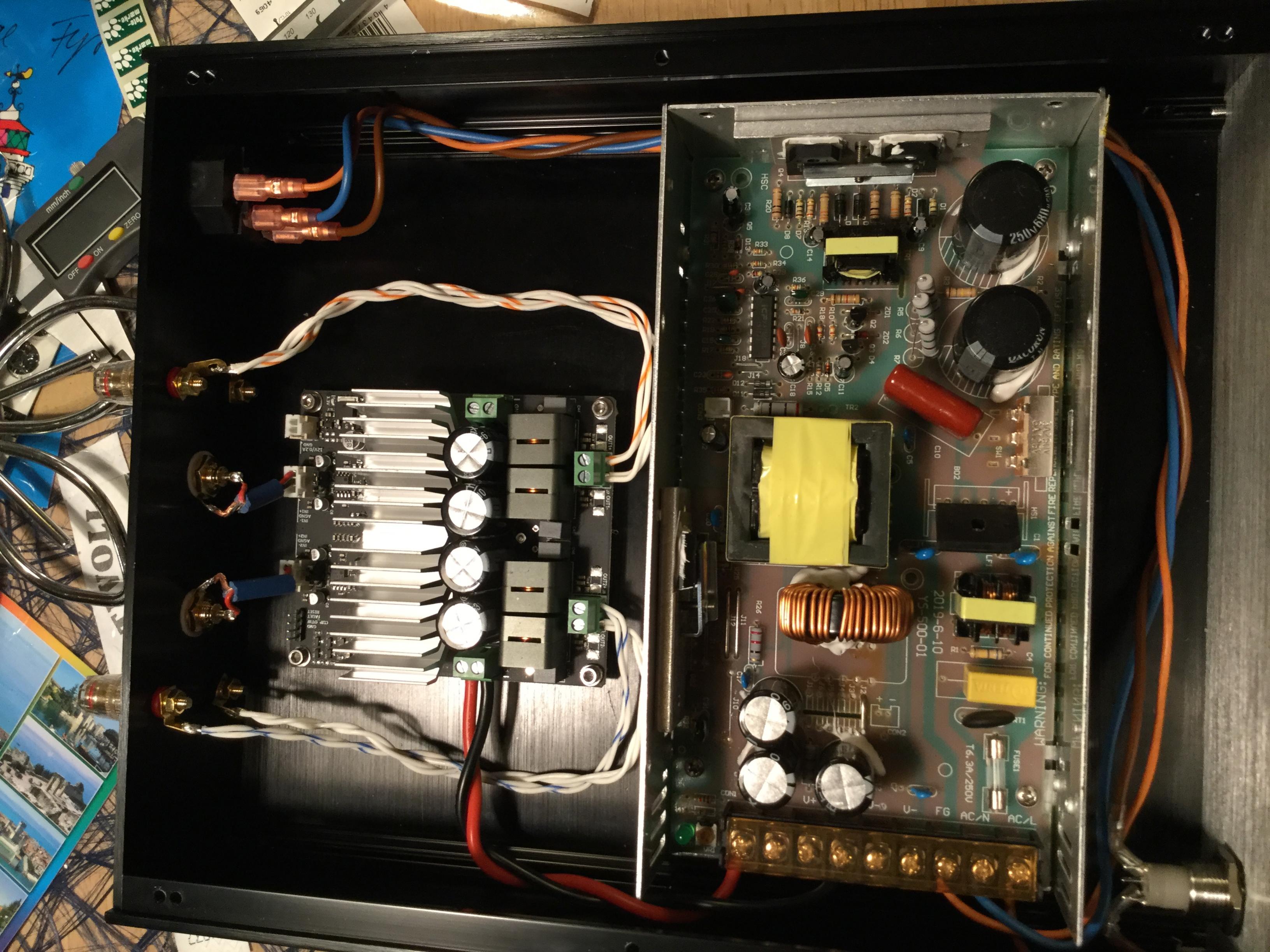

Got to test the amp with a set of speakers in the basement. And everything works, and plenty of power. No noise at all, except for the cooling fan for the power supply. Quite noisy, even though stated that it is temperature controlled. So took the lid off.
Going to hook it up to my stereo tomorrow. Going to be interesting to hear the sound quality.

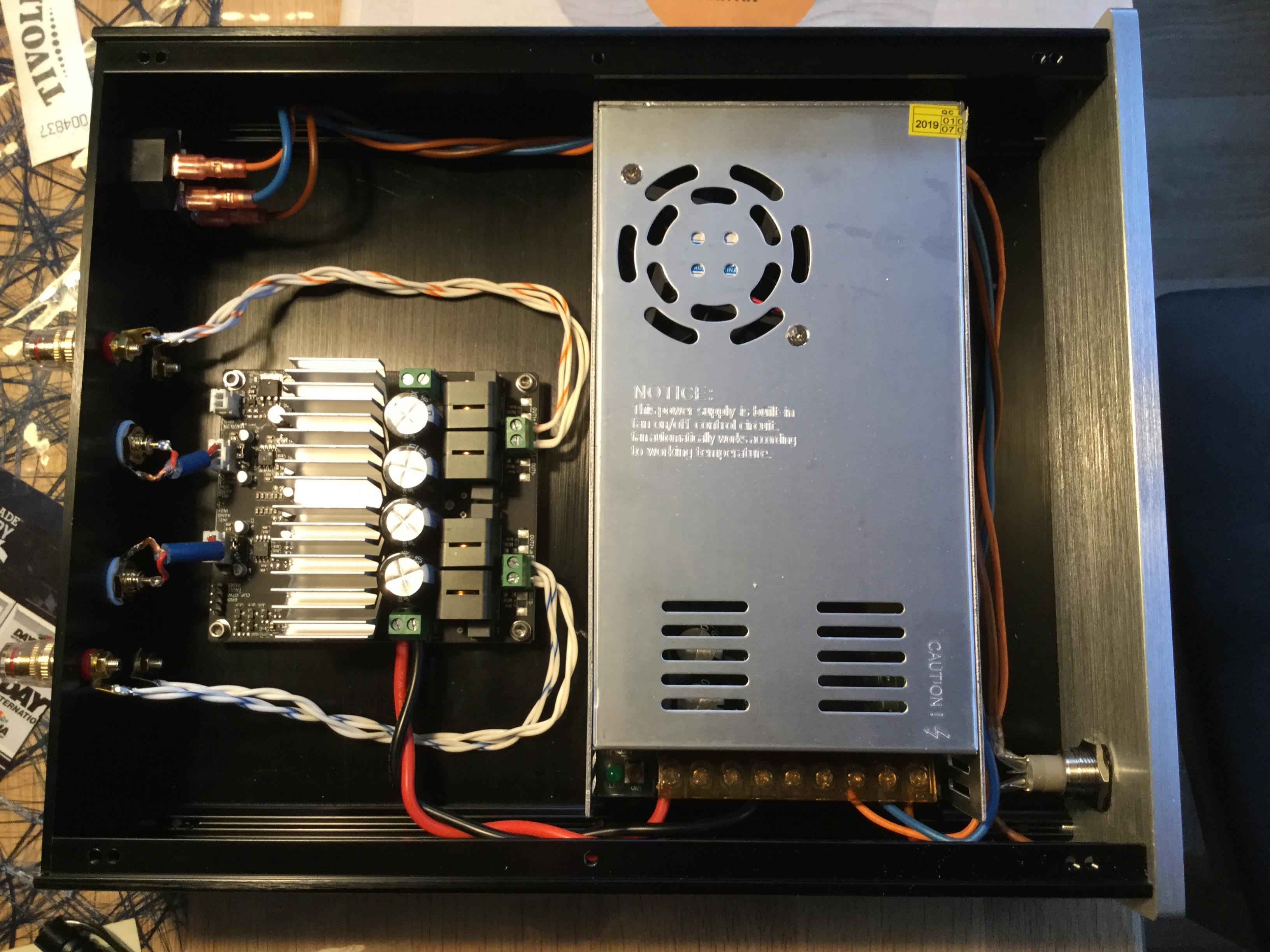

Got time to spend a few hours listening on my stereo.
First impressions are good. There’s absolutely no noise of any kind. Low end is deeeeep and very well controlled and tight! Midrange is okay, not quite as detailed as my Rotel amplifier, but not bad at all. High end lacks a little detail but quite neutral. Sound stage is not as wide and deep as I could wish for, but it does nothing wrong, just not quite up where I would have liked it to be.
But considering the building cost of around €200 it certainly performs well!
I’m considering building a new amplifier using the Hypex ucd180hg modules, I guess I will get the details and soundstage I’m looking for.
