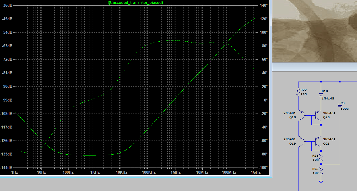

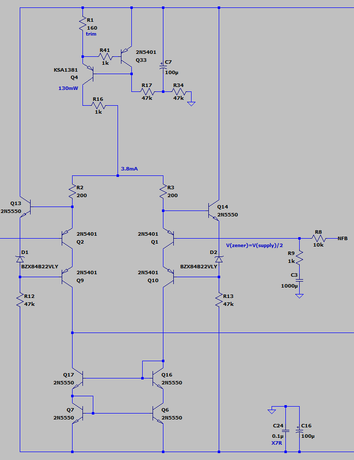

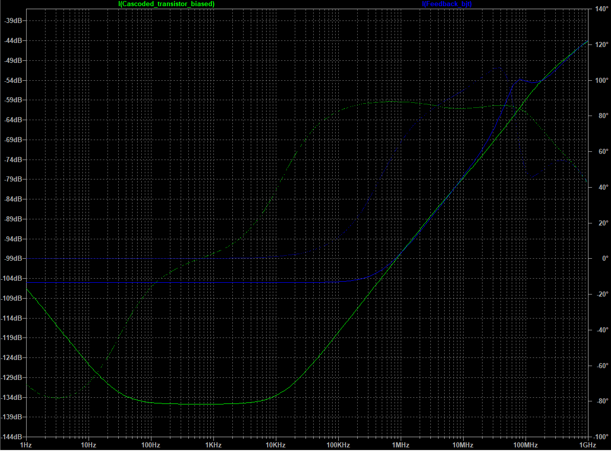

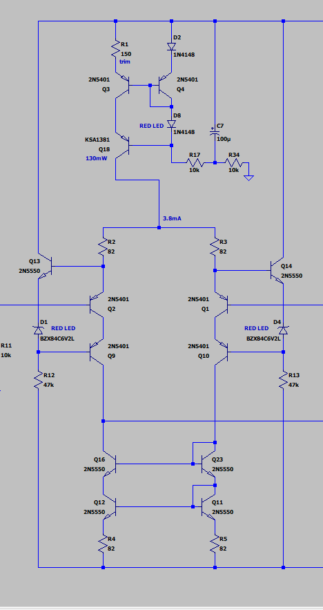

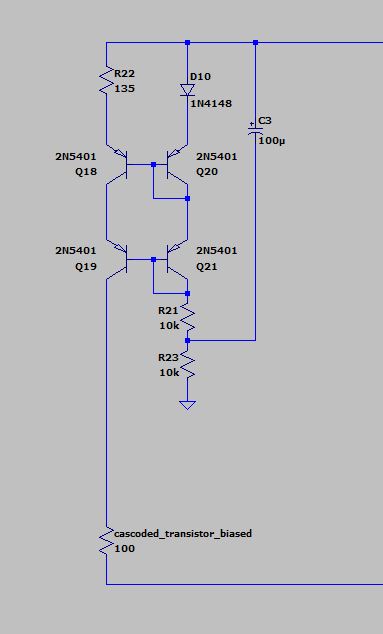

So here it goes: cascoded constant current source supplies current to cascoded and bootstrapped Long Tailed Pair that is in turn loaded to the cascoded Current Mirror. Ah, the perfection!
I(R4) = 2.0227059mA
I(R5) = 2.0227046mA
delta[] = 0.0000013mA
CCS delta[] = 0.000145mA
So after playing with the cascoded and individually bootstrapped LTP arrived at schematics that is attached.
CCS is a simple two BJT feedback one but with 1k base resistor to create nice HF response.
200R degeneration resistors give nice square response with MC, TPC, or TMC.
High precision CM to minimize voltage offset at the output.

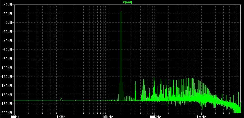

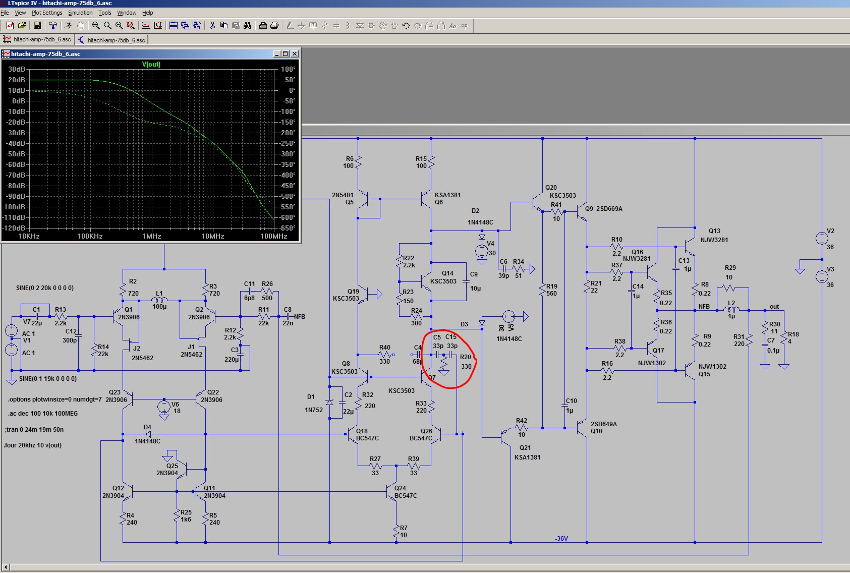

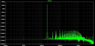

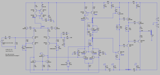

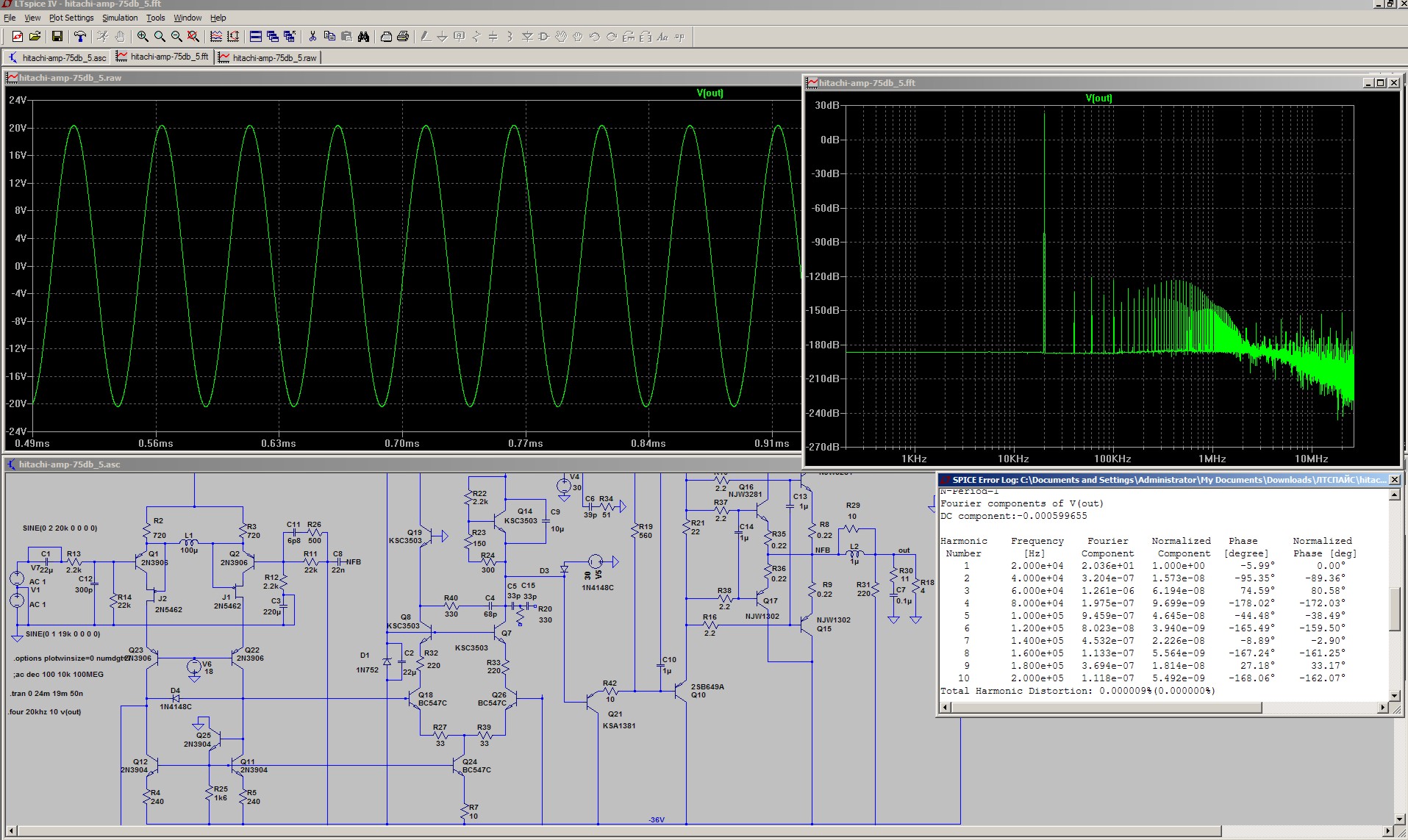

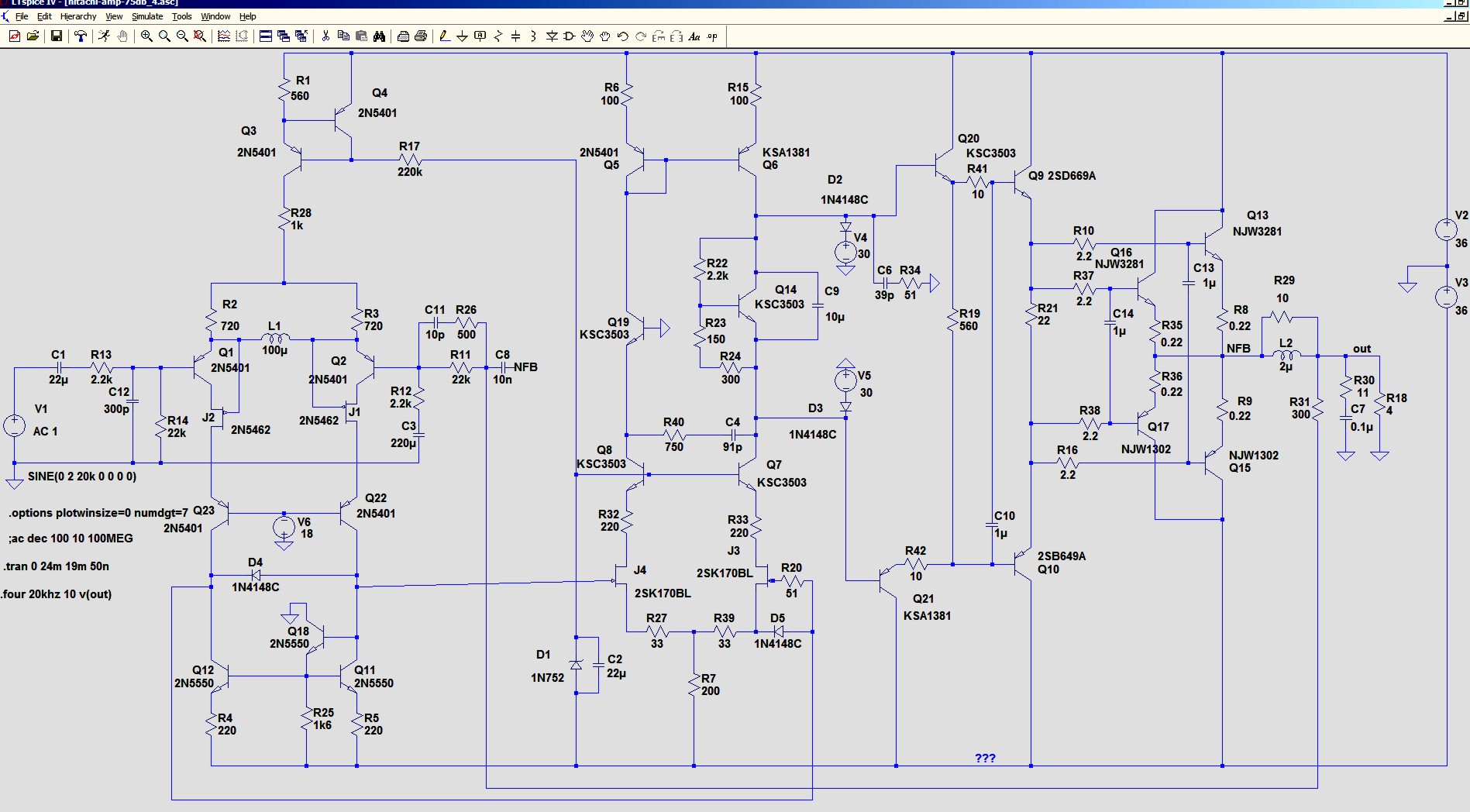

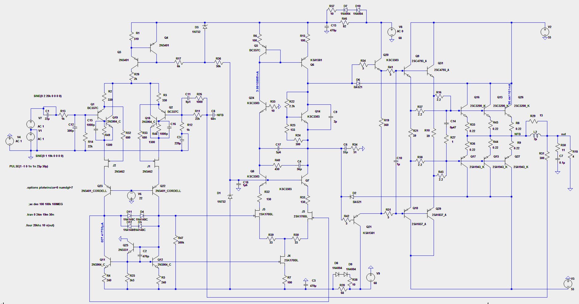

Hi everyone.

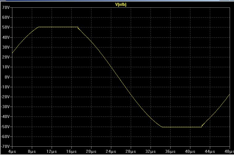

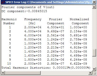

I have modified this version of the amplifier in the simulator. It has very low distortion, a very good clip and starts well after 1.5 milliseconds and goes into operation after about 30 milliseconds. I think this scheme should work. Any comments and suggestions.

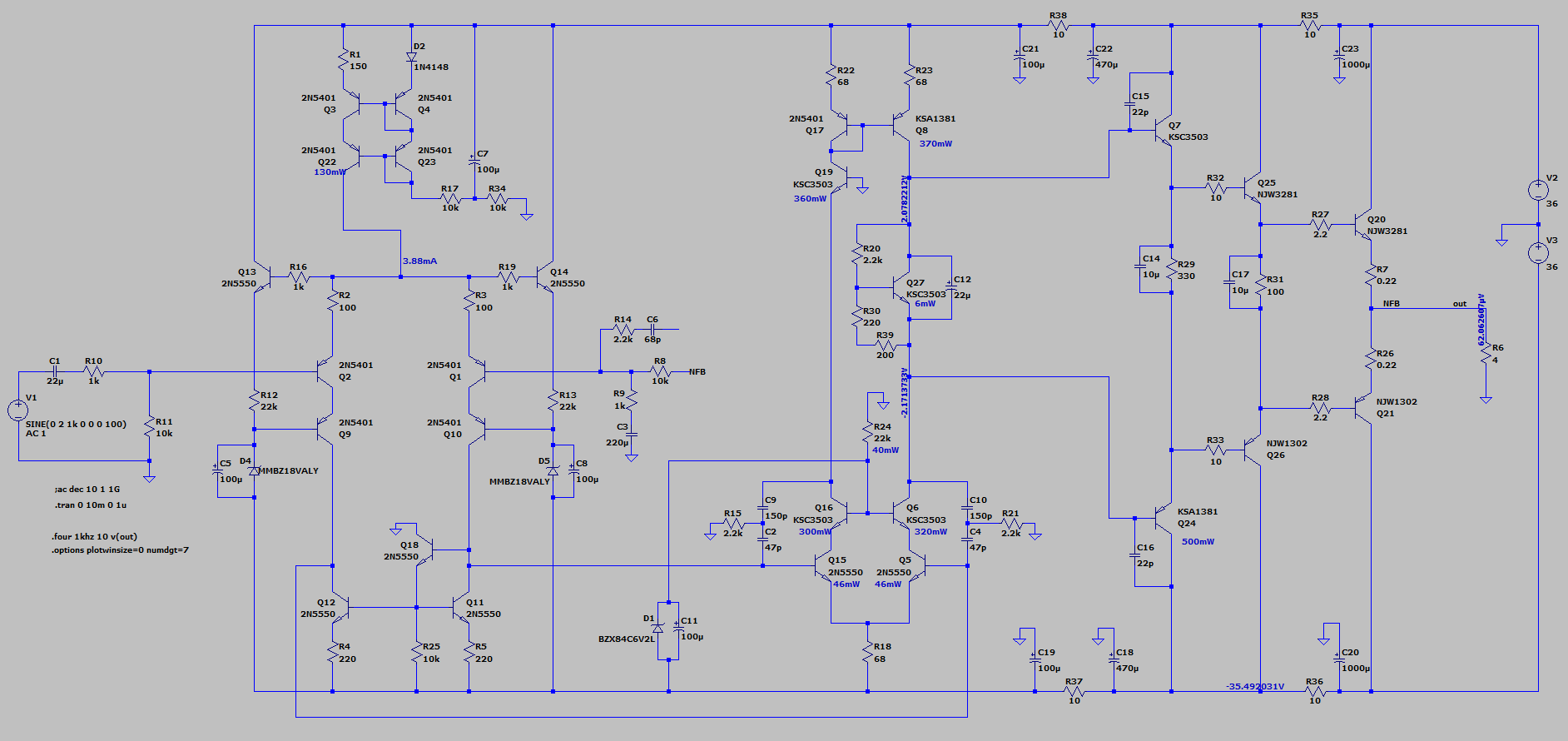

One thing puzzles me (didn't notice earlier):
The first LTP is loaded by a current mirror - doesn't this convert the output to single ended?
Nonetheless, both legs of the first LTP are routed to the inputs of the second LTP.
I guess the first LTP should have a differential load to preserve output swing on both legs?
HAYK did notice this already @ #8.One thing puzzles me (didn't notice earlier):
Don't trust simulations.
- Amplifier design based on HITACHI topology balanced VAS super hi OLG of 75dB
