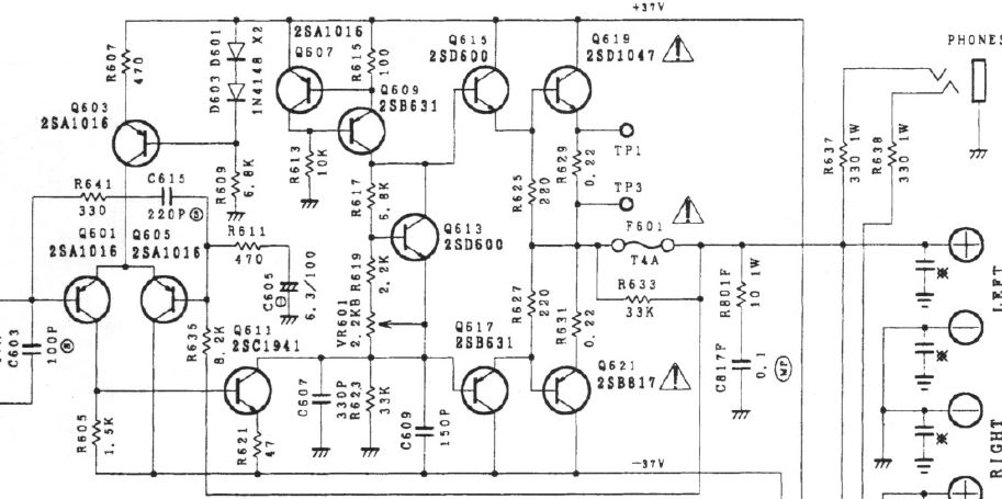

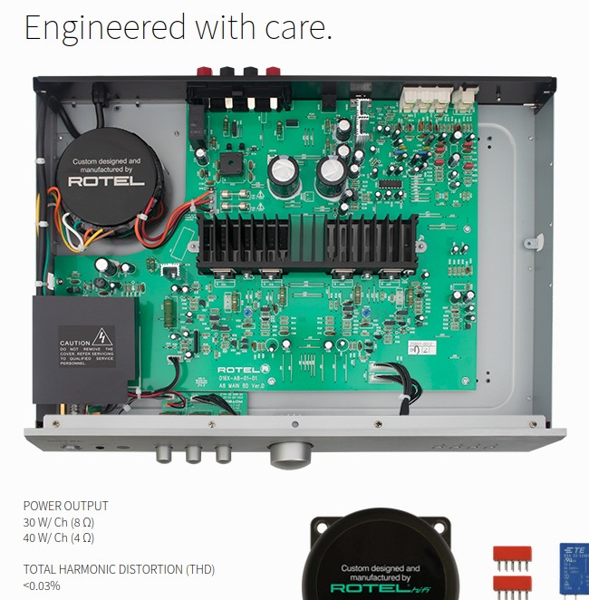

No-one ever regretted buying a Rotel Amplifier. Or was it an IBM Computer? 🤣
Rotel have been building essentially the same AB output circuit for about 40 years, and it still wins those VERY dubious HiFi of the Year awards:

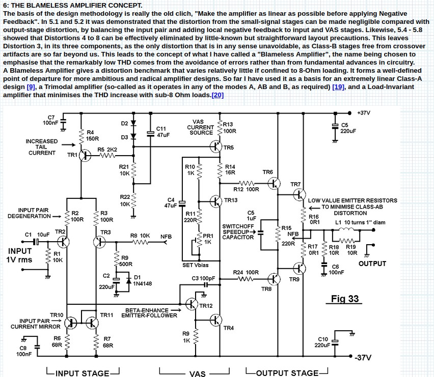

It's remarkably similar to Douglas Self's Blameless Amplifier:
http://douglas-self.com/ampins/dipa/dipa.htm
