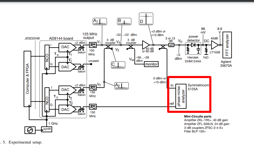

Expensive test equipment is required, but apparently cost of test equipment is not a problem for some folks.
Did you actually read the article?
Here is an excerpt from the conclusion:
"The power-detector option does not require a PN analyzer, which is a specialized and expensive instrument. The FFT analyzer can be implemented in GNU radio on the Z-Board, after adding an ADC daughterboard. Overall, this version probably fits in the budget of a radio amateur or hobbyist."
I was thinking about this setup:
The benefit of this approach is given as:
The other option requires a commercial PN analyzer. In fact, the design and implementation of such instrument is definitely not simple. The virtue of a fully-digital PN is the wide dynamic range, inherent in the CORDIC algorithm used to extract the random phase modulation from the sampled input [44].
My comment: already instruments such as professional PN analyzers are necessary to measure PN of clocks such as I use and some others use for audio. In fact, performance NDK SDA are measured on such equipment. If we want to obtain similar accuracy results from the approaches taken in this article, I would suspect that a more professional set of test equipment could be required.
