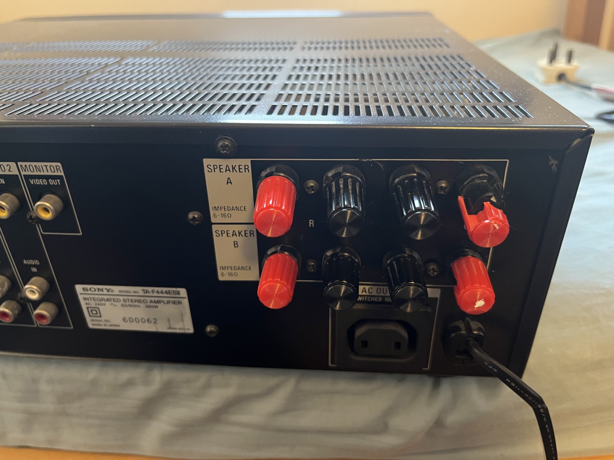

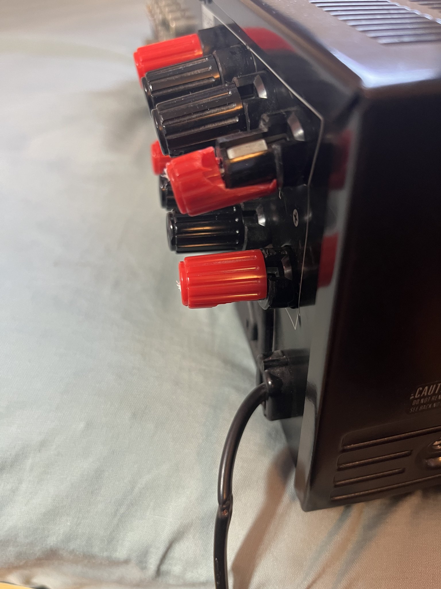

There are 4 connections on each of two plastic plates(one plate for A outputs and another one plate for B outputs), and the distance between 2 neighbour posts is around 24mm, thus 72mm between first and last one.
Seems it doesn’t fit to any imperial distancing.
I guess I will spend whole weekend searching for something suitable..
Well, the 3/4" "standard" banana plug distance works out to 19 mm. If they are 24 mm apart you will have to buy individual banana terminals. With the warning about underside plugs & sockets, https://www.diyaudio.com/community/threads/when-is-a-4mm-socket-not-4mm.406205/unread I would try swtichcraft neutrik or smith.

Well, the 3/4" "standard" banana plug distance works out to 19 mm. If they are 24 mm apart you will have to buy individual banana terminals.![]()
I had ordered some Deltron panel sockets for banana plugs.
The holes on rear panel are way bigger to accommodate directly any individual socket I could find, so I will end up making adapting panel for that purpose.
Hope Deltrons will do the job well.I would try swtichcraft neutrik or smith.

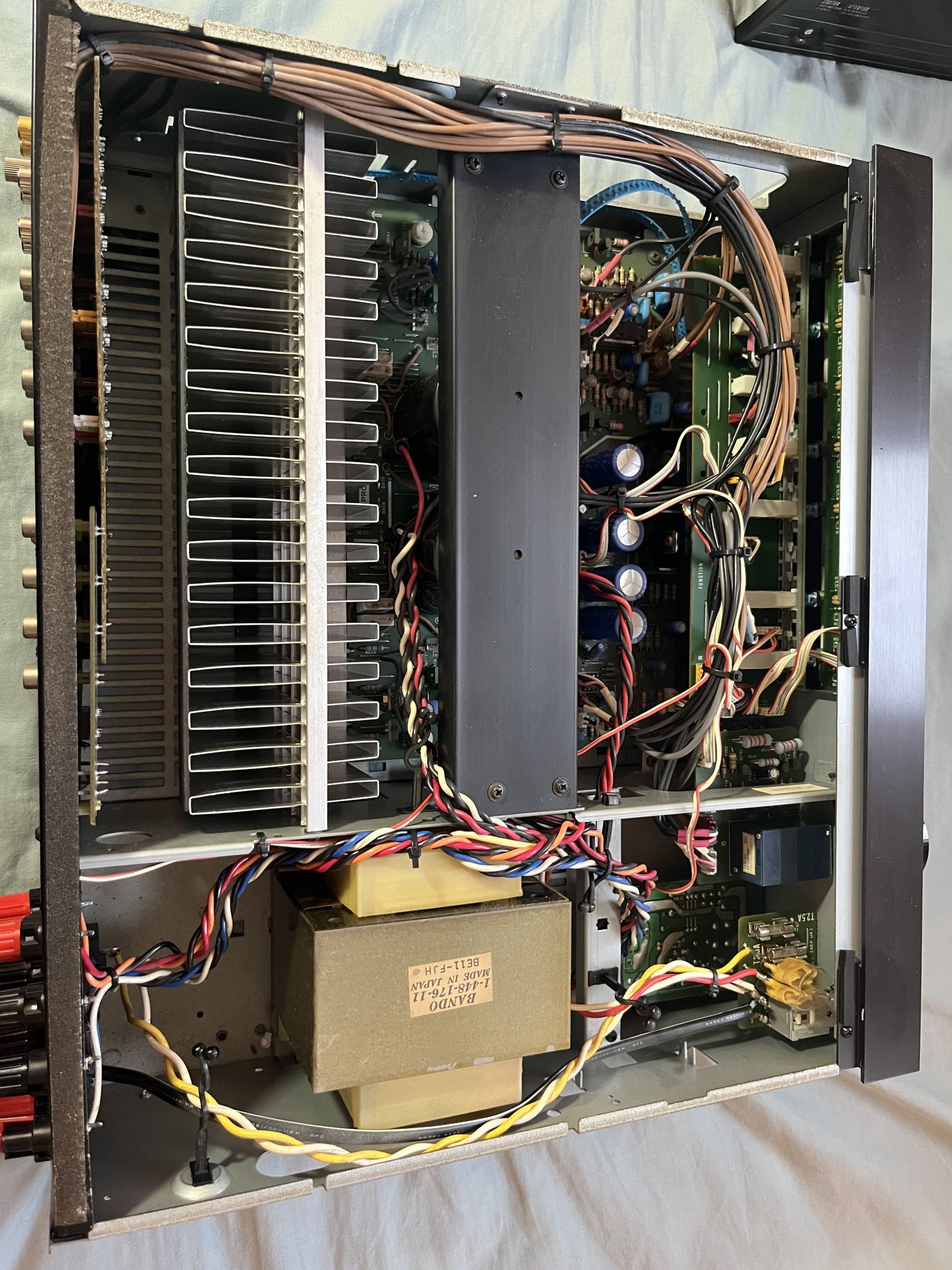

Then I am going to dismantle whole rear panel, cord out.
I will take panel to work, will try to flatten it the best I can, and create the adaptor board for new binding posts.
