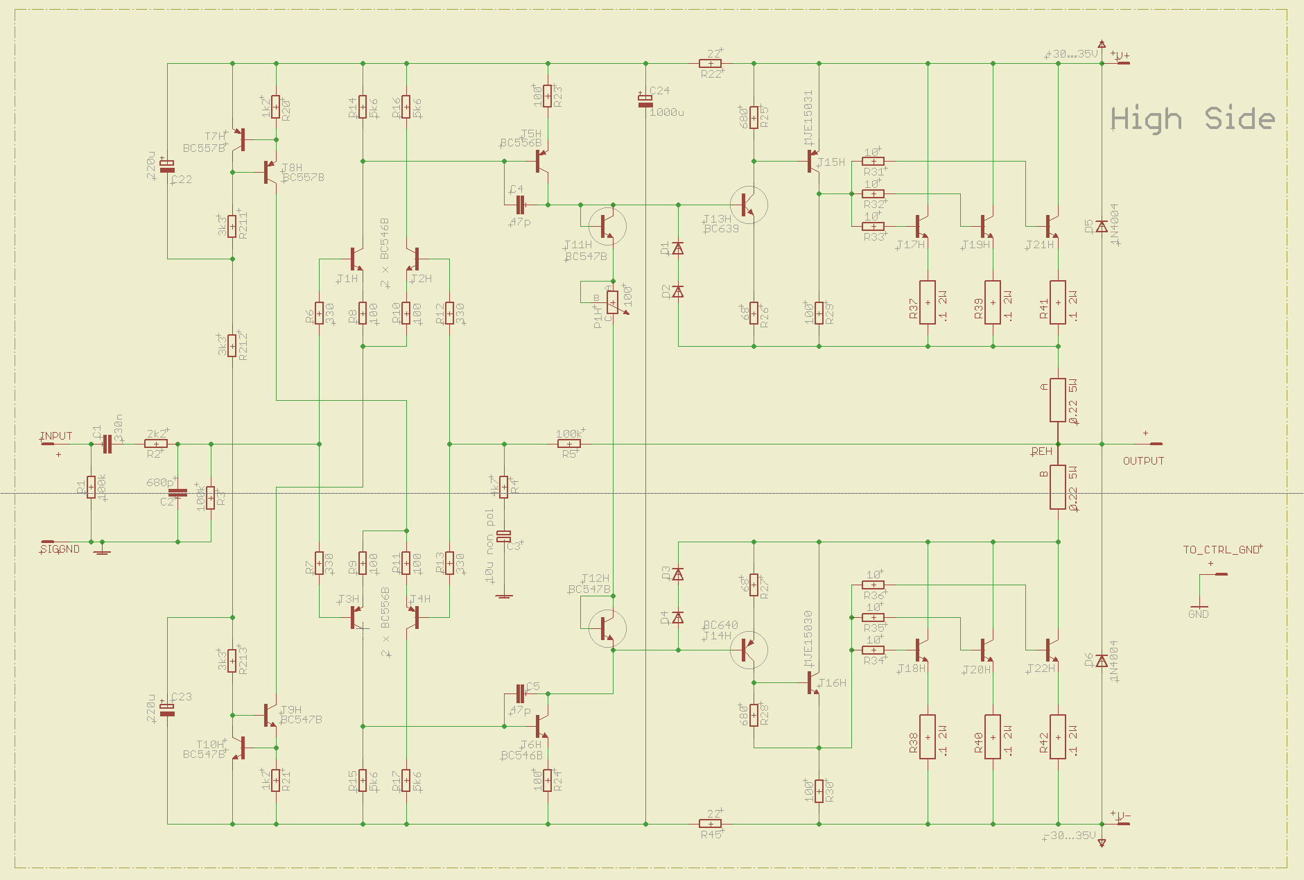

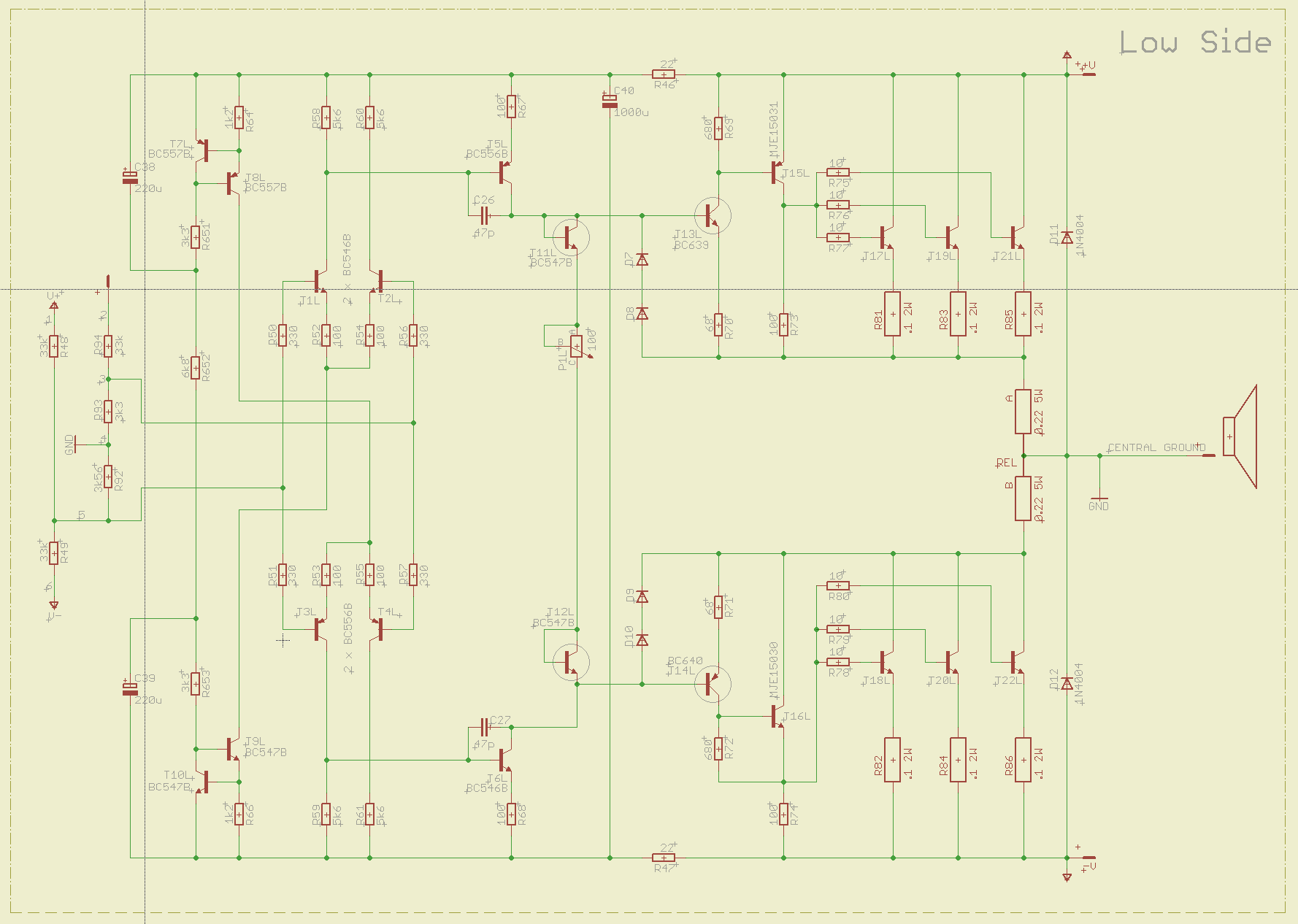

Just to make sure, I am re-posting the latest design of that elektor based grounded bridge.
This is the simple, no protection design for which I designed the pcbs as 2 separate boards for a prototype to resolve whatever issues it may have.

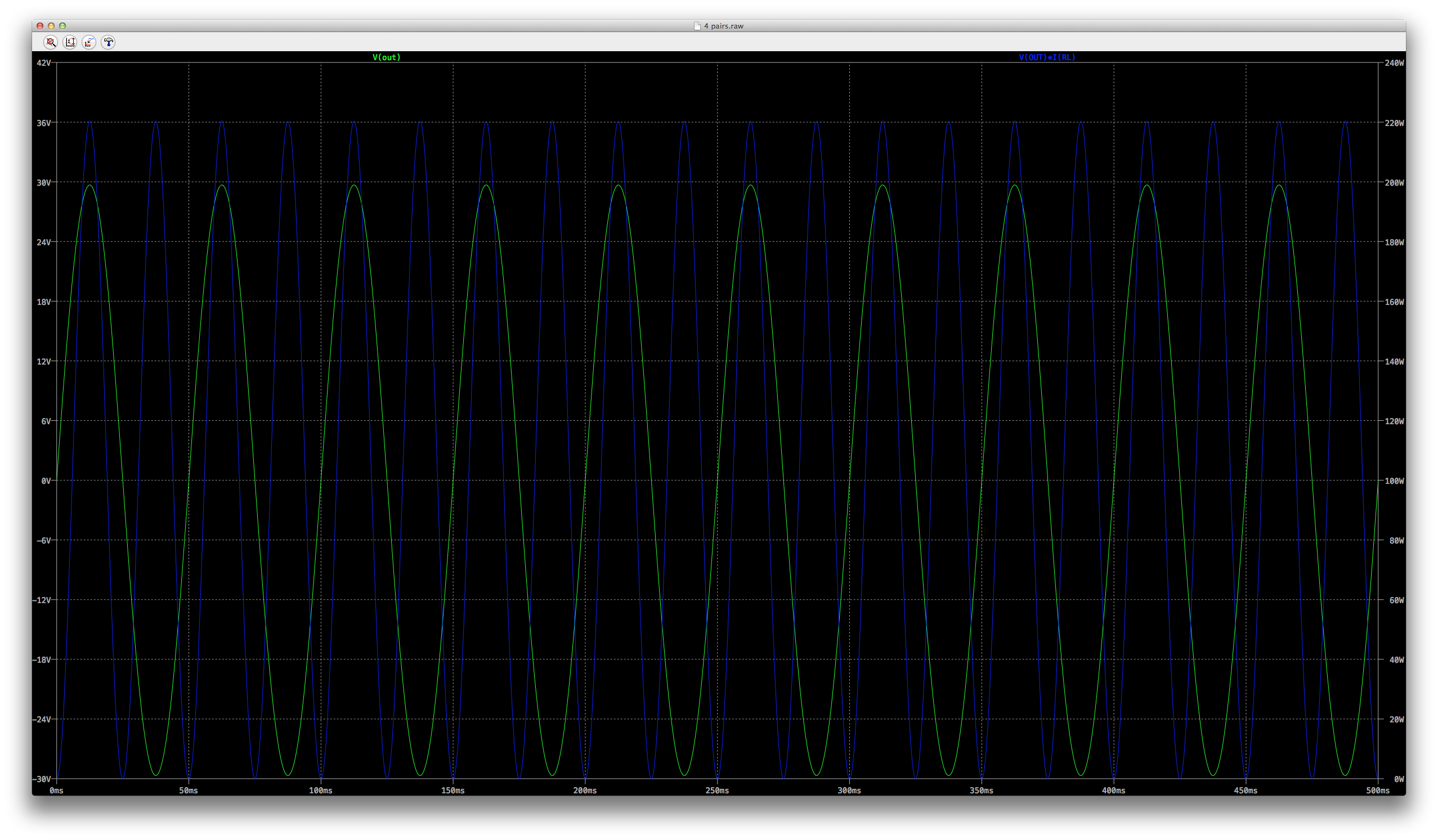

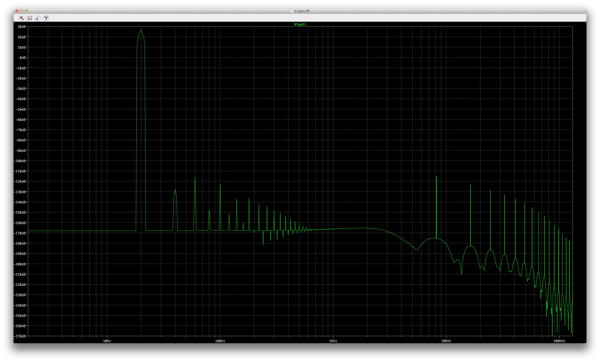

While trying to dig out my latest data for the grounded bridge amps, I found a simulation that I did for a complementary 2N3055/MJ2955 amp with an output stage topology based on bryston's.
I can't recall if I shared all this, but the simulation was running great and as I am trying to remember how to use it and run the various sims, I had to re-learn certain things, including how to get FFT plots done.
I ran that sim again and took a couple of snapshots that I'm attaching here.
Does this look good?
I think it does, but I'd be curious to get impressions from others.
That amp is fully symetric and has 4 pairs of the 3055/2955. It has protections and runs on 35V rails. I made another such sim with MJ15015/16 substituted for the 3055/2955 with the rails bumped to 55V, and it's just as clean and runs great.
btw: that 3055/2955 sim ran with a 4ohm load. Not a bridge, just a single amp.

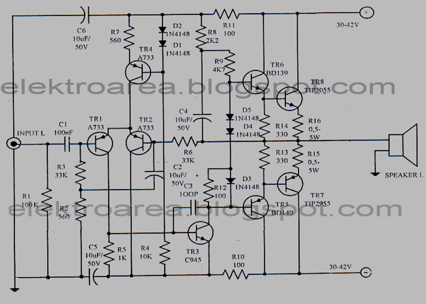

i have an old amplifier using 2N3055
till now, it still working
i give this circuit a job for driving my 6 inch ACR subwoofer 300 watt
also with some modifications
at the power supply i use 3 couples of 4700uF/50v capacitors, 2 couples of 104J capacitors and 1 couple of 47uF/50v capacitor
at the circuit i have been changed 4 capacitors from 3 x 47uF/50v to 22uF/50v and 1 x 47uF/50 to 10uF/50v

A quick look at that sim and I question a few things.
First that cap shunting the input right there before anything else, with no R to make it a filter. We can't even know what the cutoff frequency is.
Next that C5 blocking cap is only 10n, and with about 33k after it, that cutoff frequency is below 500hz. So I don't even see how full range audio could pass through.
One other thing is the 2N3055 is only TO3 case, while the MJE2955 is only TO220, so that's more than odd, and I don't see this being built for real as is.
No output filter?
No cap on global feedback?
And besides, I found that the diode based current source is among the worst performers...
No output filter?

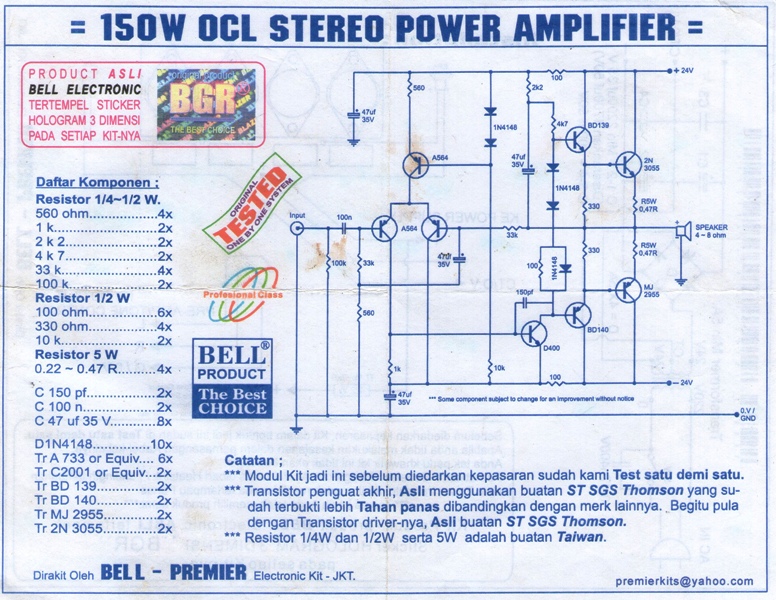

i am forget, this circuit come to me with stereo module not mono
also, i give you my attachment about the guide from its manufacturer(before my modification) and kit picture itself
