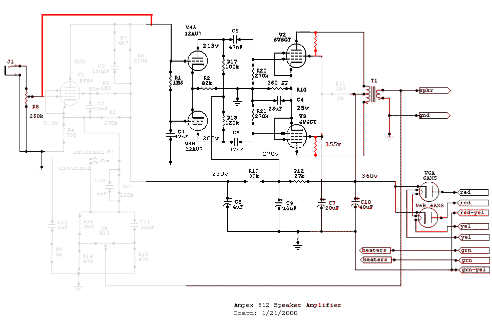

ive got a pair of these Ampex 612 or 620's, and would like to get them sounding a little better. (they're labeled as 620's, but match the 612 schematic)

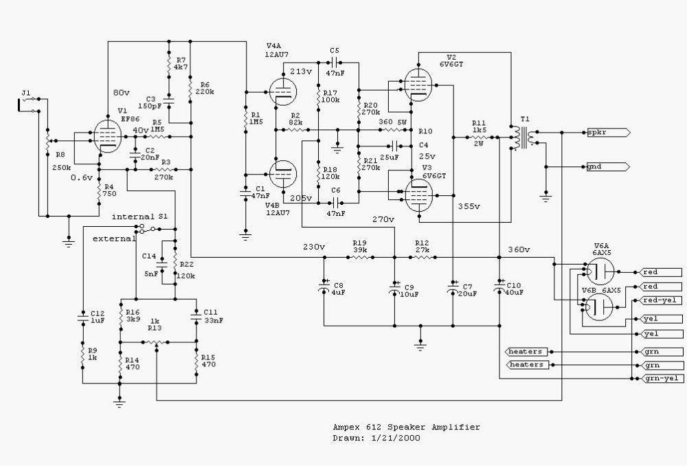

Basically, it looks like they used to have a tone control, and someone has removed it, and sort of butchered the feedback circuit. I redrew the schematic as mine have been modified, but I can't find my drawing anywhere! I'll have to take a look at them tonight and redo it.
I'll attach the 'stock' schematic here.
The issue I'm having is that they are very high heavy.
also, there is much more going on in this schematic than any of the schematics I've seen posted here as being a "good" P.P. amp.
If anyone has a few minutes and is bored, could you look at this schematic, and tell me how I could modify these to sound better. I don't really want the tone control on them at all. I'm afraid I don't know enough about amps at this point in time to know what is going on w/ the feedback.
I did disconnect the nfb all together, and it sounded bad.
Other than being high heavy, I think they sound great! If I connect them to some bass heavy speakers, or add a powered sub to fill in the low end, they're perfect.
I guess I should add that they aren't in their original cases, and don't have the speakers they originally come with. I've built them into a nice modern looking chassis. At this point, there's no reason to keep the amps stock, for historic reasons.

That looks like a Mullard style circuit, with the tone control stuff inside the NFB loop. Bad sound after disconnecting the NFB circuitry is not surprising.
You did say simplify. How far are you willing to go? Could you live with 6 W. of O/P from triode mode, as opposed to 15 W. from pentode mode?
A complete rebuild is an option I was thinking about. As long as I can use the same tubes, and obviously transformers.
I only found a couple of 'hi-fi' 6v6 schematics, and they were completely different than this amp.
What's the purpose of the first tube in this schematic? Is that splitting the input to the upper and lower tubes? I ask, because most of the schematics I've seen do not have that stage.
I think I could live w/ 6 watts. It's a tough decision. I got a single ended triode amp, so do have the speakers for it, but more power would be nice........
A major simplification of the feedback circuit would be nice too.
At this point, however, I'm not sure which components are boosting the treble, and which the bass, and how to figure out how much feedback to apply.

That NFB loop is confusing, I agree. To remove the tone control, you could replace the feedback network with a straightforward resistor, i.e. replace C11, C12, C14, R9, R13, R14, R15, R16, R22 and S1 with a resistor that goes from the spkr terminal to the cathode of V1. Try a value of 15k for the feedback resistor. If the amp is too sensitive, you can reduce the resistor to taste and/or strap V1 as a triode (see later).
It's a bit more complicated than that, though, because the more feedback there is, the greater the risk of HF instability. There almost certainly needs to be a capacitor in parallel with the feedback resistor. A 'ball park' figure of 100pF to 330pF might be suitable, but its exact value depends on the characteristics of the output transformer and no rule of thumb can be used. A square wave generator and oscilloscope are normally used to test the HF stability, and the capacitor is selected to give a clean 10kHz square wave at the speaker, without overshoot/ringing or round-shouldered appearance.
To explain the purpose of the first stage: it is a voltage amplifier that provides most of the gain. It may prove to have too much gain for the requirement and it might work better strapped as a triode, i.e. connect the screen directly to the plate and remove C2 and R5.
The phase is split by the 12AU7. Its plate loads R17 and R18 are unequal (100k and 120k) to compensate for the fact that there is a resistor (R2) as a common cathode load instead of a constant current sink. However, the difference of 20% in plate resistor value is unusual; 10% is more common.
I realize you prefer to use the same tubes but the 12AU7 is not a good one to use in any audio application and a 12AT7 would be much better.

I felt the need to heat up the soldering iron today, so I triode wired the ef86 and the 6v6 tubes. I removed the feedback.
I lost power, but the thing sounds great! It was a very simple modification.
A couple of friends and I had a listening test this evening between the unmodified channel, and the triode strapped channel. Other than the obvious loss in power, everyone agreed it sounded better.
I am not using a volume pot. I usually use a nice external sound card , or portable audio player (mp3 player, but I usually play lossess) as my audio source, and can control the volume there.
W/ everything triode strapped, it sounds quite similar to my 300b SET amp.
Whoever removed the original tone control and internal/external switch had things wired very strangely. They used all of the components which were in those circuits, but not in any order I could understand.
