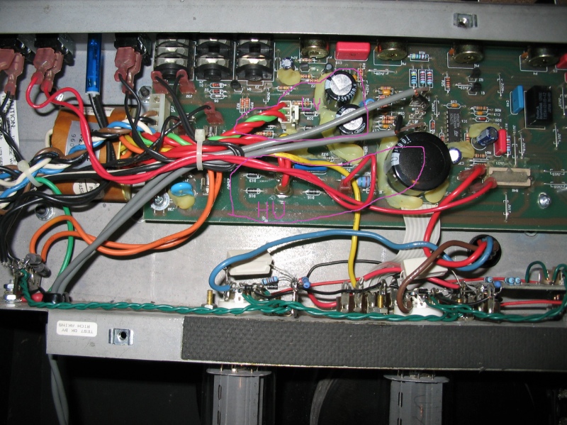

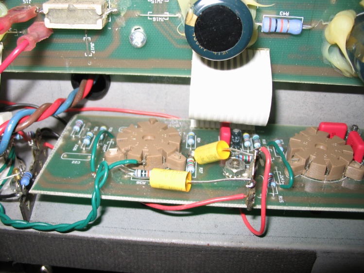

I also moved the heater jumpers above the board. It's so long ago, I don't remember if it reduced the hum level.
You can see that I chopped the board off, The rattling output tube caused a few problems, including an arcing socket, so I rebuilt the output section point to point. The cement block resistor at the top of the picture is also a replacement, a tube ran away and burned up the original resistor. I think I will eventually punch a new hole to the between the left power tube and the reverb send/receive cables and move the power tube that's next to the speaker over there.
attachment.php

Here are the spectrums of the recordings I did before and after I moved the flying jumper. I was careful to put the mic in the same spot and tried to adjust the input gain about the same point, but that was "about 3 o'clock" so not very precise. All I can see is that the clutter in between the 60Hz harmonics went down a lot.
Here is before I moved the heater jumper wire.
[/url]Spectrum of Ampeg noise before fixes by Dennis Kelley, on Flickr[/IMG]
Here is after re-routing the jumper wire.
[/url]Spectrum of Ampeg noise after flying jumper by Dennis Kelley, on Flickr[/IMG]
The humdinger was installed with the center tap from the transformer heater winding disconnected. The 500 ohm pot's wiper was connected to ground at close to the same point the transformer center tap had been connected.
When I substituted the DC battery I left the pot where it was and adjusted the same as it was. I figured I needed it tied back to something.
This is the actual waveforms I recorded using a mic. The upper two traces are the before, and the bottom two are after the flying jumper. I had it setup to convert to stereo, is why there are two of each.
[/url]Ampeg analog before and after by Dennis Kelley, on Flickr[/IMG]
Clearly you can see the waveform recorded by the mic looks a lot like the waveform seen by the scope. The after waveform, may not be correct. After I did that test, and decided I had fixed it, I had problems with the amp not working right. I thought I had broken something in the process of troubleshooting the circuit? I discovered a piece of wire i had used as a jumper to try and short out two node to isolate the signal. It was coming and going, and when I tried to turn the amp up it became intermittent. So i'm not sure if my quieter amp was due to the wire jumper or the shorting jumper I forgot I had installed, and was just shorting when I did the noise test, but then was not shorting when I ran the actual guitar through it. I think these are valid, but I'm not positive.
The results with the DC heater and the humdinger were all done after I found my shorting jumper.
I think I am on the right track. What amazed me was that it still hummed and buzzed, even with the DC heater voltage. But if the noise can get onto the 6.3 Vac through radiation, then it could just as easily get into the DC heater voltage. It can't be coming through the transformer like I thought it was, because the battery was not part of the transformer.
If I apply ground at the cap end of R13 I get no change. If I apply ground at the grid end of R13 the noise is silent. So it has to be this point that the noise is getting into the circuit. Maybe?
Oh, one more thing. Notice the higher frequency ripple on the analog waveforms? On the scope trace I saw a wide thick fuzzy waveform. Moving the scope probe around made this thicker or thinner, so I just assumed it was an artifact of the scope ground and stuff. But is this oscillation that I am seeing? That's what it looks like on the analog waveform? There is a place for a cap across the plate resistors of the tube that has the noise on the output. Right across R15. You can see it in the picture which shows the flying jumper I put in. i don't know why that cap is or isn't there. All I can find in my searches is it may be a way of making it not so bright, or of preventing oscillation. And for that matter why are there two resistors on the plate with the output signal being taken from between them?

I'm not fully across your changes so far, so please bear with me if the following suggestions make no sense now or are over the top.
If you short C9 R13 junction to local ground (C48, R?6), then:
- tube roll to double check the tube has nothing to do with it.
- lift R13 leg from pcb pad at the R14 end (so just R14 is grid leak wiring).
- connect a 1Meg between the valve holder pin and 0V (to check R14 is in circuit)
- connect a 10-22uF cap from 0V directly to pin 8 in holder (to check that C48 is doing its job).
- check dc bias level of V2B cathode during the above, and probe across master vol pot R17 junction to look at noise.

Ha! My thoughts are:
1. take steps (to be determined) to reduce rectifier noise and/or transformer ringing
2. bias up the heaters to +20 or 30v
3. if that doesn't work, tear it all down and rebuild point to point
Here's a pic of the power section of the amp. I've circled and labeled "LV" the low voltage, +/- 15 v supply, and the HV supply. In between those two there are two more diodes, that's the bias supply. At the top, from left to right are jacks: footswitch, line in, line out. Potentiometers: reverb, master, bass, mid.
attachment.php
