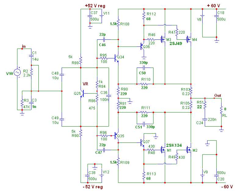

fab said:
Hi lineup and ilimzn
This is what I came up based on your comments. I kept the drain resistors for now...
I can not have only 47 + 39 ohms in the dividers b/c of the high power of the amp....
fab.
Okay, use the resistor values that will work.
You are the one that would know best.
And you can run the Simulations, too see the results.
My suggestion was Without Buffer transistors: Q36 Q37.
These buffers will allow higher value resistors, this is only a good thing.
I think your latest schematic looks good.
I downloaded and saved it in my /diyaudio-persons/fab folder ;)
Where I have ALL the versions you have posted of this amplifier.
Regards
lineup
fab
Joined 2004
version w/o extra buffer
This one with a single feedback resistor does not require the extra buffer but more gain...to get same output...
Re: version w/o extra buffer
I think you should keep Q36 Q37 buffers for Gates.
It is not good to let Output Stage do high % of the amp total voltage gain.
Because this gain has got not same QUALITY,
as for example INPUT Stage.
The trick is to make the INPUT stage do as much of the gain
as possible,
But not that much of it that input stage start making a BAD JOB.
Because input stage transistors, are The Faster ones ( fT 300MHz ).
They are often also working in a more linear region
of amplification. At those currents they operates.
lineup
fab
Joined 2004

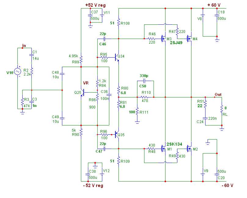

Re: Updated output
fab said:
This is what I came up based on your comments. ....
Sorry I had a divider (input filter) in the input section too high for the impedance of the this CFP stage. I knew that the simulation was wrong the the theory of the gain was right:
CFP gain = 1 + R110 / R80 ( approximation since the open loop gain is not that high...)
So I get back to my divider with a gain of about 2 since I do not need 60V output and I want to limit the risk of oscillation as much as possible...Anyway, the power supply will drop problably at about 56v with both channel driven and if we add the Vds drop with a high RDSon (lateral mosfet) at high output current then 50Vac or so signal amplitude is quite OK.
fab
Joined 2004
lineup said:
How much will you bias MOSFET 2SK134 / 2SK49 ?
Because I suppose you will be running in Class AB.
From what I have read in several different articles,
something like 90-100 mA per device
is what good designers use.
Hi lineup
Of course class AB (DH-220 chassis with +/-60 Vdc !!!).
I use about 120ma per device (after the change of slope of temperature coefficent...)
I already have a "big" AMP having class A (15Wrms) + AB (70Wrms) / 8 ohms (see my picture web page...) with 5 x 2SK1058/2SJ162

Hi kanwar
The CFP parts is quite interesting...is similar to mine but different since VGSoff of the IRF are higher and transconductance higher too.. this reminds a bit of SKA amp output (buffer + mosfet)...
Can you comment my circuit

fab said:
Hi kanwar
The driver stage in your amp is CE which is prone to oscillations with HF , also Cross-Conduction is likely to happen above 25khz and large clip sticking during saturation because of charge storage effects....
If you look in my circuit it uses CB which is much faster because of absence of Miller effect and there is no cross-conduction at HF...
regards,
K a n w a r
Also, The Turn-off of mosfets in your circuit is passive and Turn-ON is active, which again contributes to cross-conduction at HF, while you can eventually see in my circuit turn-off is faster and active while turn-on is slower and passive with simple resistor...
Also it improves the capacitive load handling
fab
Joined 2004
Re: Re: Kanwar comments
Workhorse said:
Yes, it could be very well adapted for the Lateral Mosfets...but given the threshold gate voltage for mosfet should be atleast 1.5 volts minimum or you have to change the EF driver to a regular one...
You mean removing the EF driver? if so I am getting back to square one where a 50 ohms mosfet drive resistor and the CFP divider power dissipation...
