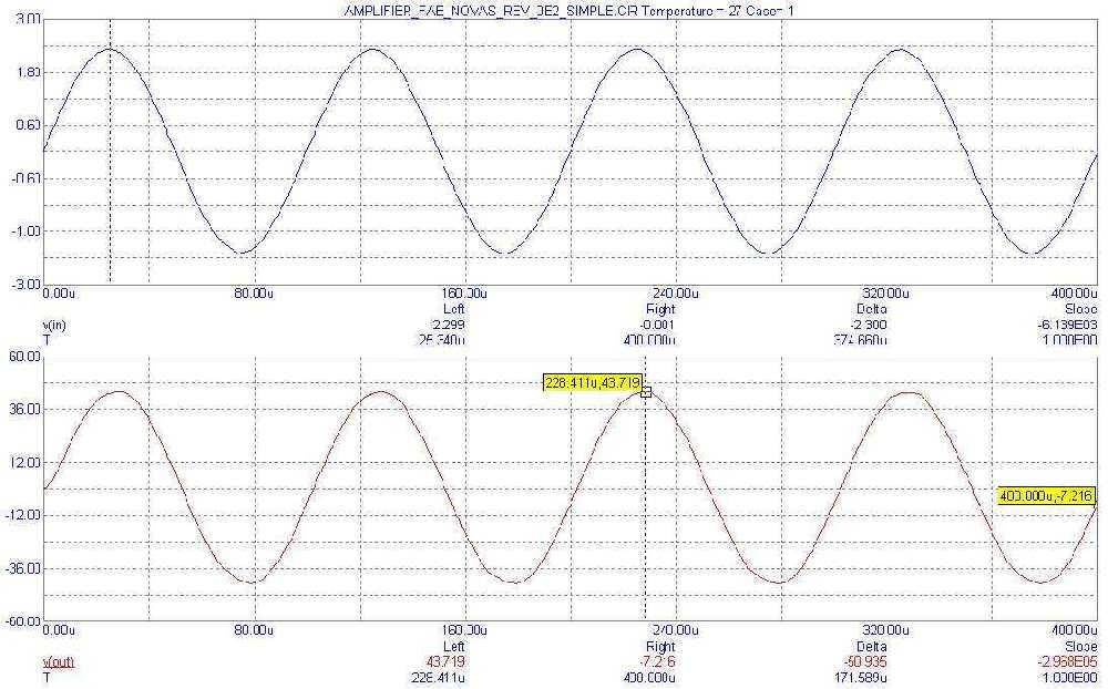

New model rev 3B
Hi
I did not "like" the bootstrap caps (electrolytics...) so I used a high input stage gain with active load instead. However, to do that I had to remove the buffer stage after input stage in previous version and use a traditional VAS (cascode) with "medium" open loop gain. The output impedane is now 10 times lower with this circuit version...
Playing with the caps value I could equalize more the rising and falling edge of the square wave (as shown with the simulator...)

Re: new model rev 3B
yes, looks very nice and flat
the open loop gain is not too high, + 56.7 dB: 650-700 maybe
fab said:AC analysis of OPEN LOOP circuit to show "flat" open loop medium gain until about 20 KHz (simulation).
Hi lineup
yes I think that the relatively small open loo could suffice since I have fate in the linearity of the gain stages because of local degeneration...anyway just changing some resistor values and it is now 63db...
What do you think of this version 3B compared to previous model ...rev 30?
I really can not tell much.
I wish I had the knowledge you have about this amplifier.
But this testing you show is promising.
When I said 'not too high gain', this was not anything negative.
If amplifier have good linearity in open loop
then we may need not too much feedback.
So having lower gain, still may give enough feedback
for very good closed loop performance.
If you now have 63dB.
And you have closed loop gain ~20, (= 26 dB )
This gives feedback ~37dB.
I have elsewhere told I, in some amplifiers, aim for 40dB feedback.
I know Pass and JLH have built amplfiers
having less feedback than this.
Very good amplifiers.
