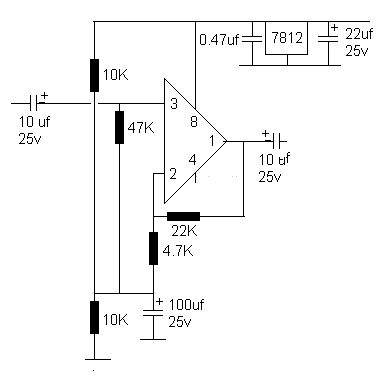

1. there is no 42kohm or 47kohm res in the schematic (post 40).
2. have you built in a voltage regulator (like 7812 or so......)?
3. option 1: what is that? you need a power amp between opamp and speaker...........

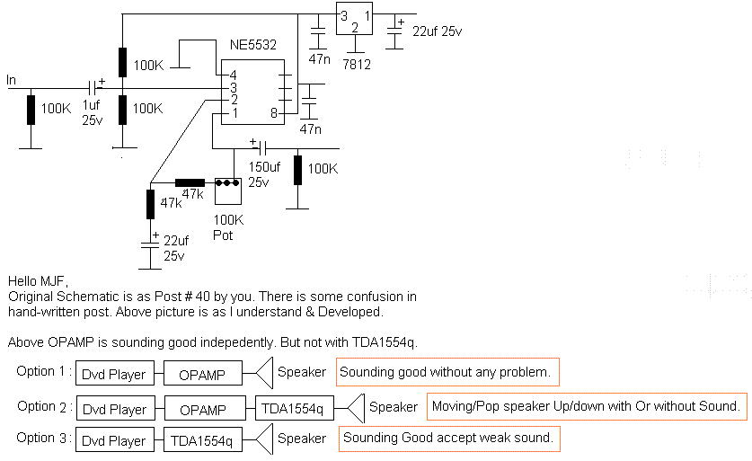

Something wrong. Pl find attached picture & do required corrections.
I have tried opamp with three options. Source sound supply is DVD Player. Power Amplifier is TDA1554q. I wish to add Opamp between DVD Player & TDA1554q as Subwoofer signal inhancer or active crossover with good gain.
My problem is TDA1554q is sounding good but weak in case of subwoofer. becoz DVD Player sub-signal is weak to amplify by TDA1554q. I am going to improve sub-signal by your OPAMP.

What he means to say is that there is a low-frequency oscillation which is causing the woofer cone to move even with no input signal.
Pra(kash/deep, whatever), layout of the components is critical if you are not using a PCB. Decoupling needs to be kept close to the chip. Signal paths need to be very short. Filtering needs to be proper. Your problem could be stray pickup from airborne interference, or the input signal coupling through the air to the power supply (which is what I suspect). You may have not employed any bandwidth limiting either.
What I would do is:
Fit a IC socket on to a PCB.
Wire in all components, ensuring that the signal travel length is not more than the distance of the component.
Ensure a regulated supply for the opamp. 7812/7912 should be enough.
You will need a split supply, which can have both + and - voltages.
Use a 1nF cap between the input pins of the opamp, to limit the bandwidth for the subwoofer part.
Don't cross the power lines with the signal lines, ever. Keep at least a few centimeters distance.
Finally, separate your power and signal grounds, and join them at only one point.
Your circuit is also pretty wonky.
Put the pot in the signal path, not feedback path.
The bias needs to be coupled to the + input through a small resistor, and also needs a small capacitor to provide a bit of reserve.
IMO 100K is too large, use a divider of 22K resistors with 22uF cap, and use a 47K resistor to connect it to the +pin.
The feedback resistors are too large all around. A combination of 22K and 4.7K will yield 18dB of gain, enough for you.
22uF will work fine with that set of values, as you're using.
Finally, reduce the output cap value. 150uF is too large and will have much poorer ESR than smaller types.

schematic in post 40 is a standardapplication,often used in preamps,mixers and so on.......
i have built some of them and they always worked without problems.
i will have a look at this problem tonight or tomorrow.
in the meantime you can try this: change the 22uf elcap (in the feedback loop) to a 1uf cap (because you changed the rc- arrangement to a much bigger value).perhaps this is the problem.........
greetings...........

I'm sorry if this sounds bad, but you'll need to read a little bit if you're going to attempt something like this. Nuuk's Decibel Dungeon, Rod Eliot's ESP site are good places to start. No pain, no gain. The problem is not restricted to a schematic. The actual construction may be an issue, so no amount of scrawling in Paint will help. Just a lot of reading and building, then trying again. You'll have to learn basic grammer and spelling if you want to talk, so in the same way you need some basics.
Once again, here goes:
Fit a IC socket on to a PCB. What did you not understand of this?
Wire in all components, ensuring that the signal travel length is not more than the distance of the component. The leads should be trimmed close to the package. As short as possible. Plan your layout accordingly.
Use a 1nF cap between the input pins of the opamp, to limit the bandwidth for the subwoofer part. that would be pin 2 and pin 3. Read about an opamp and how it works.
Don't cross the power lines with the signal lines, ever. Keep at least a few centimeters distance. What did you not understand? The wires and components need to be at a distance from each other, crossing only at right angles.
Finally, separate your power and signal grounds, and join them at only one point. The signal ground is where the signal input and ground come to. The output ground is where you take the output from. The power ground is where the voltage divider is referenced to ground, and the voltage regulator is grounded to.
Put the pot in the signal path, not feedback path. Pot should be before the input, or after the output of the opamp - remove it from there. You know, connect like a normal volume control - one pin to ground, one to input, one to output, like you normally do.
The bias needs to be coupled to the + input through a small resistor, and also needs a small capacitor to provide a bit of reserve. IMO 100K is too large, use a divider of 22K resistors with 22uF cap, and use a 47K resistor to connect it to the +pin.
The above refers to the two 100K resistors forming the voltage divider to set the supply half-bias since you have a single supply. First, the divider resistors need to be a little lower. A capacitor from the midpoint will act as a small supply reserve. Then a resistor should be used to connect pin 3 from this half point. As of now pin 3 is directly connected to the half bias point. Not a good idea.
The feedback resistors are too large all around. A combination of 22K and 4.7K will yield 18dB of gain, enough for you. 22uF will work fine with that set of values, as you're using. The feedback resistors come from Pin 1 to 2 and with the RC network to ground. There should be a 22K from pin 1 to 2, and a 4.7K and 22uF from pin 2 to ground.
Finally, reduce the output cap value. 150uF is too large and will have much poorer ESR than smaller types. This is clear, hopefully. A 10uF cap is adequate here. Please do not connect the NE5532 directly to the speaker (as you indicate in your drawing), any damage will be permanent and will ultimately spoil your sound quality - it may already have, so you may anyway advised to get a new IC or use the other half.

Edit: Is that connection of the feedback 22uF cap to the midpoint a typo? Maybe that is what is causing the hum. There should be no connection there, it will lead to some DC at the output.

I have scraped my 1st circuit & developed new one with all new parts including IC. Now it is exactly as my new posted schematic.
Please find there is no adjustable gain. Even I have changed gain-parts as per sangram's post.
