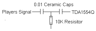

Actually I don't have real crossover but I have already developed filter as under.
NOTE : To all IC, input capacitor already mounted 10mfd 25v
IC1:A: = For tweeter : Palyers Signal goes through 0.01 Ceramic capacitor -> 10K Resistor to Ground -> 0.01 Ceramic capacitor -> 10mfd 25v Input Capacitor
IC1:B: = For woofer : No filteration.
Pl. find picture for tweeter filteration.

With the passive filters you use now, you don't need any. If you want to use active filters, the power supply from post #20 with voltage regulators added will be the right solution. You need a center-tapped transformer like the one you have or a dual secondaries transformer, but much smaller power rating is sufficient. E. g. 2*12 V or 2*15 V and something between 3 and 10 VA.pra3718 said:Still I did not work on preamp/crossover. So which OPTION of PSU would drive preamp/crossover confortably.
10 mF or 10 µF?pra3718 said:NOTE : To all IC, input capacitor already mounted 10mfd 25v
That should only be for the subwoofers, but did you notice any improvement?
The 10 mF or µF capacitor is of no use here. 0,01 is that 10 nF or 10 pF? I assume nF for the following. The first capacitor and the 10k to ground form a filter with 1591 Hz corner frequency. The second capacitor and the input resistor inside the TDA1554Q (60k) form a filter with 265 Hz corner frequency. The first capacitor should probably be bigger, the second capacitor should surely be bigger, but without knowing the exact speaker type you use it is all guesswork.pra3718 said:IC1:A: = For tweeter : Palyers Signal goes through 0.01 Ceramic capacitor -> 10K Resistor to Ground -> 0.01 Ceramic capacitor -> 10mfd 25v Input Capacitor
The topology could be similar to the tweeter filter, but resistors and capacitors change places and you add another capacitor to ground behind the second resistor. Try 10k in series - 100 nF to ground - 10 k in series - 160 nF to ground - TDA. The bigger the capacitors, the lower the crossover frequency. If that filter works, attenuate all other channels, because the woofer will need more power for the same sound pressure level. Then experiment with the polarity and positioning of the woofer.pra3718 said:IC1:B: = For woofer : No filteration.

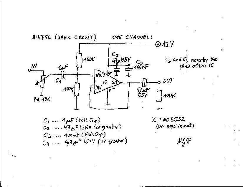

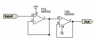

That is exactly, what it shall do. It filters low frequencies out, so that e. g. the tweeter does not have to make movements that could destroy it. It would be nonsense to counteract that loss. What you should do is to optimize the crossover frequencies. Experiment with different capacitor values to find the combination that harmonizes best with your speaker combination. Also attenuate the different amplifier channels so that all speakers reproduce at the same sound pressure level.pra3718 said:But you know this kind of filter losses the singal specially in LOW Frequency.
Start with the woofers unattenuated and the tweeters and subwoofer fully attenuated. Then turn the volume of the tweeters up until you get a harmonic sound. When you are satisfied with the result, turn up the volume of the subwoofer until you can discern the subwoofer as a separate source. Then turn it back down until you just cannot discern it as a different source anymore. Make a test, switching the subwoofer on and off. The sonic balance should not change, e. g. a voice should still sound the same and should not become unnatural, when the subwoofer is on. The effect should be that you notice something is missing, when the subwoofer is off, but when the subwoofer is on, the bass should not sound exaggerated. Without measuring equipment, people tend to adjust the subwoofer too loud. After sufficient listening time it starts to bother and the subwoofer will be attenuated further.
A buffer will not increase the signal. It will only stabilize it, when the load is too demanding. That is not the case with your amplifier.pra3718 said:I found buffer amp which can increase the signal.
If you use an op amp and a passive filter, you already have the components for an active crossover.
I am not sure, if I understand this correctly. Do you mean to say that the speaker is moving all the time? If so, then it is probably the combination of unregulated power supply and rail splitter resistors. The ripple from the unregulated power supply will pass through the upper 100k resistor into the non-inverting input of the op amp, which will deliver it to the input of the TDA. So you will probably have a continuous 100 Hz signal on your speakers. If the signal is strong enough, you should be able to hear it as a humming or buzzing noise. If you don't hear it, it is either too weak, or your woofers are out of phase and the signals cancel each other out.pra3718 said:This circuit is good but the problem is the spekar goes up-down (with OR without) sound.
The cure would be to supply the op amp from a regulated power supply.[/B][/QUOTE]

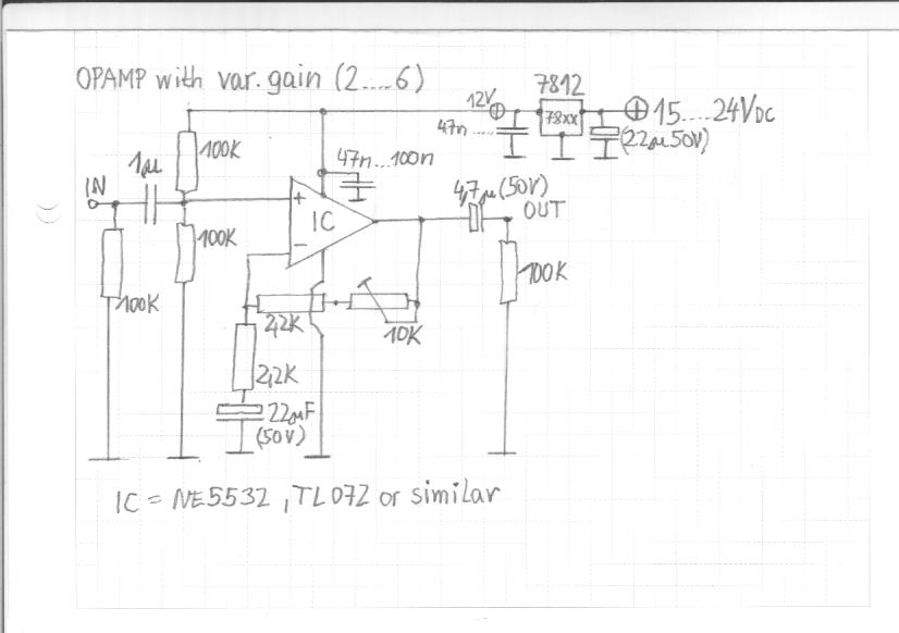

Now I understood that Buffer is useless for me. So I want amplifier which would RUN BEFORE my TDA1554q While serching the NET I found something
NE5532, TDA2320A, LM386, LA4425A, TDA1522 etc.
One of those amp how to use with single power supply ? If you have schematic please post.

pra3718 said:Already you have provided good information on this subject. OPA134 is not available in my place. NE5532 is available & I found buffer circuit as attached picture. This circuit is good but the problem is the spekar goes up-down (with OR without) sound.
The circuit is 12V & my psu is 15V approx. If it is the problem then you are requested to make any required correction to the circuit.
Or if you have better option for increase signal using NE5532 Please post.
hello.
tda 1554q is for use with battery power(12v,cars) or regulated power supply.unreg. suuplies can cause problems.........
the bufferamp has a voltage gain of 1 (doesn't increase the outputvoltage).
the buffer works with e.g. 6v.............to 30v single supplyvoltage,but you should use it with a reg. supply (if you have 15v unreg. s. you may use a 12v regulator,like 7812,78L12,.......).

hello.
this is an opamp with variable gain (2.......to r.a. 6 times) -more than enough.....if not there could be something wrong with your system.
most parts are free to choose..........
7812 is a standard regulator with 12 v out (lm7812.....).you can also use a 7810 ................
the decoupling caps(47n......100n) should be solderd near by the pins of the opamps.
adjust the gain with the 10k trimmpot to your system.........
greetings...................
