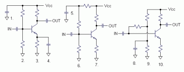

The basic concept is that wire has resistance, however small. If two currents share a wire there will be a voltage drop along the wire that is related to the sum of the currents. Problems arise when this sum voltage is not desired or not anticipated by the designer. To avoid it, two separate wires should be used, one for each current flow. If a wire must be shared then use very low resistance wire or braid.
Taken to the limit, you choose some point in your amp's box - and run every 0V connection from every point in your circuit/psu/input and output cables to this point using separate wires. The point should be as compact as possible - not a length of wire or a ground plane. This ensures that two circuit's currents will not share the same wire and inadvertently create a sum voltage drop across the wire. Obviously, choosing the location of this point to minimize the length of the wires is advisable.
This is particularly important in power amps because it is surprisingly easy to end up mixing the speaker current with the input signal current if your are not careful OR adding the speaker current to the psu rails. These sort of things can result in oscillation or a mysterious mains hum at the speaker. If an amp is wired properly and the basic circuit is sound you should hear none or very, very little hum at the speaker even with your ear stuffed into the woofer. With no source connected, audible mains hum at the speaker is a dead give-away that something is wrong.
http://www.diyaudio.com/forums/attachment.php?s=&postid=498232&stamp=1098624936

I bring back this old thread since there's a puzzle to which i can't seem to find any explanation (good enough). Attached are schematics of few simple one-transistor amplifier circuits. A good procedure is to separate signal and power grounds from each other but the question is which is which?
With my logic, the supply filter capacitor ground points (1 & 5) belong to power ground and all emitter resistor grounding points (3, 7 & 10) belong to signal ground, as well as the emitter bypassing (4). Is this correct? How about the other ground points that are related to bias set? What are the common procedures?
Teemu K
Teemu K
Hi Teemuk,
you have correctly identified the two power grounds (1 & 5).
All the others are signal grounds.
8 might be interpreted as a decoupling but it is connected to the input and you need the input as clean as possible. You do not want to inject any buzzes there.
