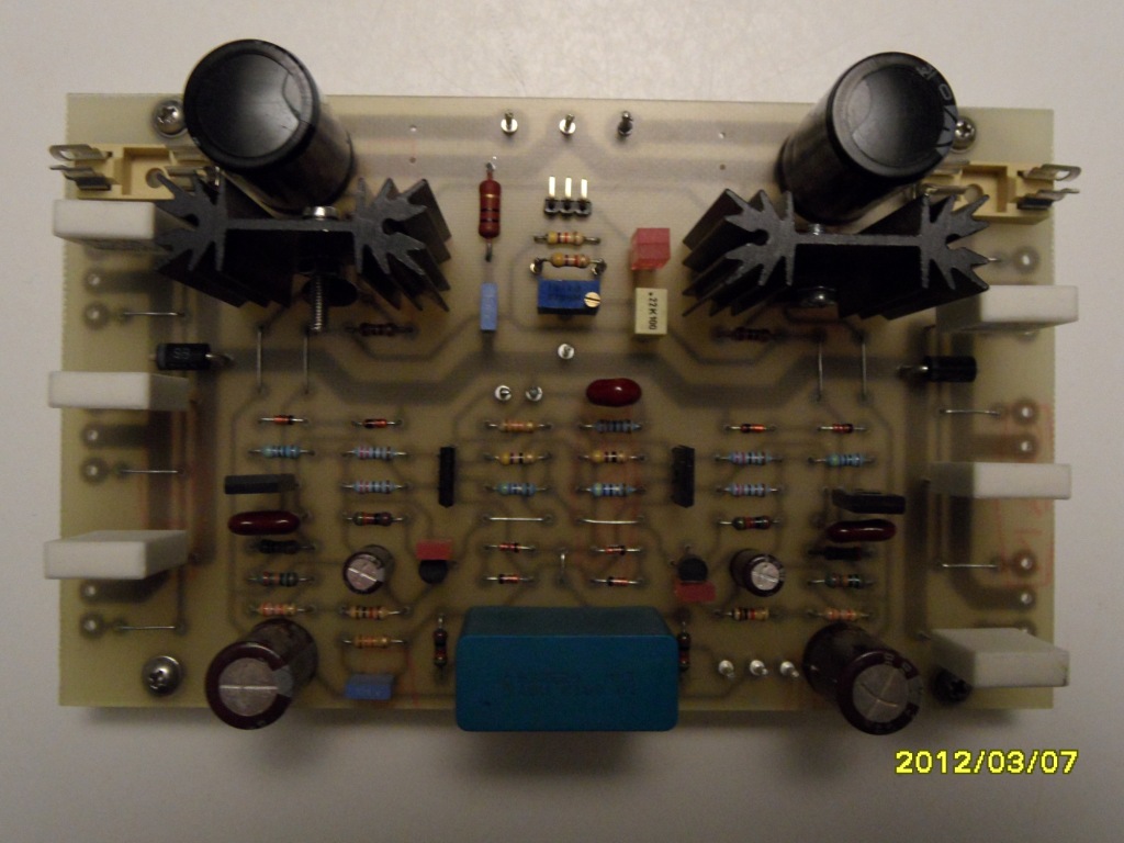

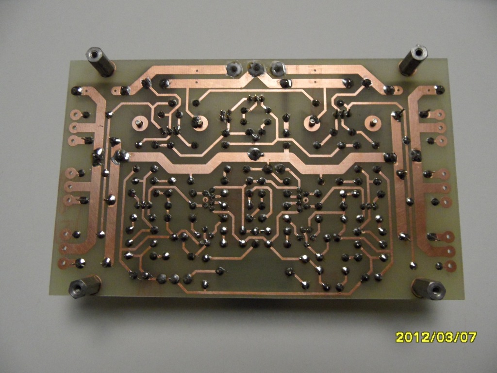

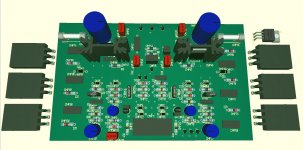

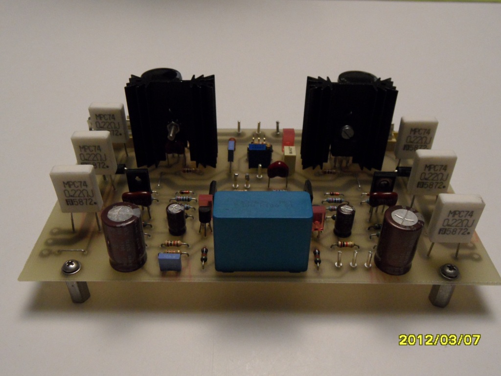

After blowing again 1 pair of output devices, I decided to make the final board layout to test further instead of having two boards connected to each other with wires. (two boards are; front-end + VAS, and Drivers and OPS)
Made the board yesterday with the toner transfer method and soldered all components on the board today. 1 pair of OPS will connected tommorow when all voltages and currents are ok.
