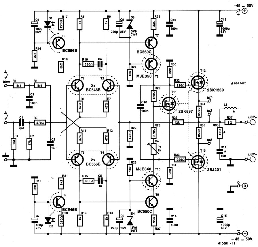

Those differential pairs were just crying out for current mirror loads, so I added them. The THD at 20kHz is about a quarter of what it was before. The frequency response is fine for a sub amp, but I opened it up a bit for general purpose use. With some tweaking and optimization of values there might be some more improvements forthcoming. 😀
Another thing - it might be better to use a MOSFET for thermal tracking. I'm not sure that a BJT Vbe multiplier goes well with MOSFETs. Does anybody have an opinion on this?
As designed , it wont work correctly , moreover with a darlington VAS.

The balance in the original circuit is quite good. It was more like an itch that needed scratching, but current mirrors does seem like a good idea. A current mirror in an LTP increases open loop gain by 6dB or more and doubles the slew rate. 😎Interesting Ingenieus,
How did you conclude that the diff pair needed the current mirrors? Do you compare the collector current in both legs, or what do you use as trigger to go for a current mirror?
Concerning the vbe multiplier, as I explained in post #1 ,I will be using a 2SK2733 mosfet, but due to the lack of the spice model for this,...
Most MOSFET amps seems to use BJTs for temperature compensation. The Crescendo Millenium Edition is one of the few designs that uses a MOSFET. As far as I know anyway.

As I understand it this doesn't work:
The current mirror in my post above is the solution suggested by Bob Cordell.

The current mirrors bring improvements but a reproducible
implementation is not that trivial.
Surely that Bob s solution works although that s quite a lot
of complexity.

I believe the current mirror only becomes effective, if both sides of the LTP are fed and loaded symmetrically.
I further believe that this may be the reason that resistor loading is preferred to mirror loading when sound quality is uppermost in the priority list.

I agree that mirrors will be more effective objectively when there is symmetry, yet it also works in designs, objectively and subjectively where there isnt symmetry involved, a good example is Lavardin which uses highly tweaked Lin circuits and huge amounts of feedback which of course is another big no no but yet their amps sound superb.
Are you agreeing that I am allowed to reach all those conclusions?

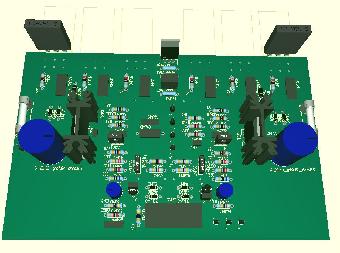

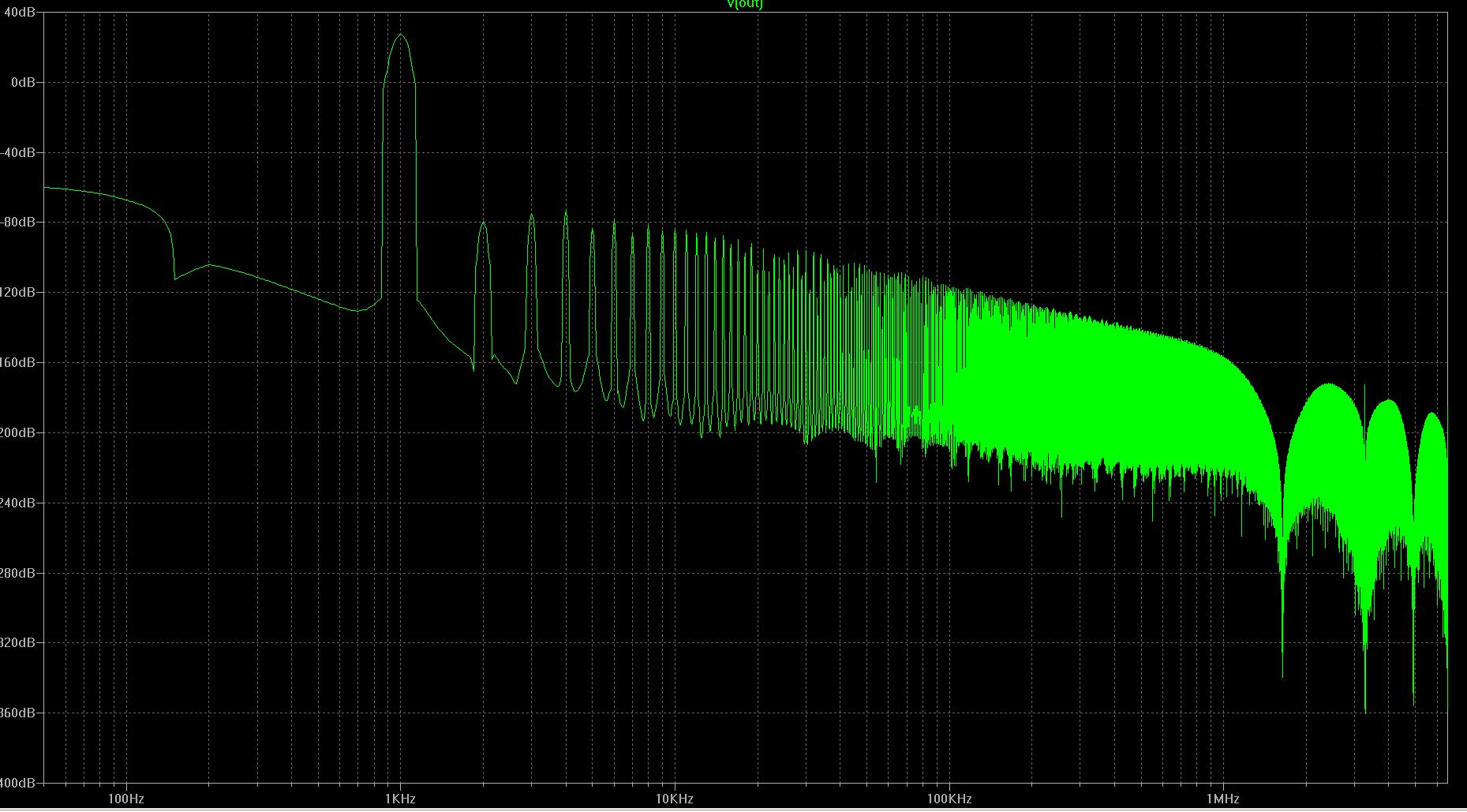

time for a review
I've choosen for the standard VAS and a driver stage. The cascoded VAS doesn't bring any advantage at the low frequencies for a sub amp.
Please have a look at the attachments:
1 Schematic
2 Phase margin plot, phase margin is +-84°
3 PCB layout (orange = ground)
4 PCB in 3D (done with Target 3001, max 250pins, that's wy only 2 output devices are drawn)
5 FFT plot 1Khz at 150Wrms in to a 4Ohm Load
All comments are welcome.
