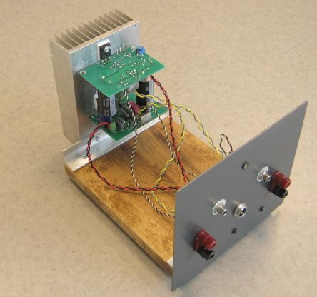

Added bias trim pots, tweaked bias, and ambled off to the living room to watch a movie while the amp simmered. Bias is stable, involving tweaking the initial bias current level a bit below the desired value. The heat sink is the absolute minimum size for the app, and reaches about 55C. Heatsinks USA probably has an extrusion profile that will do better, should I decide to reproduce this thing.Meanwhile, I need to figure out the rest of the packaging.
The amp has been playing in my dining room most of the aternoon, powered by a bench supply, tickled by a Discman, and driving a pair of Planet 10 speakers that are efficient enough to do it justice.Last played - Isao Tomita's "Snowflakes are Dancing" - gorgeous. I'm dragging into work again to check out drive and actual clipping levels, to see if I'm getting al the juice out of it that I possible can.

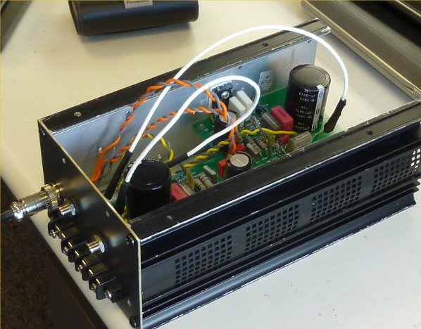

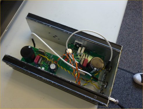

As I said previously, I persuaded/browbeat (however gently) a colleague at work to construct another instance of the "Amp Cramp" with appended pots for bias and centering adjustment. This 1) proved out the modified design, and 2) served to infect a friend with the audio construction bug.
I helped out with stuffing. mechanicals, and debugging to move the project along. The amp was built inside a chassis that was originally home to a smallish Acopian linear power supply. This came apart readily (8 screws, sliding sheet metal panels), was easily eviscerated, and had two side panel heat sinks that I was gambling were suitable for this project if I mounted the two channels on opposite side walls.
The pictures show an interior view, and the busier end panel, fitted for RCA inputs, a 2-pin microphone connector for power, and (already in place) a barrier strip for outputs.
The amp came up with no issues powered by a bench supply, and subsequently with a 24V/2.5A adapter scored from local surplus.
Audio testing was quite satisfactory, and we were both well-chuffed.... Speakers are next on the list, though likely something from a thrift store.
