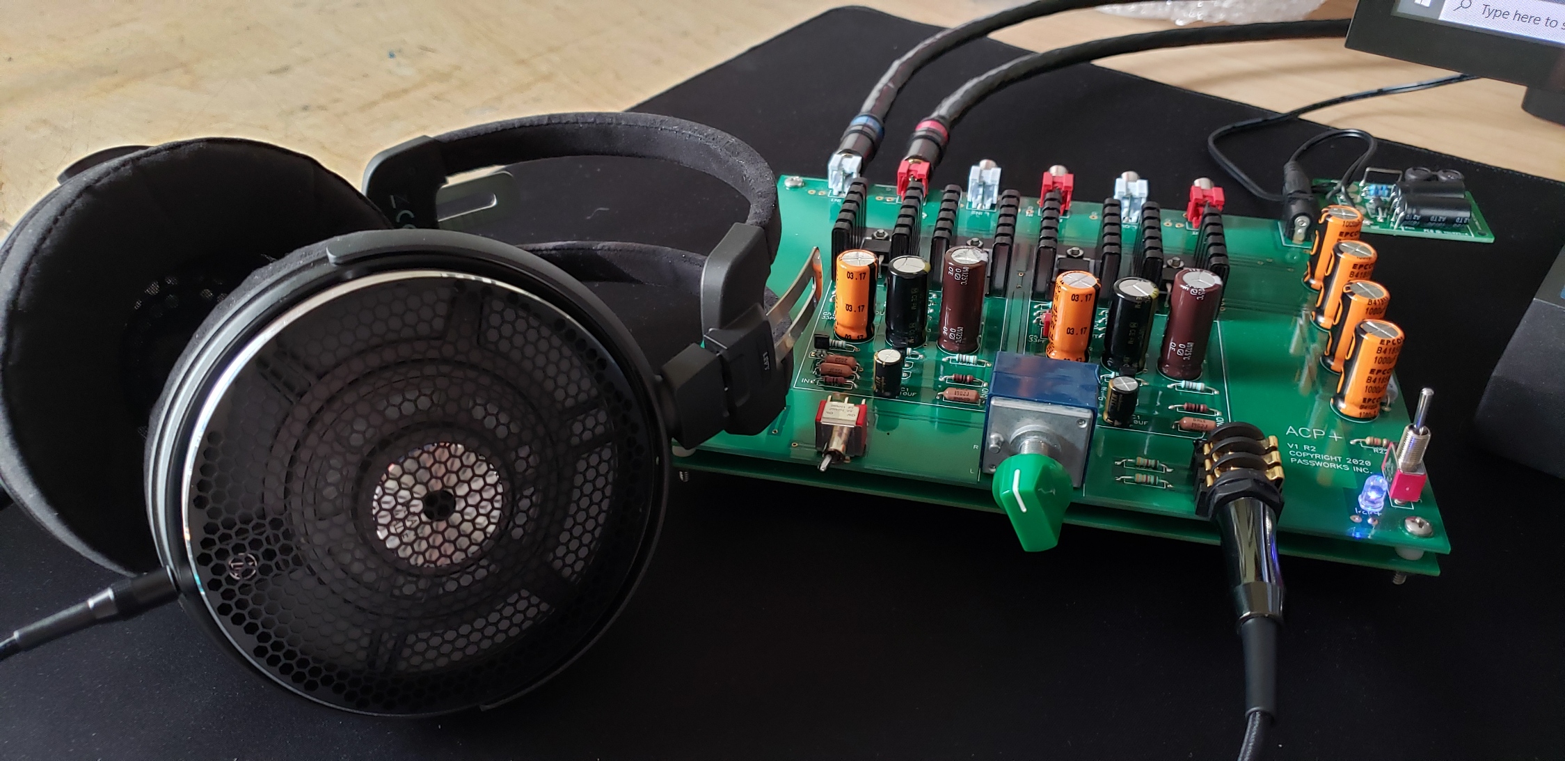

Yep, turned out it was the RCA out connections. Swapped in a tighter fitting set of cables and all's well. Probably should've tried that first. Oh, well. Thanks guys.
Hmm —. Maybe the headphone Jack is not properly switching the output to the RCA line out sockets?
Happyjack
Happyjack
Thanks, Happyjack. No further troubleshooting required, the ACP+ is working great now. And all it took was a tighter fitting set of RCA cables. Can't ask for a simpler fix than that, I reckon. Cheers

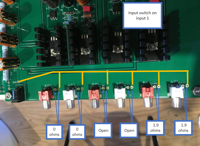

RCA Output question; I get a short when measuring resistance between L1 (+) & (-) and L2 (+) & (-). I was expecting an open. Does anyone know why they are shorted? For reference, the outputs on the LX Mini Crossover I'm also building are not shorted.
Clarifying labeling from original post. R Out and L Out are short when testing between the two little circles (+ and G). Testing the same locations on both sets of inputs are 1.9 ohms, or open, depending on the selector position.

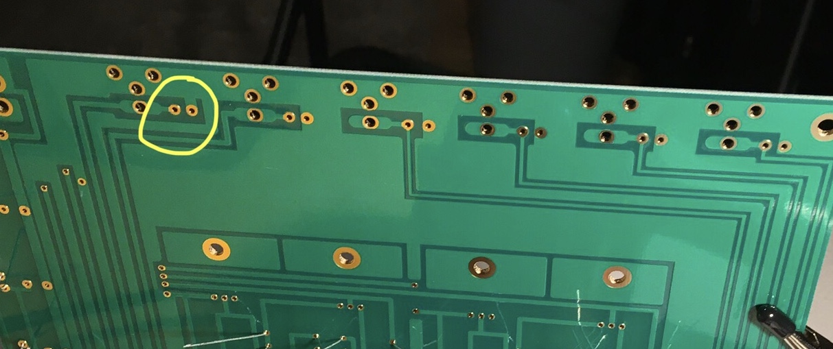

When looking underneath, every connector except R Out looks the same. The R Out connection + and - appear to be connected underneath, whereas the other 5 rca connections are not.

The thru-holes in your circle are connected like the others. One on the right is connected to ground plane; one on the left connected to a trace headed for the other end of the board.

Do you mean the ground plane on the main PCB (all the connected grounds) or the bottom blank PCB? I still don't understand why the outputs (+ and -) are shorted when the inputs are not. How does the signal get to the amp if the outputs are shorted.

what is shorted?
and - pic is more useful if you take it from upper side - silkscreen shown

The main PCB ground plane, though depending on how you construct it (metal stand-offs) it’s also connected to ground plane board.
Also, a reminder that there’s a switch built into the headphone jack. If you have phones plugged in, you’ll drop signal to RCA out.

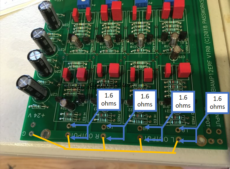

Yellow means continuity between all points. Resistance measurements in blue. I have the LXmini crossover as a comparison, each output has 1.9 ohms across the + & -. I expected the Pre Amp output to have some resistance across the output + & -.
two scenarios:
- your build is wrong
-your DMM is broken
ACP output - it must show ~33R, once when you fill that output cap with probes/DMM, when cans are pulled out
ACP input - it must be ~20K (value of volume pot)
https://www.firstwatt.com/pdf/art_acp.pdf
dunno for LX, lazy to search for schm, but 1R9 sounds wrong

OK, I was using the Fluke wrong. I had it on the continuity measurement setting instead of the ohm setting. The outputs are 32 ohms, the inputs are 20k. The LXmini outputs are 10k. Problem solved. Sorry for any confusion.
