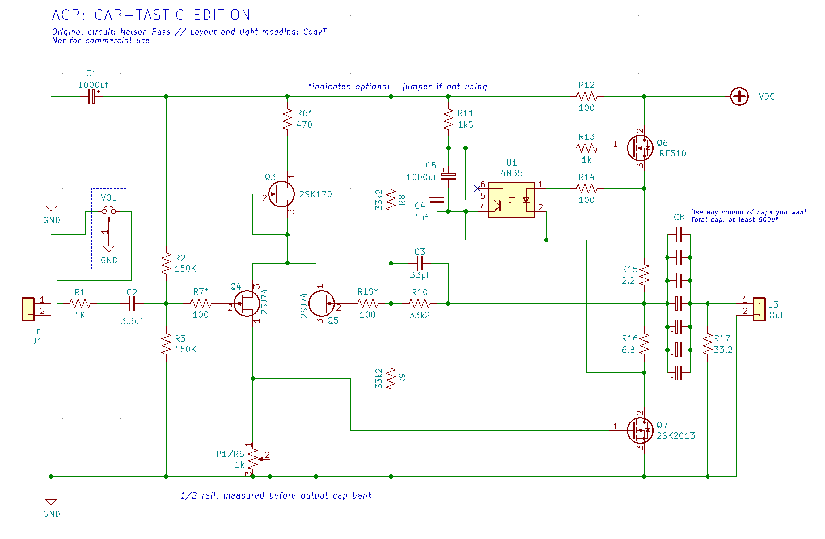

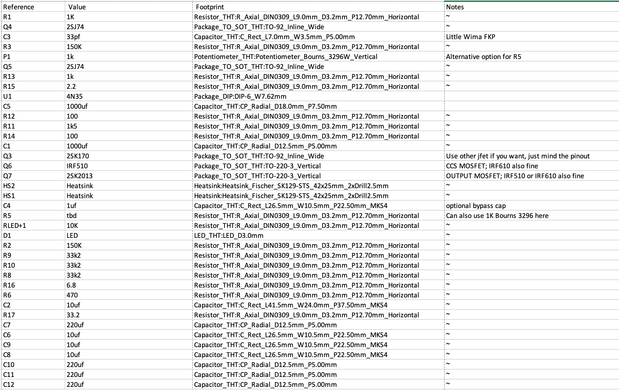

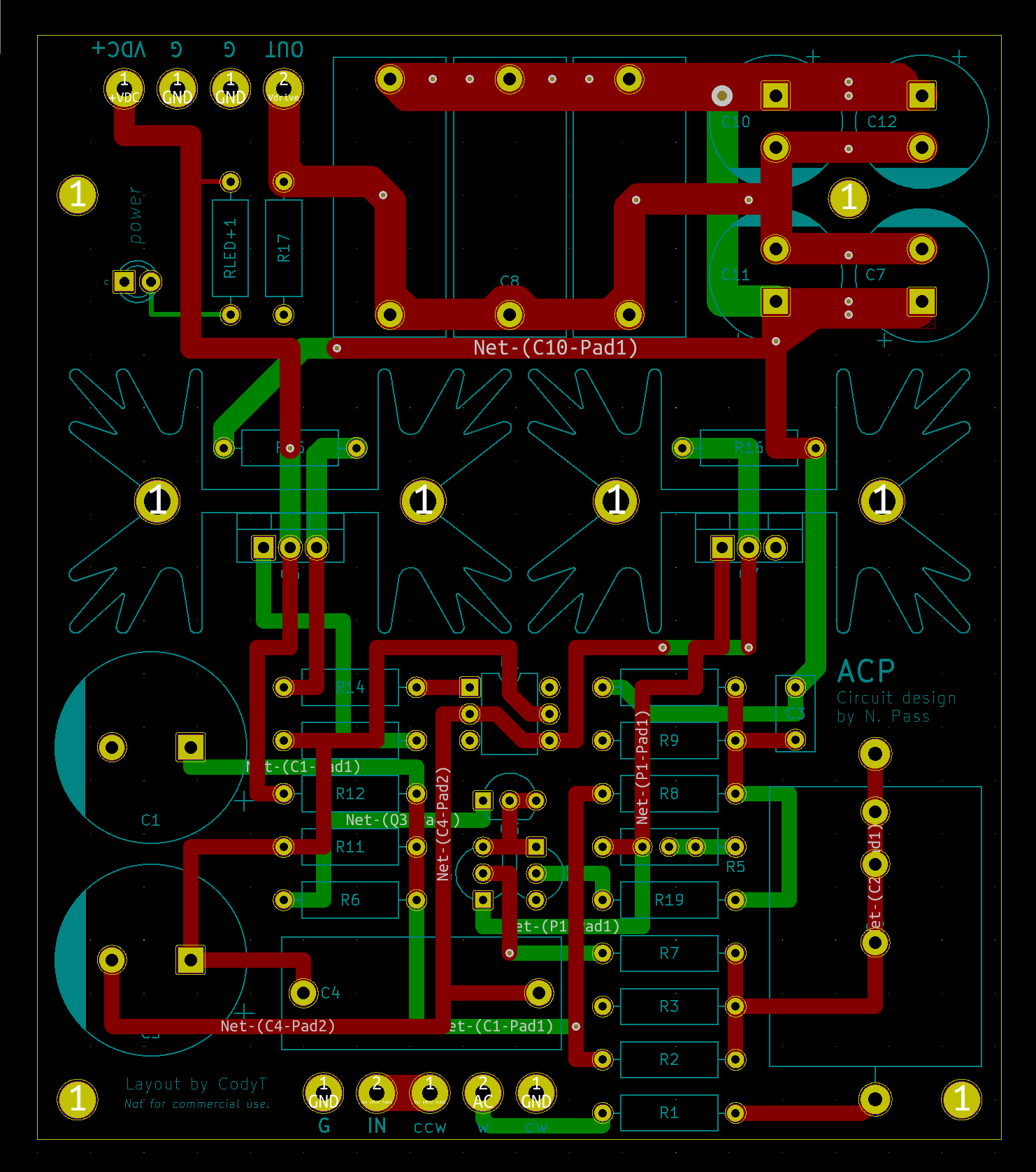

The past few months I've been slowly learning Kicad and doing some PCB layouts for fun. I originally decided I wanted to make a dual rail (bipolar supply) version of the ACP. It turned out really nice, but its not an ACP anymore. ACP is one of my favorites, so I decided to take a shot at a more 'by the book' version, which is what you see here. It turned out well and sounds fantastic (just like the original).
For the most part its the stock circuit, though I did tweak a few things:
- Added some gate resistors to the LTP (ode to ZM 🙂)
- Swapped a K170 for the J113 (got 'em, so figured I'd use 'em)
- Added space for bigger input cap
- Added options for output cap (cap-tastic, amirite?!)
- No headphone jack
Like other little projects I've done, I made this to accommodate parts I had on hand and with my own preferences in mind. That said, I at least wanted to offer the gerbers in the event someone else shares my preferences and wants to build with them.
I've built a copy and had no problems, but I'm a greenhorn amateur so proceed at your own risk 🙂
*Edit* If you look at the traces pic, you'll probably notice a few spots that appear to have no connection. The board has a ground plane on the bottom side, which is where they attach.

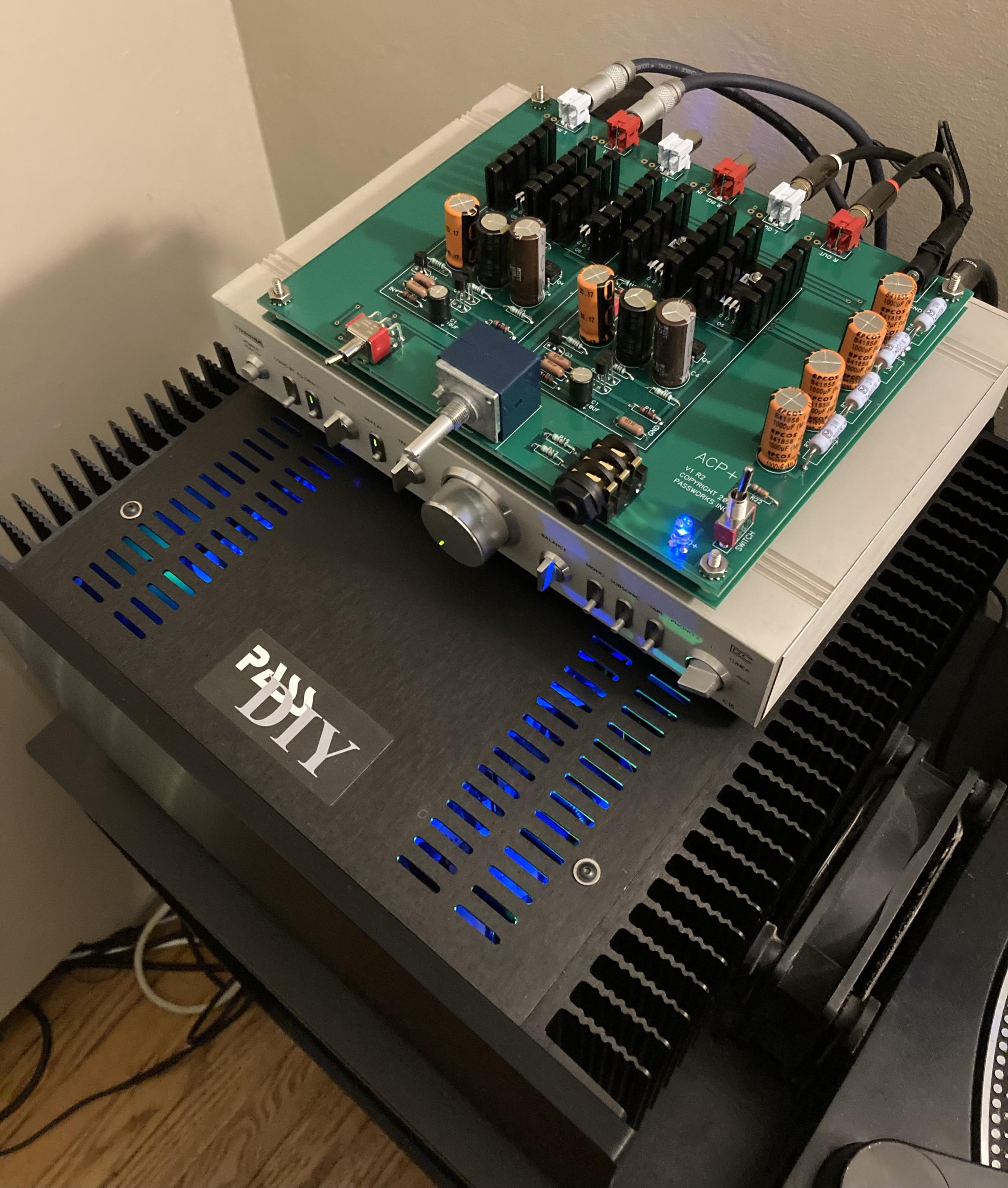

That’s very nice work, codyt! Well done.
I finally put together my ACP+ this afternoon. Sounds lovely so far.
No hiccups or problems with building and testing it. Excellent kit, documentation, and tips from Nelson and the diyAudio store gang. Thanks to you all!
Bare PCB stereo components are cool. 😀

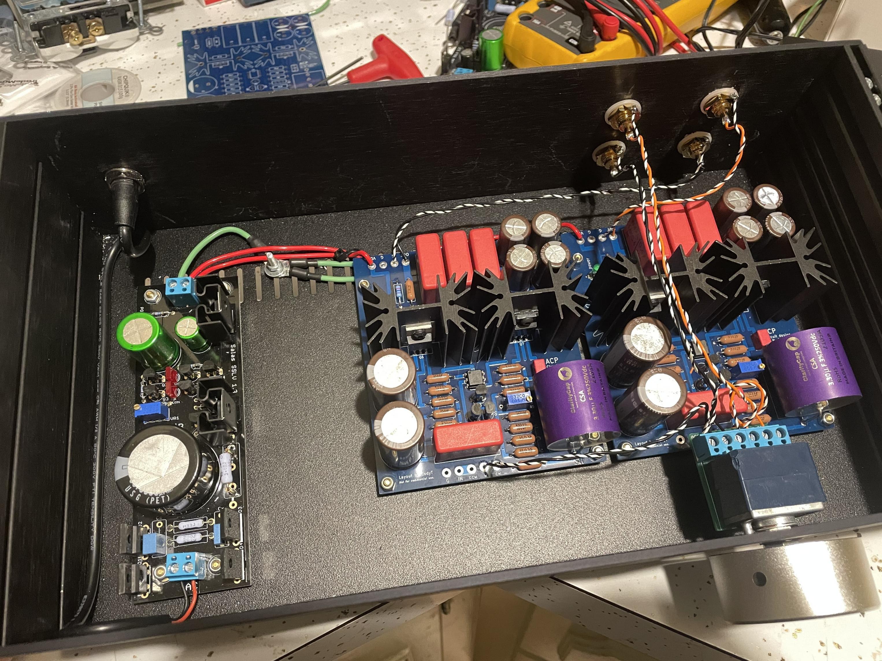

I've run into a bit of an issue using my just completed ACP+ as a preamp. Depending on the amp I'm using I either get distortion out of both channels or no distortion but sound out of only one channel. (An F5, in the first instance; an ACA, in the second.)
At all the test points mentioned in the First Watt article my ACP+ is right where it's supposed to be. And, more importantly, as a headphone amp it's performing flawlessly. But as a preamp... weirdness. Naturally, as a relative newb to all this, I'm perplexed.
Does anybody have any suggestions to offer? I'd really like to get this thing up and running as a preamp to see how it compares to last year's Christmas present to myself, a Korg B1. (Inquiring minds want to know, and all that.)

Hmm, headphones work fine... R16 and R17 are 33 ohms? Poorly soldered RCA's? RCA male and female connections not playing nice? I've had that happen several times over the years. I'm not a huge fan of RCA connectors in general.
Yes, R16 and 17 are 33.2 ohms. I suppose the RCAs are a possibility, two or three of them did go wiggly on me and I had to reflow the solder to get them to set down flat. Do you suppose it's possible I damaged the things in the process?
Well maybe. If it was in front of me and thought it may be bad / damaged RCA's I would temporarily wire around them and see what kind of result I got. (Actually I would probably take it to work, feed a sine wave in and trace the signal with an o-scope on my break time) I guess that's cheating..
