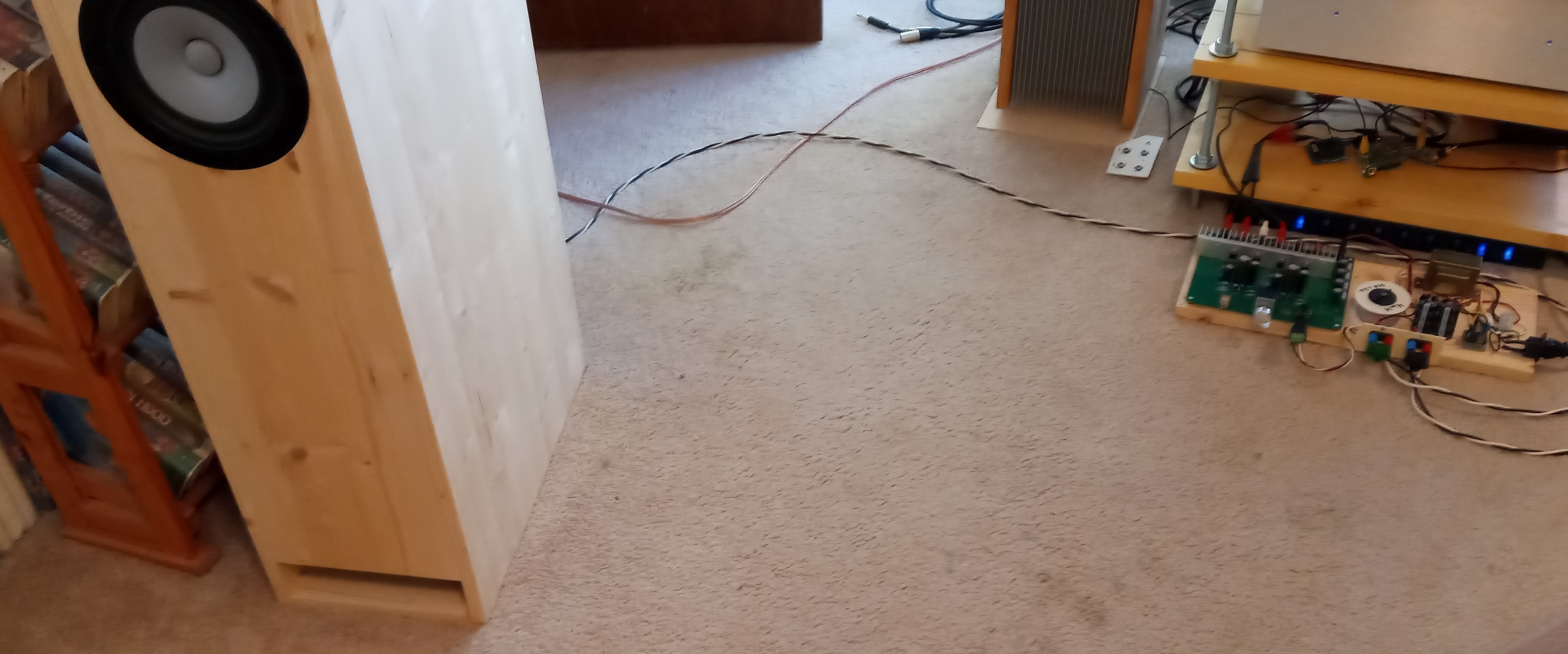

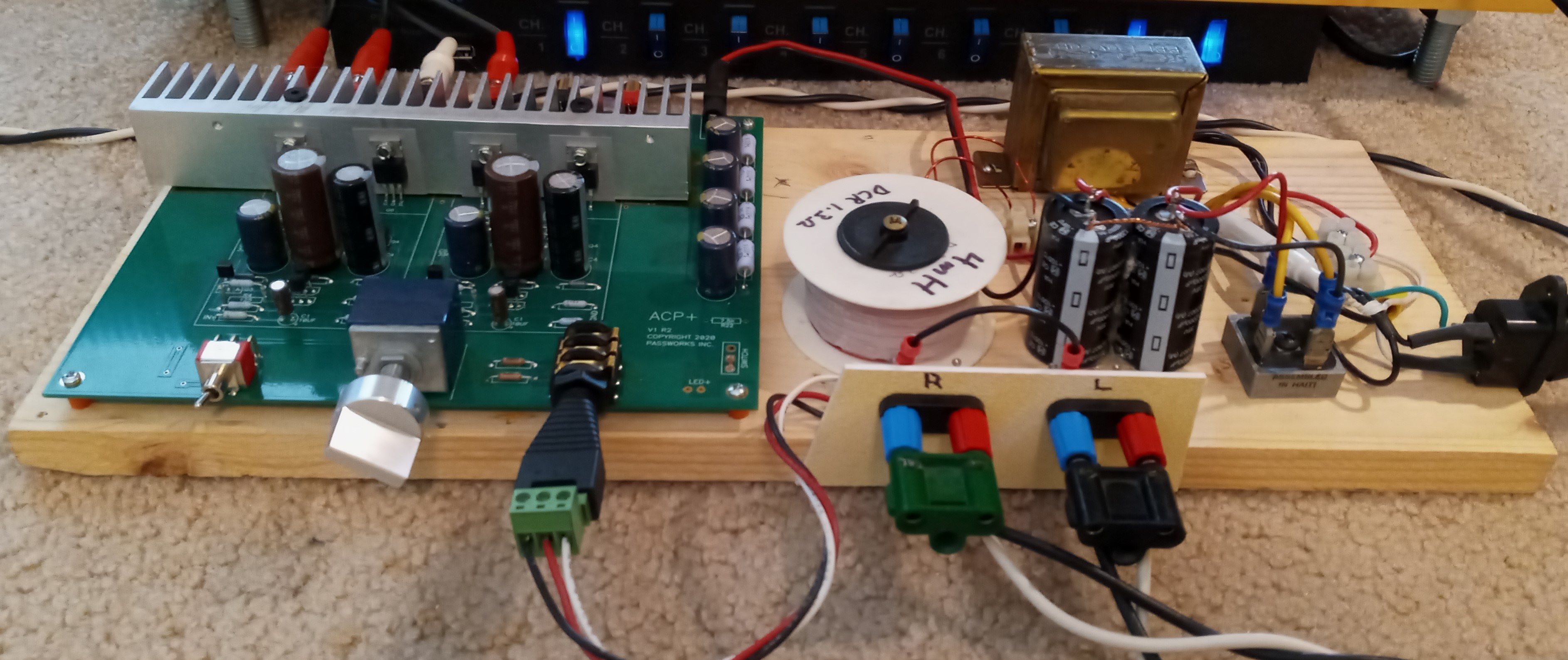

Oh that Papa, he's always provoking me into trying things I never would have thought of on my own. Towards the end of his ACP+ article he's showing a picture of the ACP driving some speakers. I had been wanting to give a one watt amplifier a try and thought... hey this is about a watt... well almost.
So I built it without modification to start and hooked up my speakers. It worked ok but very low power and not much low end.

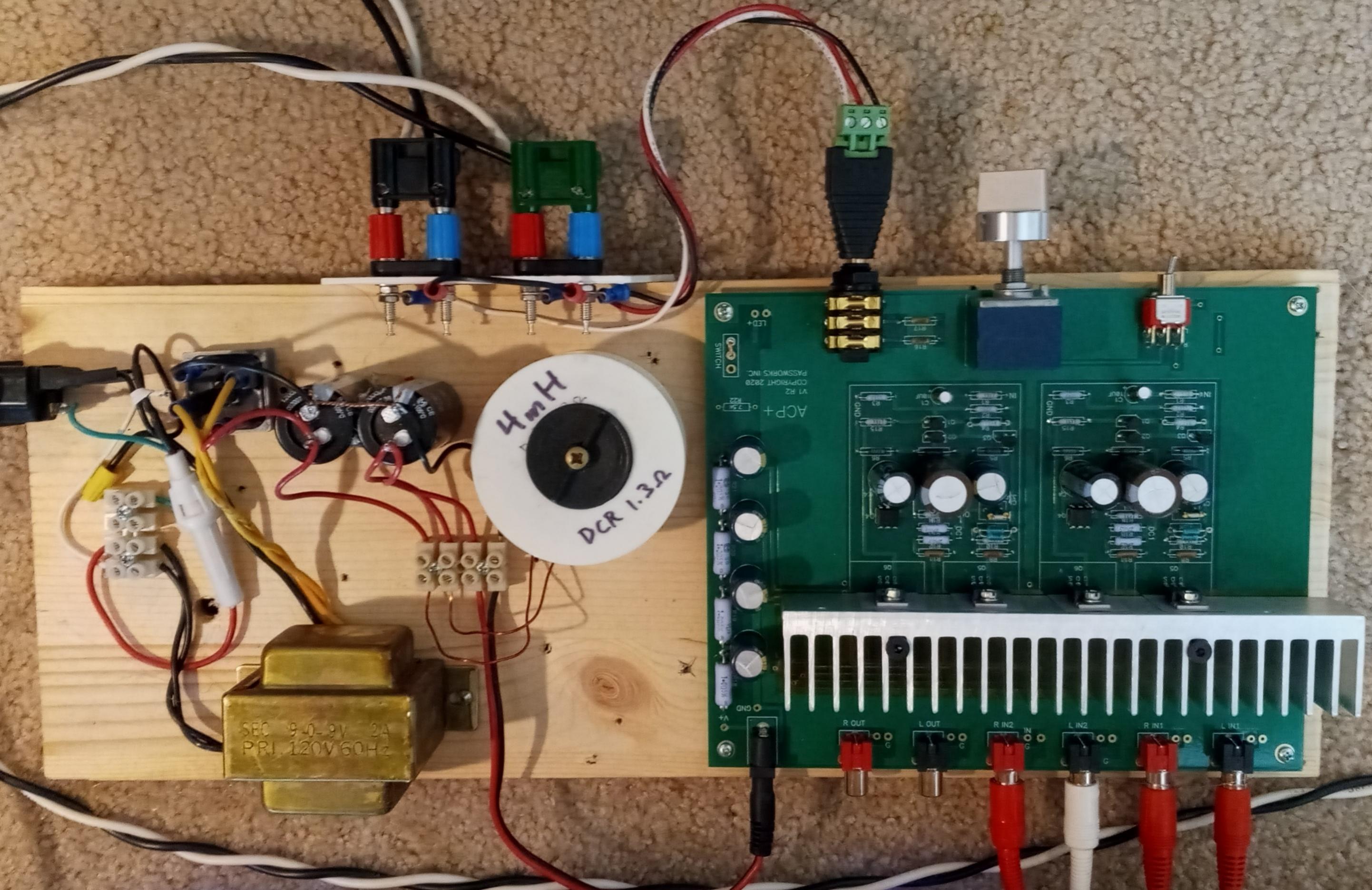

What if I beef up the power supply and crank up the bias some? Thankfully Papa left ample room for beefing up the heat sinking.

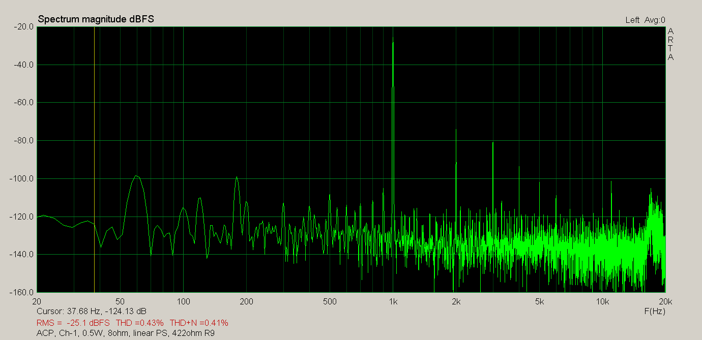

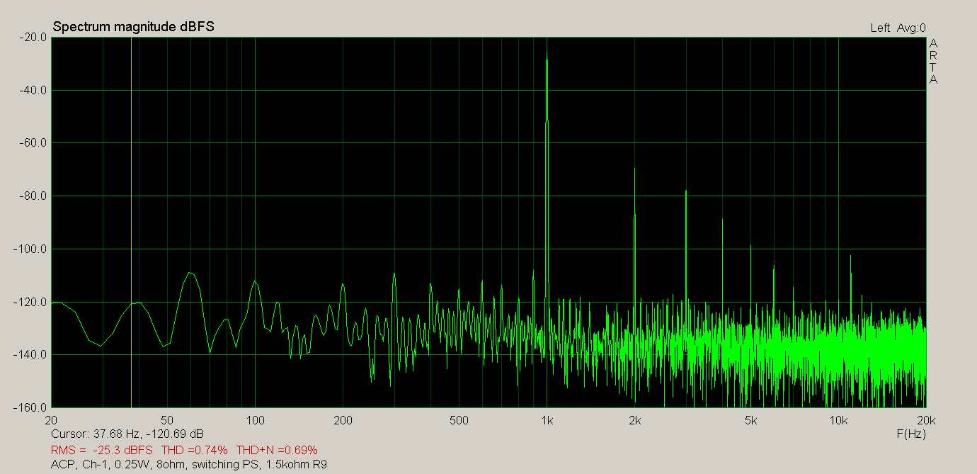

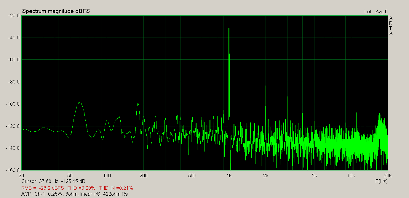

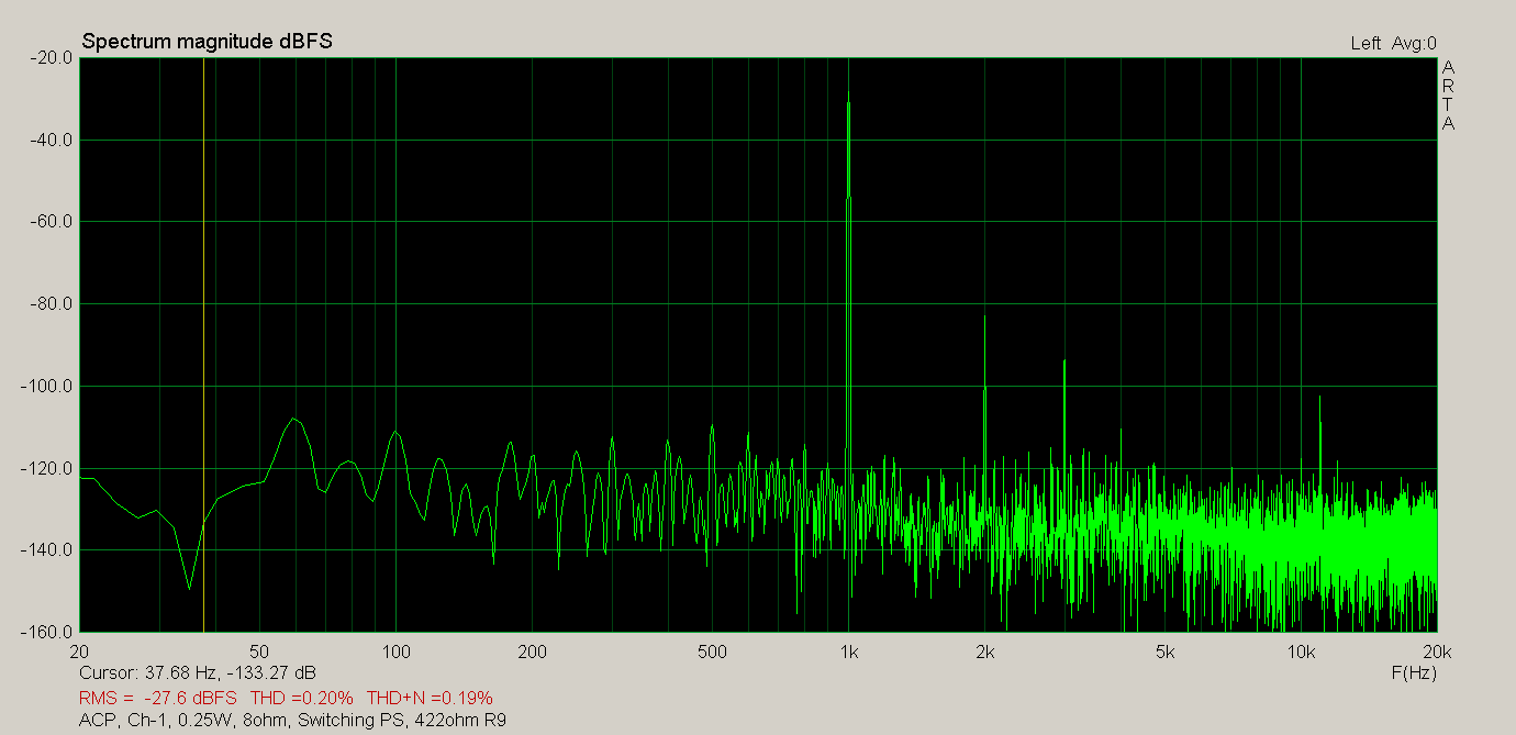

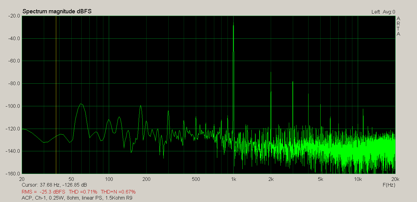

So here's the distortion profile with switching power supply, linear 2A power supply, R9 at original 1k5 and R9 at 422R. Power supply differences don't show up in these spectrum but the bias differences sure do. Beefy power supply helps the low end and at higher power.

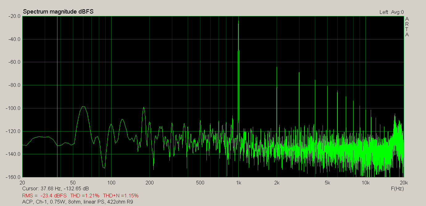

So how much power does the ACP+ have? The rest of the spectrum plots are all with the higher bias and linear PS. It makes it to about a 1/2 watt and still sounds pretty good. Perfect for light listening. :cheerful:
3/4W distortion becomes audible. 🙂
1W it starts sounding not so good, higher ordered harmonics all the way up. :no:
I was running fan on the original little heat sinks, this bigger sink will still fit in a 1U chassis, no fan. Probably will get a little toroid transformer to get it all in one chassis.
My favorite use is still as a head phone amp :hphones: , but now I have a totally versatile Pre/Head/Power amp...

Not going to make much difference. That trick was more about Nelson’s efficient speakers. 😀
Mine are 92dB, Markaudio 12P. The point being it helped lower the distortion profile to get it to a usable 1/2W. My normal listening levels are at about 1/2W and yes I can hear the difference.
I just wanted to measure for conformation of what my ears were hearing. :nod:
