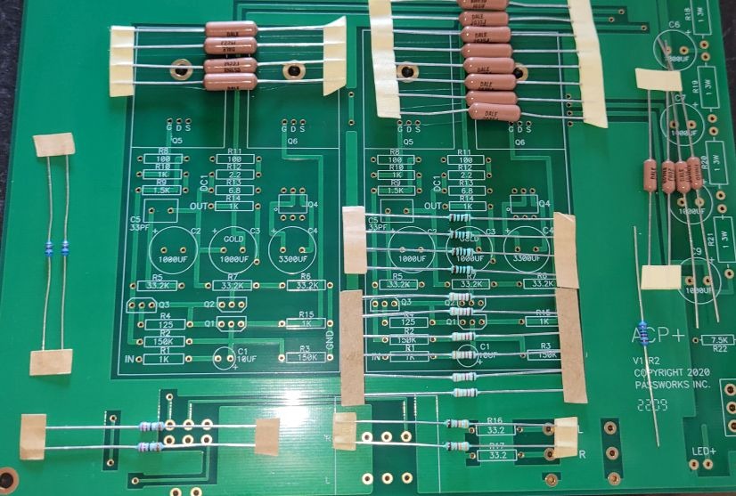

I received the kit from the DIY audio store today.
The JFETs are quite well matched.
The IRFP610 are not matched. Is that OK?
The composition of the resistors is very strange.
Some are RN60 1W and fit well.
Some are simply metal film.
Some are RN65 (3W ?) (1k, 150k) and just too big to mount them properly.
In my opinion, R13 (6R8) is way too small with 1/4W.
Why are the resistors put together in such a strange way?

I think your FETs are OK. RN65 is 1/2W military, 1W civilian I believe. But ya I agree, the resistor choices are quite odd. RN65 is fantastic, I think companies like Mark Levinson use a trillion of them... But CMF55 or RN55 would have been much more suitable on this PCB. I used my own Panasonic MOX resistors at R12 / R13.
