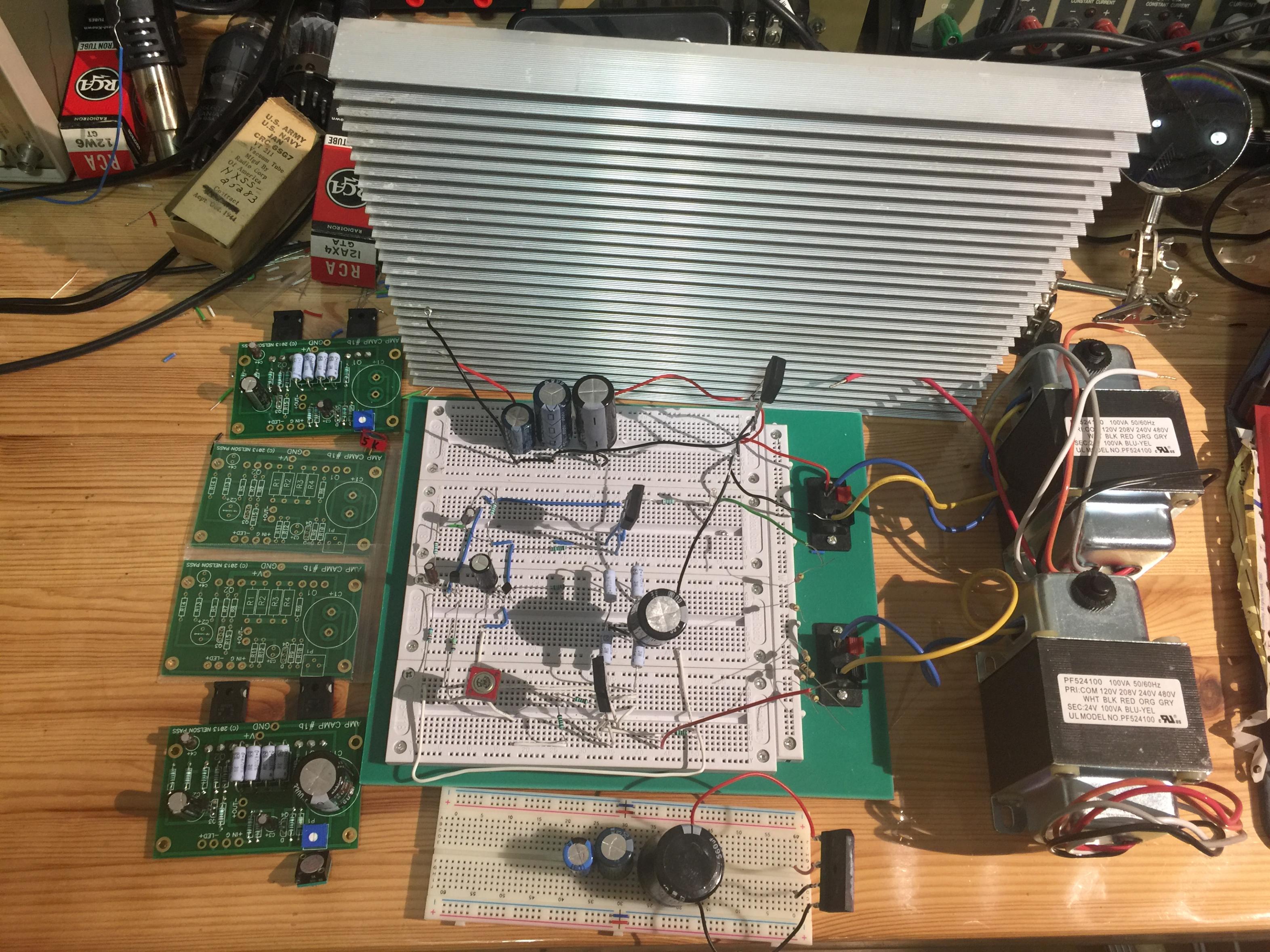

Im building it on a breadboard to turn in as my class project, also build two linear power supplies. The heatsink I get from my job site they throw away in the power supply boards. The Transformers I use at work for HVAC that will be my source to build power supplies.
I got two extra ACA PCBs to do the MODs on after I build my first I will use then to bi-amp speakers.
