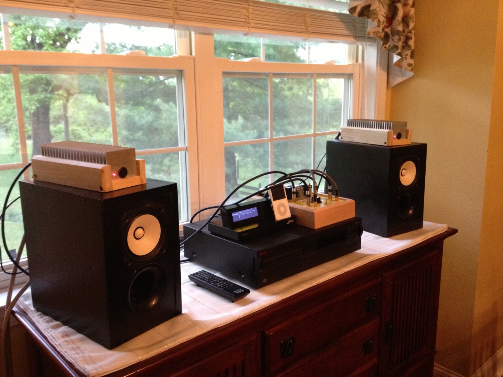

Hey all,
I purchased PCB's for the ACA back when they were in stock and stuffed the board from the parts list. I just bought two chassis now that they are in stock. Now I'm stuck without all of the connecting parts- standoffs/power button/i/o's - and I was surprised I couldn't find a parts list for those items. Of course I can figure it out 1 by 1 after painful hours on DigiKey, but it would be really nice if we could have a parts list for those items too! Can anyone (DIYAudio) help me out? Thanks! If no, I'll post my complete ACA parts list. I really want to get this thing going this month!
I started to do that but did not finish. I grabbed some comments as I found them and here are the bits and pieces that I found out. Please note that this is incomplete and some of it may be wrong. It may be some help so here it is.
Dayton Audio BPFI-G Fully Insulated Binding Post Pair Gold, parts express has them
Standoffs
855-R30-3000602 Standoffs & Spacers M3 x 6mm HEX 5mm A/F 6mm ML/FML NICKEL
6 mm standoff with 6mm bolt and 3 mm deep socket
M3 hex socket head bolt. Buy these at hardware store, online accugroup, BoltDepot
5mm
10 mm
The RCA/XLR are Neutrink, such as the Neutrik NF2D9 RCA:
Speaker holes seem to be designed for WBT posts:
Power inlet AC scherter 6765
