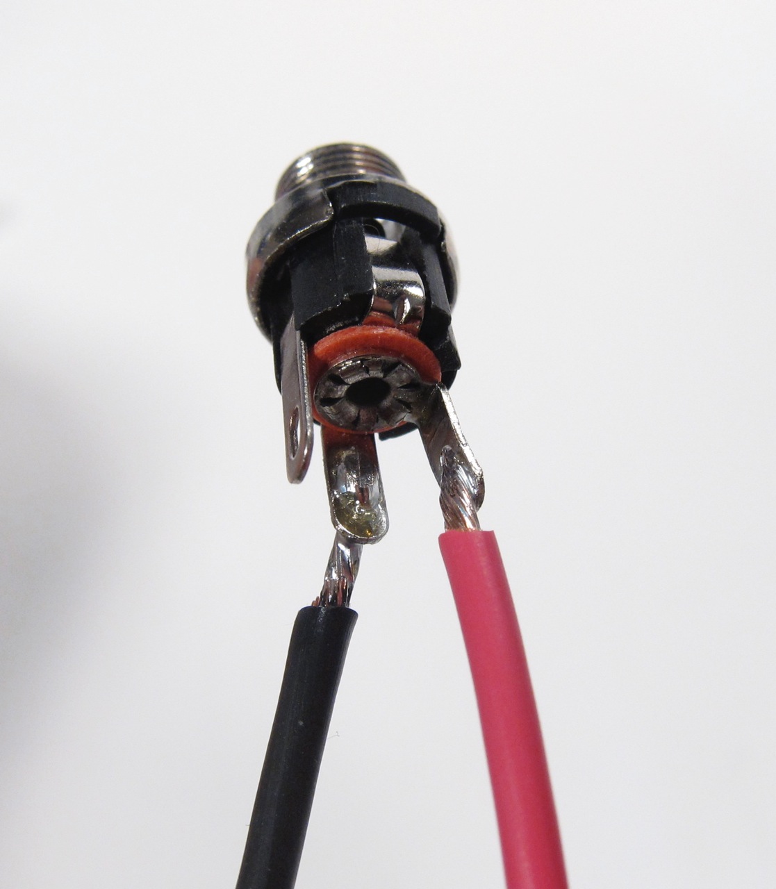

6L6 and Variac, here are some photos of one of the amps, as requested. I'm grateful that you're willing to look at them. When I power up this one, I get a tiny flash from the LED, and that's it. Any ideas?

flohmann - your photos look good. I think the next step is to grab your DMM and make sure you have voltage (+19V, or close) at the +V on the PCB. Red probe on blue wire, black on black, meter set to DC volts.

I find it pretty hard to see, but 6L6's advice to check the voltage at the board input is good. People have mixed up wiring the power jack. One of the tabs is disconnected when the PSU plug is inserted, so the only sure way to know is to insert the PSU plug into the jack and then measure the tabs, or even better, measuring as 6L6 mentions makes sure you have the right polarity right at the board also!
Is it me, or is the ground wire soldered to the wrong tab on the chassis DC jack???
Mike
I think his jack really might be wired wrong. Here's the photo from the Build Guide, and it is correct (as it matches my amps ! ) Red is positive of course.
