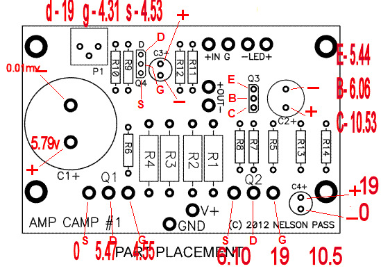

Hi, Im using a 3.42A / 19V laptop power supply on the ACA
I can't seem to adjust the bias over 5v when the pot reaches fully turned!
Any Ideas as to the problem ?

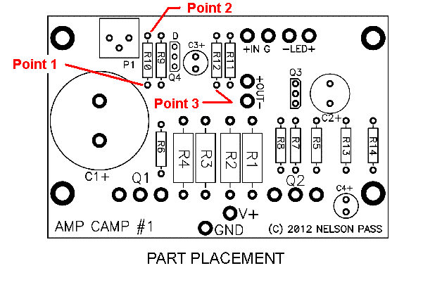

The reason I marked polarity on the diagram was just to make it crystal clear what the polarity was for novice builders. From the voltages posted it seem like something is turning on Q1 too hard. Q2 and Q3 look like they are functioning correctly. It's been my experience that when the IRF parts get static damage on the gate, the part becomes a very low resistance short. That doesn't seem to be the case here.
It seems like the problem is with Q4 or C3. Refer to the diagram attached below. What are the voltages at points 1, 2 and 3?
c2+ = 10.44
c2- = 3.38
c3+ = 4.26v
c3- = 00.2v

It's normal for a delay of several seconds before the ACA starts to pass a signal. There will also be a thump when you turn the power off.
Try this: Adjust the pot so that point 1 is zero volts. That should turn Q1 off and the output voltage should go to about 16V. Take new voltage readings. My thinking now is that Q1 is bad. 🙁

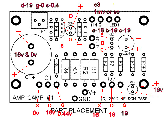

There's a funny noise on the speaker when i turned the pot down to make Point 1 = 0V, also happens on turn on, its hard to explain. a bit like a test tone sweep for a couple of seconds.
anyway now the readings are.
P2 = approx 0v maybe 1mv
P3 = 0v
16v and 0.4v on Q1
Shall I re-take the other readings ? ill do it anyway next
Cheers
Here the pic with the bias all the way down

Those voltage look like everything is as it should be, unless you have a wrong resistor or bad solder connection somewhere. From this point if you adjust the pot (slowly), the voltage at the output should fall and you should be able to stop when it gets near 10V. It may drift around slightly for a minute or two as things warm up.
Looks like we have 10v at drain of Q1, will further experiment tomorrow, what level can the bias be taken up on this thing ? My Sinks can handle it.
