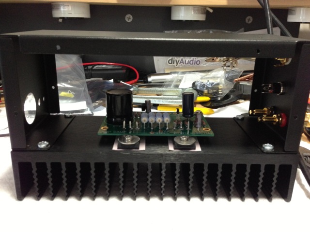

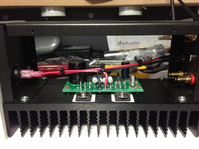

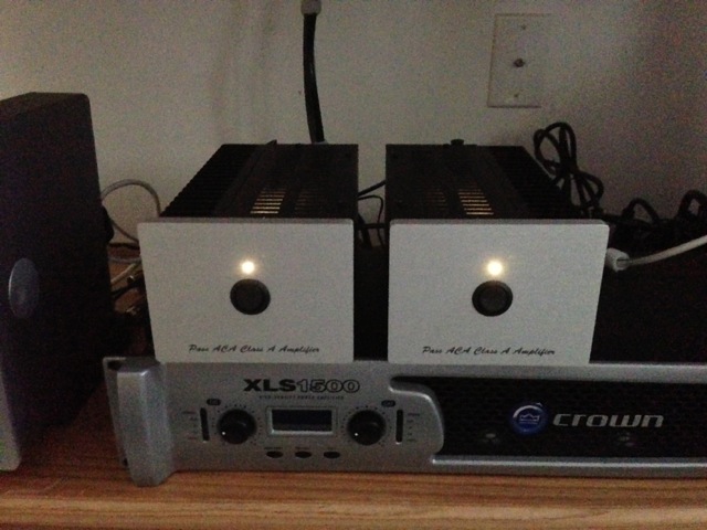

That amp and post is sweet!!!!!!! Makes the project inspiring and attainable for the newbie like me 🙂
12b4a-put captions on each and and you will have a build guide. That's all I do to make one ... 🙂

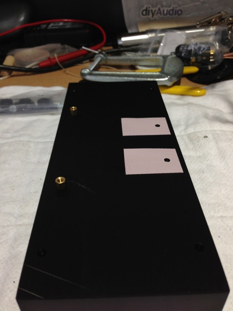

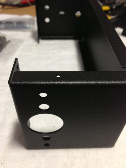

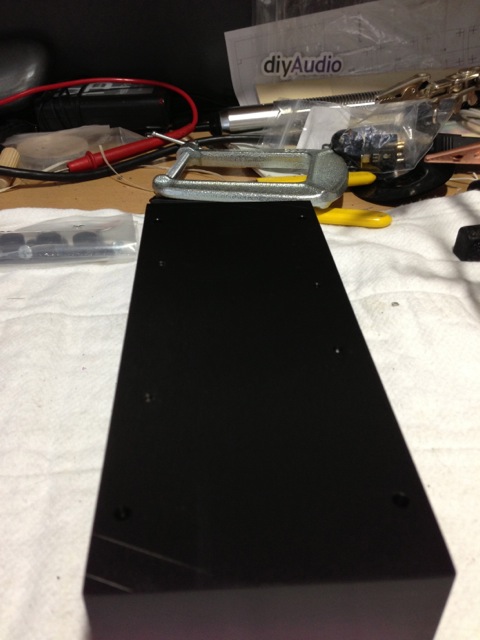

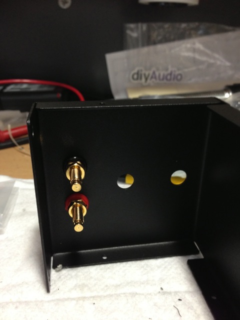

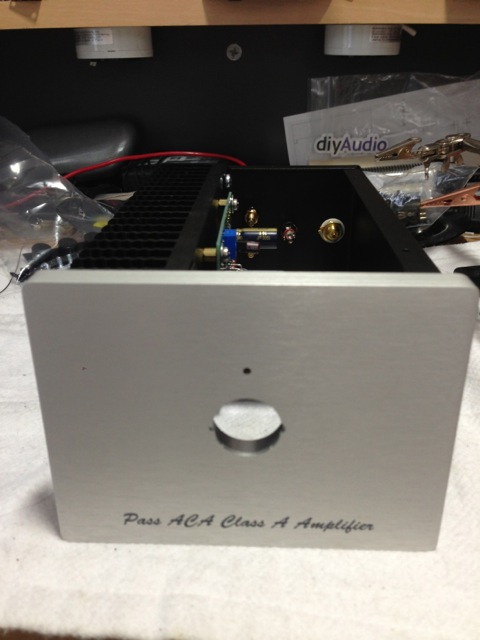

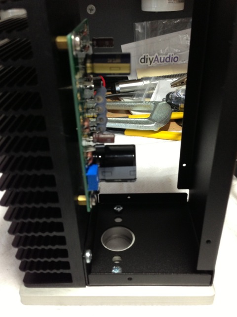

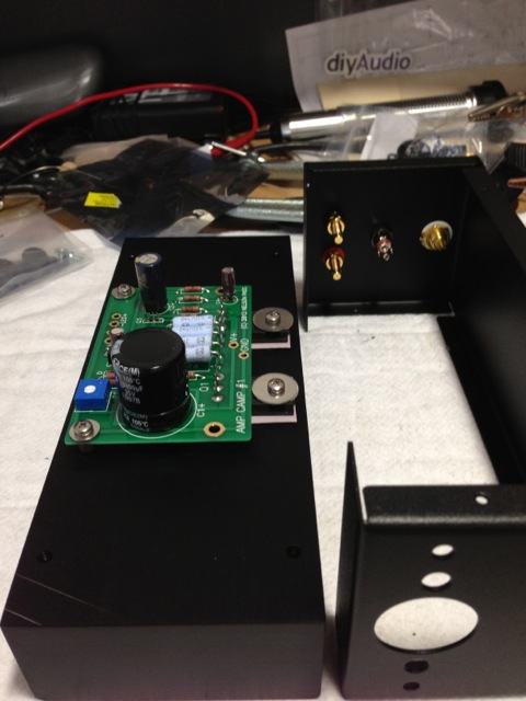

It certainly wouldn't be as thorough (or as well lit) as Nelson Brock's Amp Camp 1 Pictorial Build Guide. I think my pictures might be useful as far as showing one possible method of assembling the diyAudio full ACA kit.

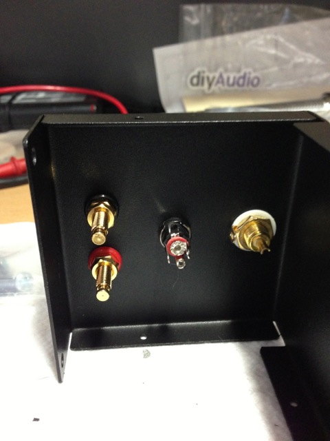

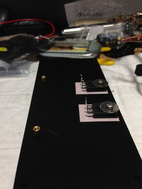

I see you used the larger washers for the transistors, although the build thread has the smaller ones. I was wondering what the larger ones could be used for 🙂. I'm drilling out the speaker binding post holes for banana jacks. I'm not crazy about the DC jacks, either. Have some better ones left over from a PS project. More drilling....
