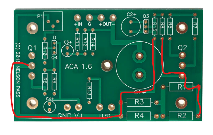

You got most of the way there... taking one channel you measured Q1 Drain at 11.5 and Q2 Source at 12.5 volts. If you look at the circuit you will see that equates to 1 volt across the resistors. Measuring between the resistors can be a bit more accurate as it removes errors due to long term temperature drift.

i do not know how to take the measurement at the 5W resistors or Between Q1D and Q2S.
All good 🙂
I see that now. Thanks for the explanation. One question: looking at the top surface of the PCB, I’m going to guess “between the 5W resistors“ starts at the right pin of R1 and ends at the left pin of R4. I’m just going by the traces and the schematic.

Well I've never built an ACA or seen the real PCB's but looking at a picture what you describe sounds correct.
You measure between any points on these traces. One lead on one trace and the other lead on the other. Depending which around you connect the leads one reading will be negative (ignore the - sign) So on this board you could measure between R15 and R8 and get the same result... just don't short anything 🙂

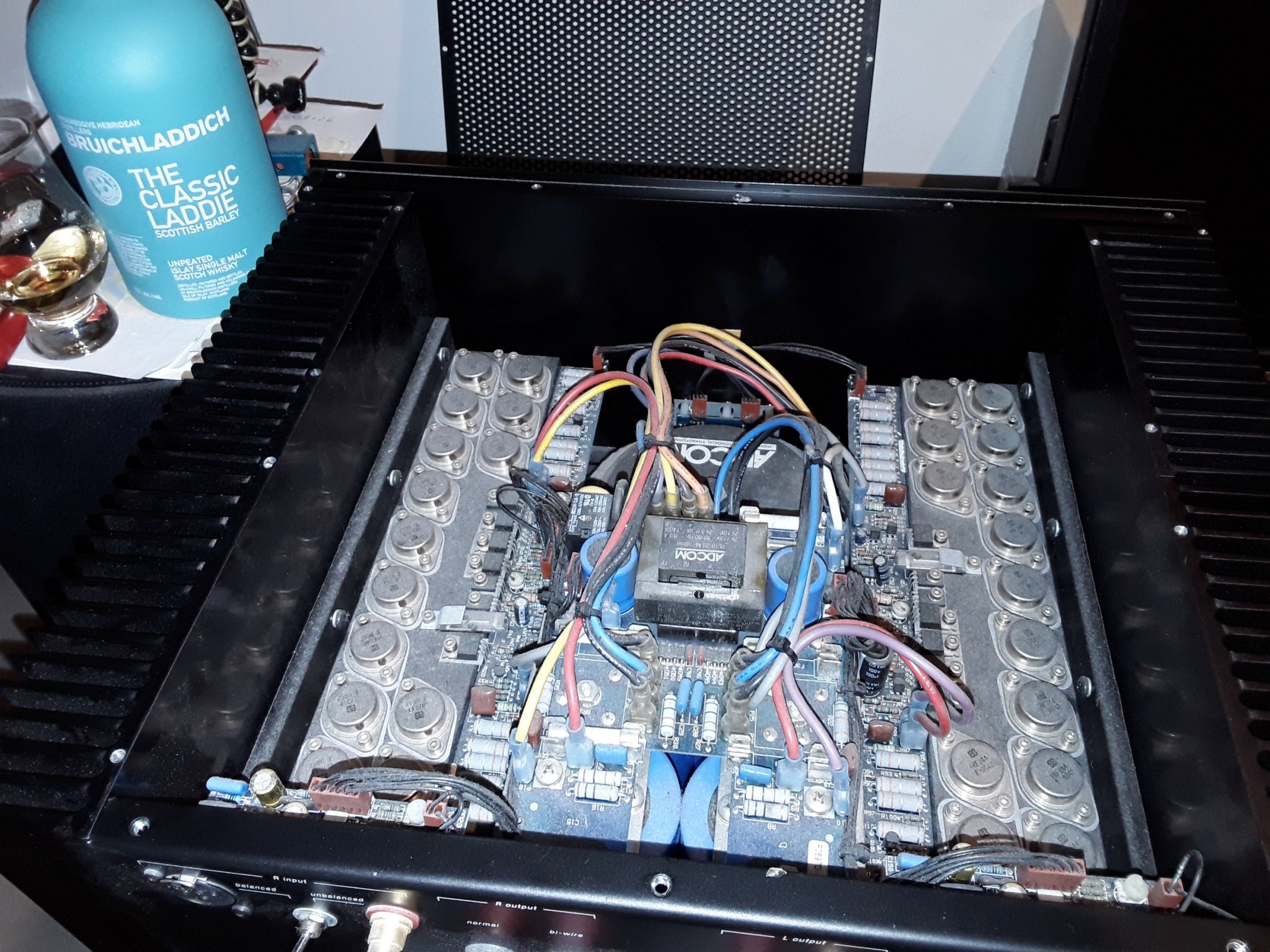

Hi all. Looking at maybe putting two ACA kits into one case. I have a power amp by Adcom, GFA-8520 that has one dead channel. The heat sink area is quite large (350 x 200 x 50 mm). The amp is A/B and IMO, ran hot when it was working. Just wondering if this is a wise idea if I were to gut the interior and put these little guys in it. The case is in excellent shape, and quite beautiful to my eyes. Love to not see it in the dumps.
that one also looks as from Papa's shop
pity to gut it
sell it as is, if nothing else, someone will be happy to repair and use it
then buy new case
pity to gut it
then buy new case
I agree with ZM, it would be a real pity to cannibalise that. Those boards would clean and wash and come up like new... yes it needs repair but that is half the fun 🙂
