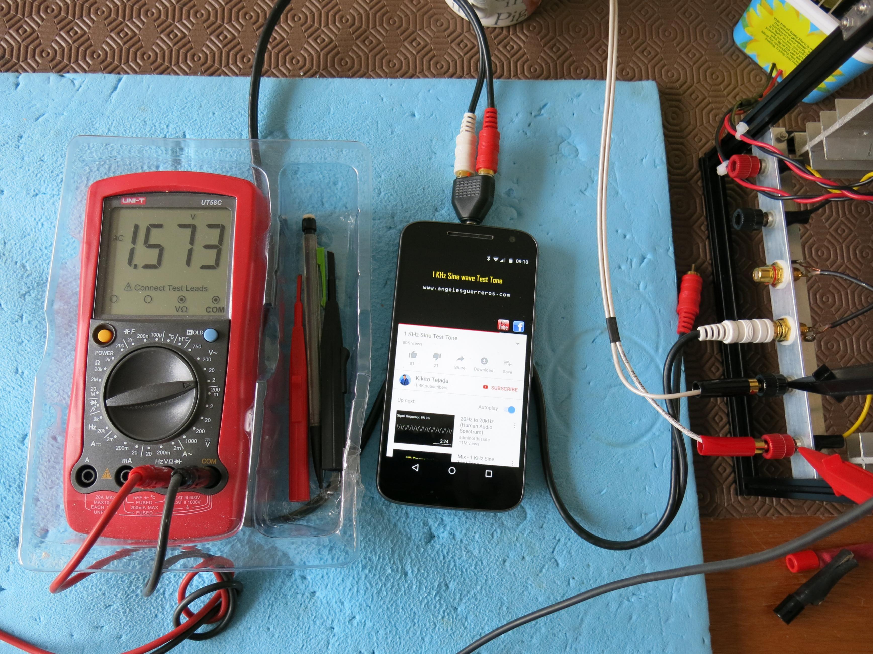

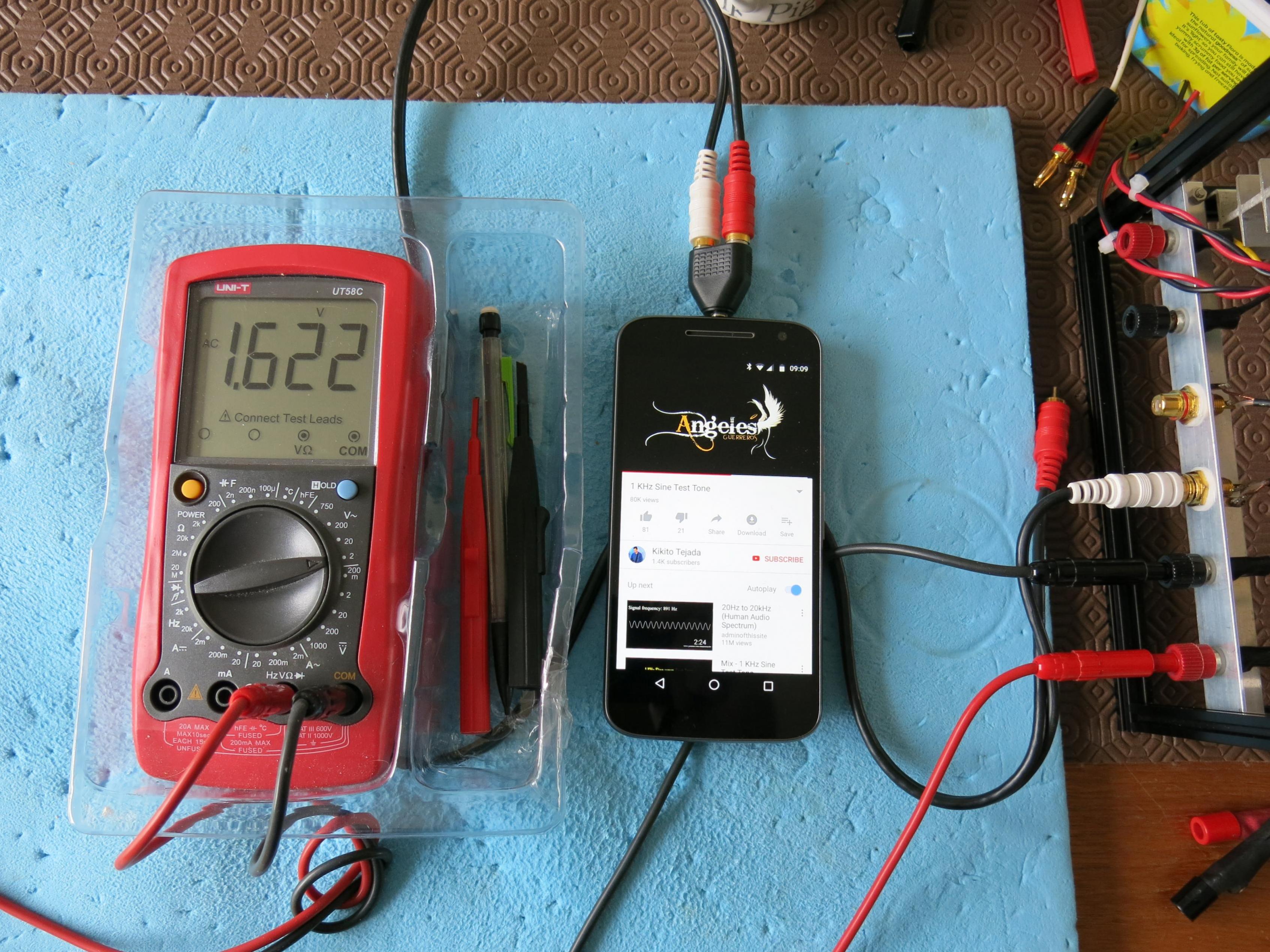

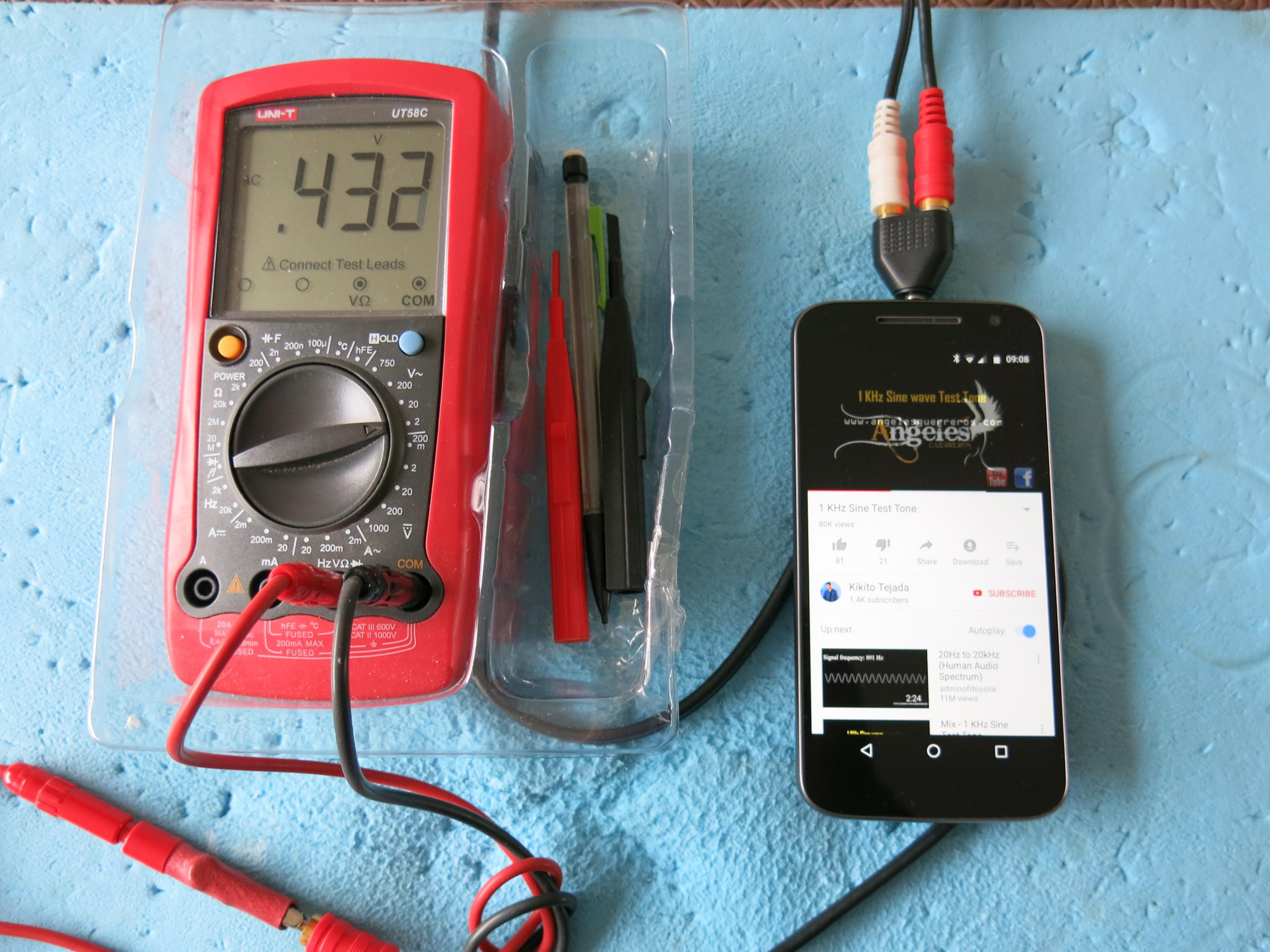

Quote: ''Here is a way to test your ACA is amplifying correctly. I just tried it on mine and this is what I did.
Used my mobile phone and went to this site for the 1 kilo Hertz test tone, it is a bit louder than some. 1 KHz Sine Test Tone - YouTube
I turned my phone's volume to maximum and measured the AC voltage at the head phone socket playing the tone. Mine is 0.43 volts AC. Yours might be more or less, just note what it is.
Then I plugged the phone into my ACA and measured the output at the speaker terminals. (No speakers connected.) I get 1.622 volts AC.
If I connect my speaker (8 ohms) and measure I get 1.57 volts AC.
Again yours might be different just note it.
So on my amplifier for an input of 0.43v ac I get 1.57v ac out.
3.6 times amplification and you should get something similar if all is well.
Hope that helps.''

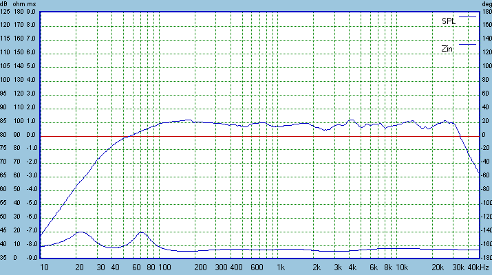

Impedance graph SR71
The graph is pretty flat. I tried attaching the graph so let's see if it works?What does the impedance look like?
The impedance response of this loudspeaker is quite flat.

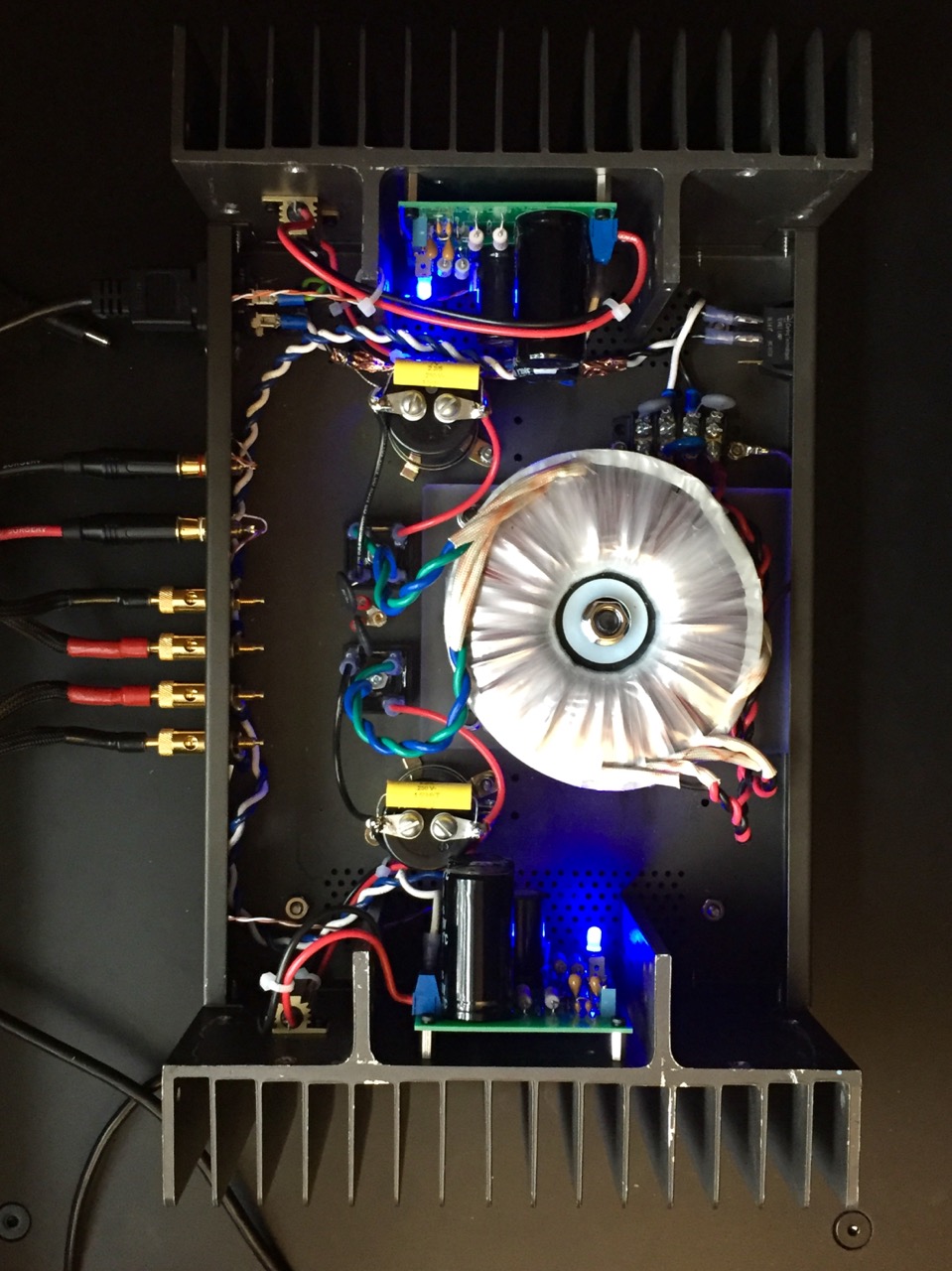

hi dave
As i remember right YES...Tungsten wrote it several times (ACA premium) that he has more then 1 version. this pic shows the ACA with regular power supply.
chris
chris
It is actually a DH-220 chassis. Rounded fins and a different arrangement of connectors on the back panel. Works brilliantly for the ACA.
