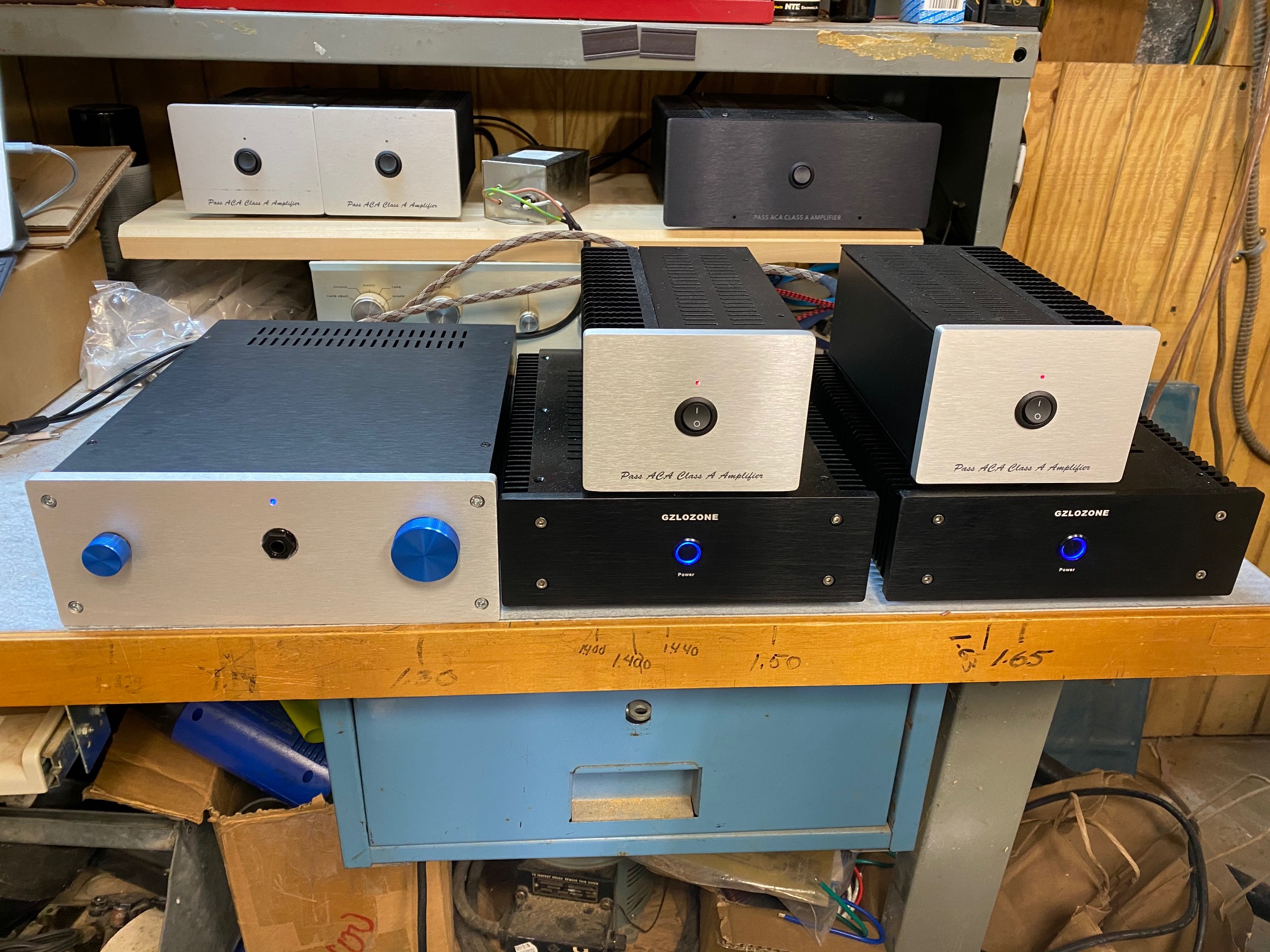

I have had a similar experience with my office system (haven't been in my office since February). I'm using a pair of 24v 2016-vintage Pass ACA monoblocks (the itty-bitty ones) to drive a pair of Linaeum LFX monitors in near-field. Given the low sensitivity of the Linaeums, this shouldn't work well, but they sound fantastic (especially when I added the Titan 10" subwoofer).
