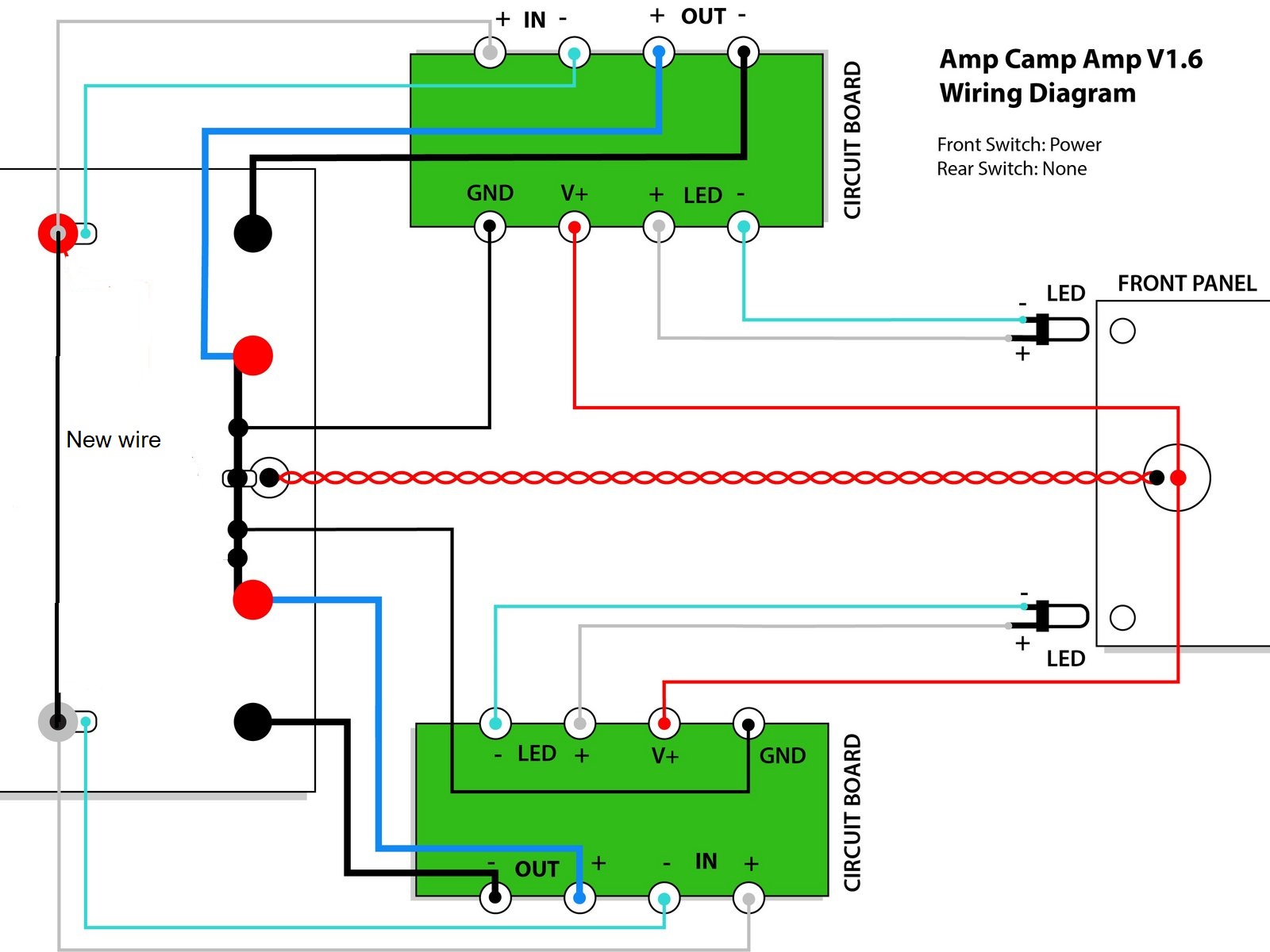

Hi I want to try the parallel mode with Alpair 10p but each time I think Ive understood how to I get confused. The build guideS all show XLR and switch used, I have neither just rca inputs and speaker output posts so I'm confused as to how to wire without those. If anyone can help it would be very much appreciated.
Do the outputs the same, just link the two Black posts together with suitable wire as in the pictures. Done.
For the inputs you have a choice,
1: buy an RCA 'Y' splitter or adaptor like this (example only) : https://www.amazon.co.uk/Female-Spl...t=&hvlocphy=9045390&hvtargid=pla-803463600413
2: wire both the centre pins of the RCA sockets together inside the ACA. Again you can use either input socket and or output pair. Alan

Yes, you solder all the connections.
For the XLR and RCA centre connections it will help if you 'tin' the wire ends first. Then you can load a little extra solder on the tip of the iron, hold the tinned wire in place (in the trough) and put the iron against the two parts, the solder on the iron will help transfer heat to the joint and also flow into it. Add a little more solder if it looks poor. All to do with experience and every one has a different technique too.
As for length, just strip the same length of insulation as the length of the 'trough' it will fit in.
Alan
