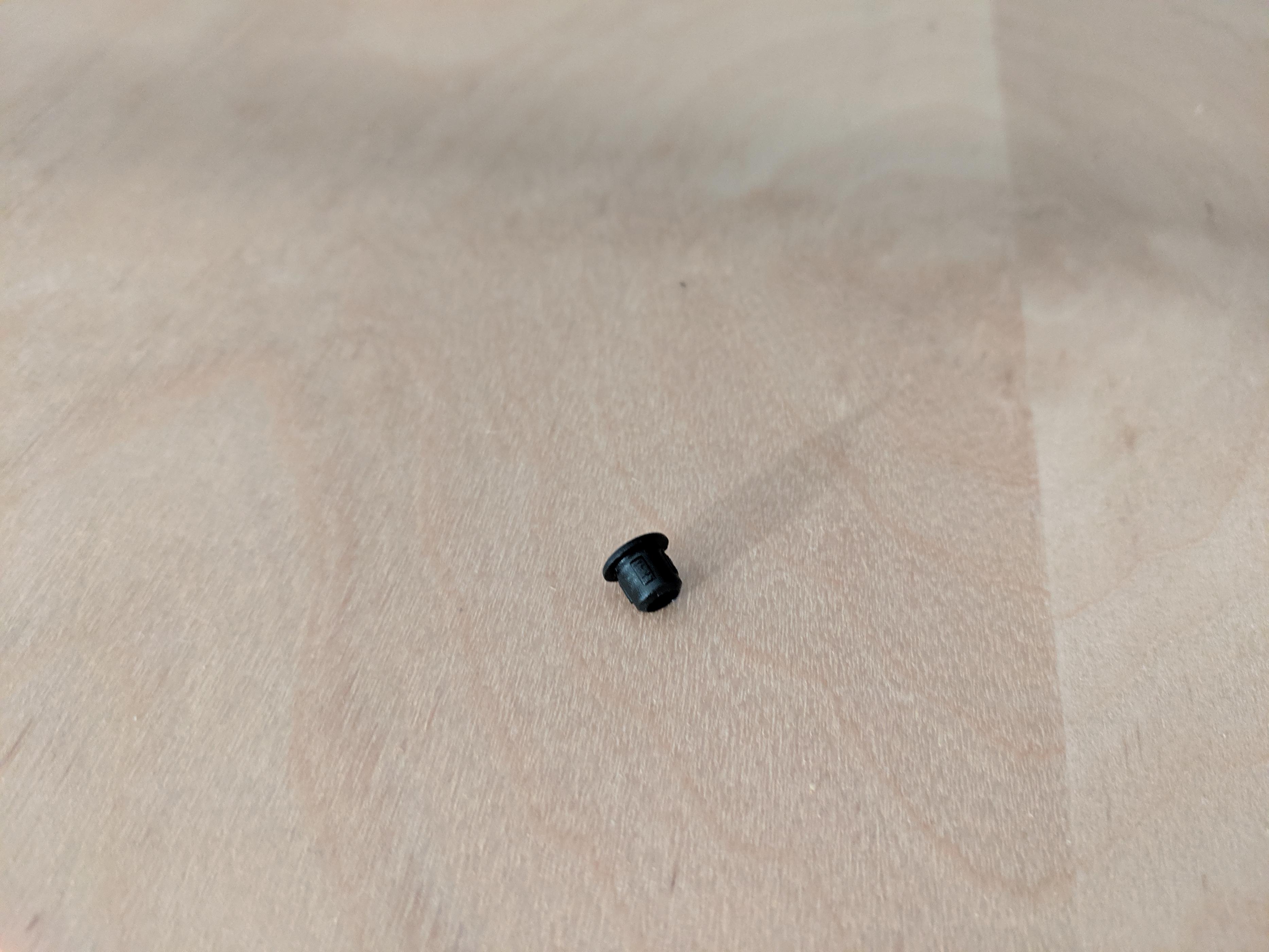

Not exactly sure what you mean by "switch plug", but everything fit on both of my ACA v1.6's.
Huh. I attached photos. I have the empty hole where the rear switch would have been and a press fit plug which I assume goes there. The plug fits inside the hole, but there is no friction to keep it in place.
