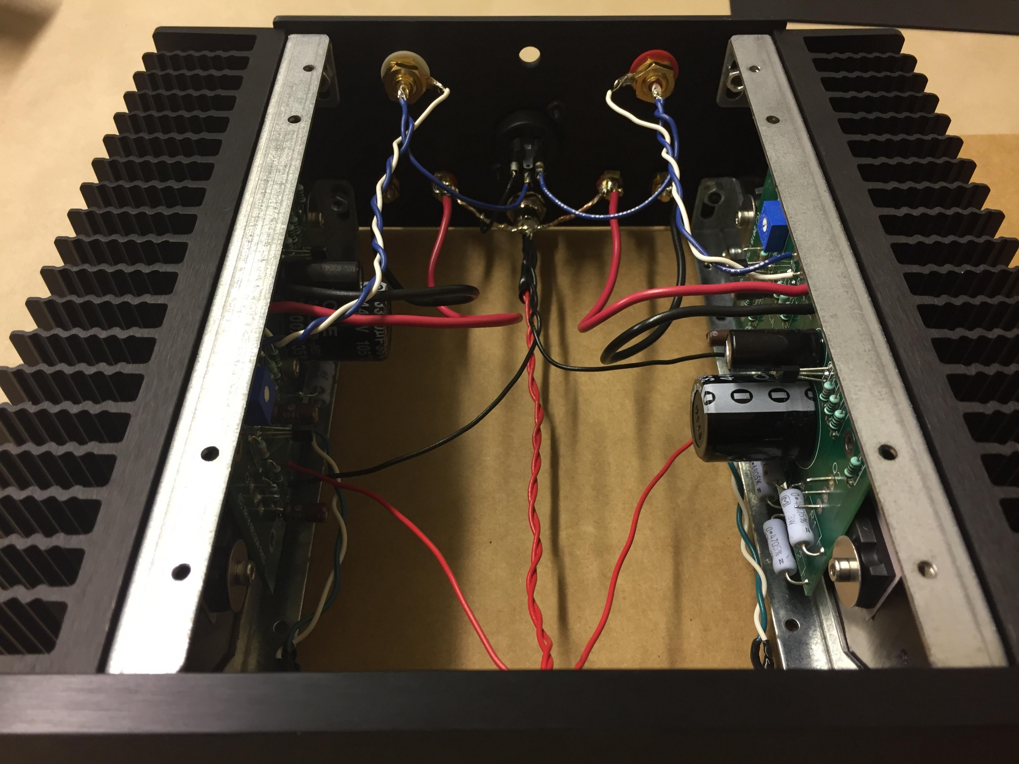

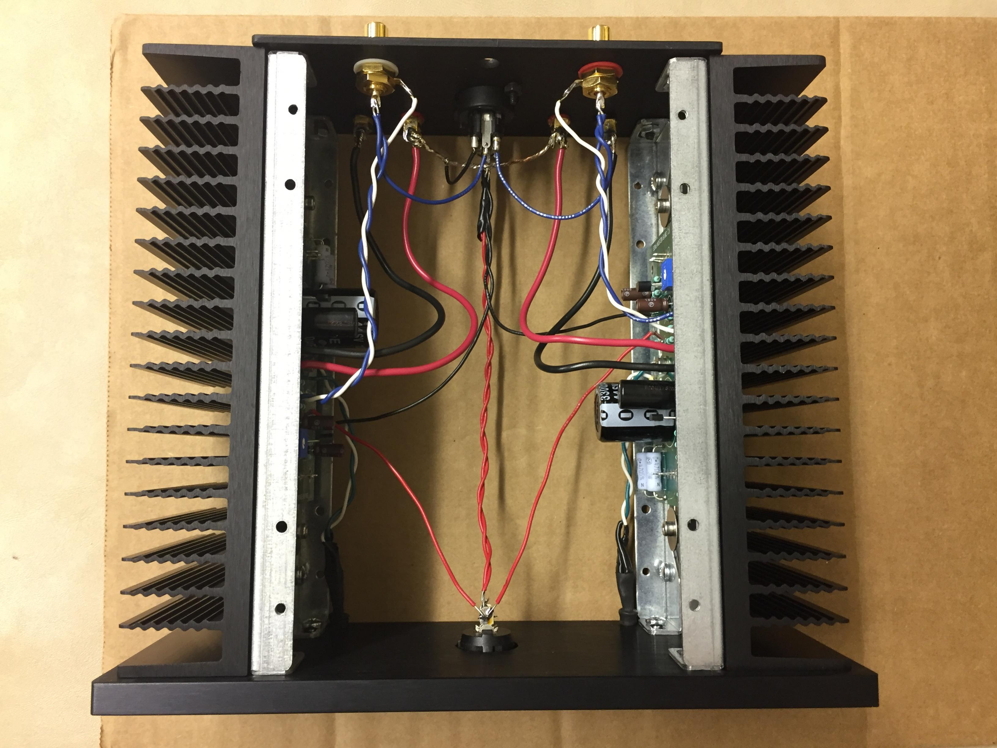

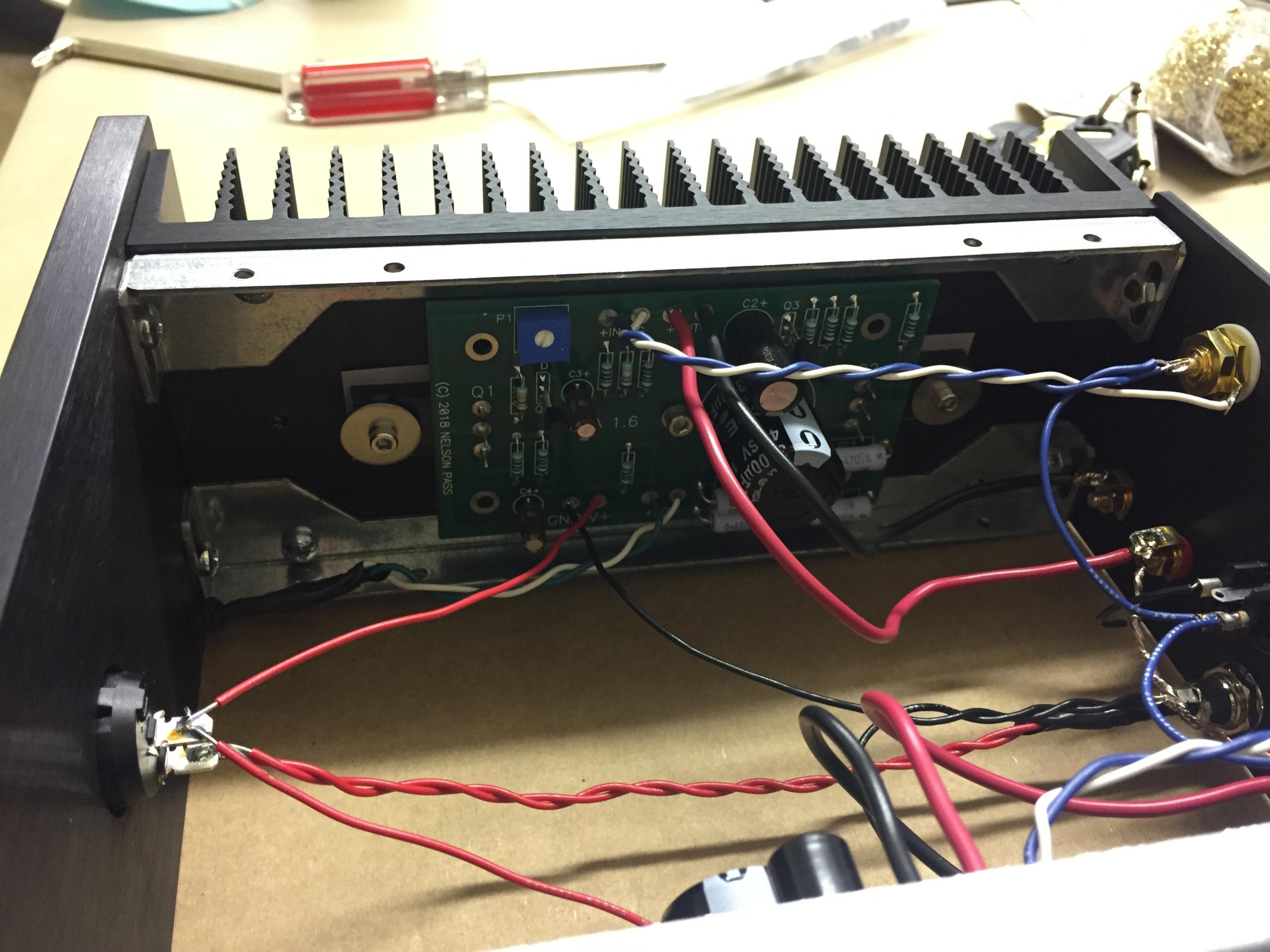

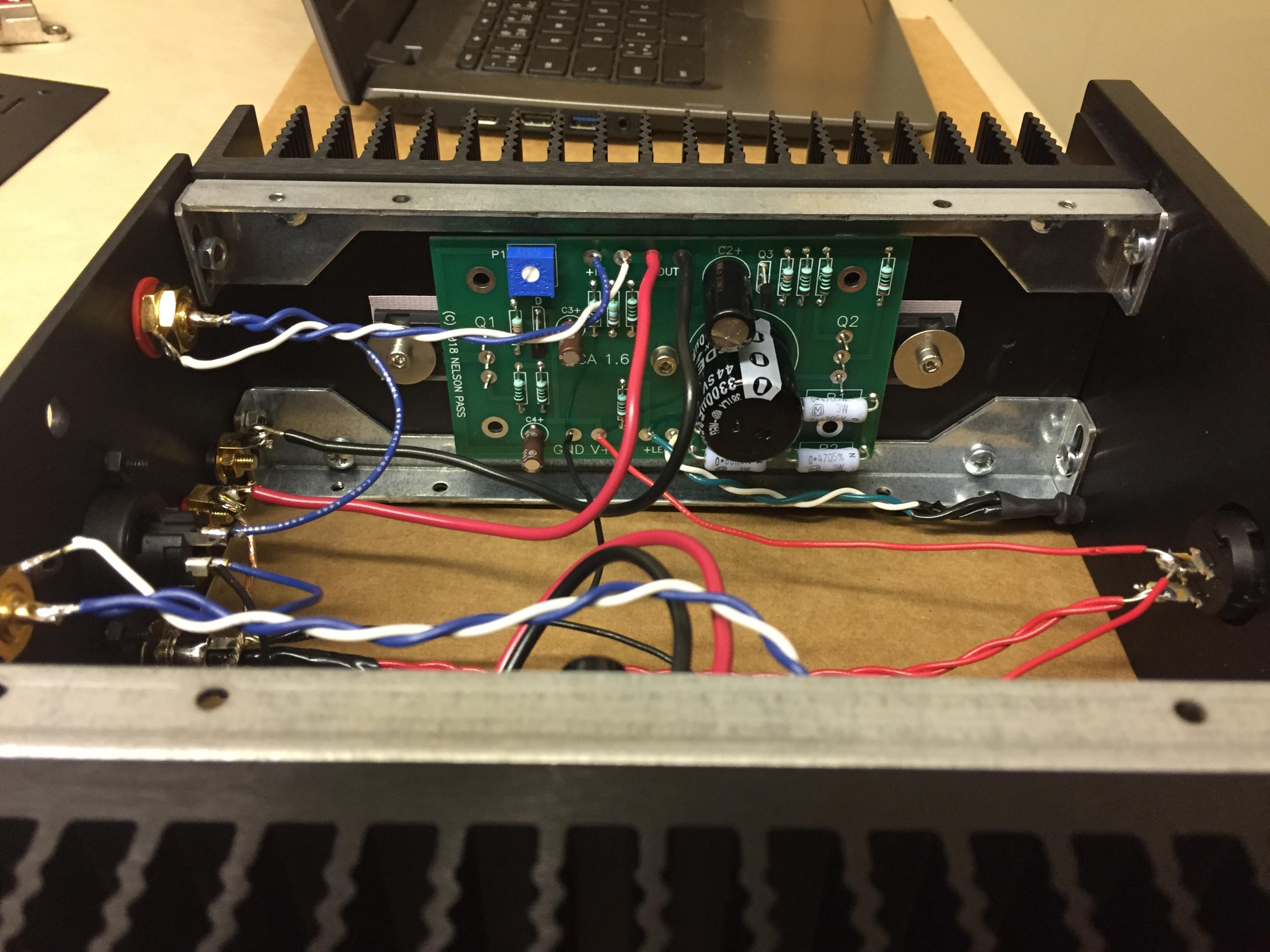

I finally finished my ACA. I set the initial bias to 12V, screwed the bottom cover on and layed the top cover on. Then played some music for 30 minutes or so and reset the bias to 12V again (it hadn’t drifted more than 0.1V). The heat sinks get warm, but I can easily hold my hands on it for 10 seconds and I have wimpy hands Lol. I didn’t see anything in the 1.6 build guide about letting it warm up but assumed it would change. Do I need to check it again? I seldom get to listen for more than an hour at a time, fwiw.
Well I am nearly finished. The process has not been without tribulations.
My multimeter’s leads fell apart at the start, requiring a haphazard soldering. My multimeter can’t get close to measuring the large resistors.
One transistor refused to solder properly, especially one leg. It cold soldered repeatedly for no apparent reason. I was worried all that heat would harm the transistor... then I saw how much heat the transistor puts out when powered up.
Both potentiometers kept cold soldering too.
The LEDs barely seat in holes; I made the leads too short.
I bent the legs on one transistor the wrong way, initially.
Putting the chassis together is something of a Rubik’s cube. Shift one part one way and you block another.
The pinnacle of issues might be what occurred at the very end. I was re-tightening all chassis screws when I snapped the head off a screw holding bracket onto heat sink. Anybody got an extra heatsink, ha! I have the capacity to over tighten like no other. I could leave it. But I would bet that I take that side apart and drill out the remaining shaft.
I’m guessing I’m 12+ hours into it. I would test the amplifier... but I don’t have any speakers currently. True. Hopefully it turns out well in the end.
Pics attached. I went off book with some wire color choices.

Are you applying the soldering advice offered in the build guide?
Amp Camp Amp V1.6 Build Guide - Step 8 Solder Resistors
As I explain in the guide's comments, I built my ACA with a soldering temperature too low. It worked but I may have put excess heat into components. There going strong so far but may check out early in life as a result.
I probably made it through ok because I sourced eutectic solder for the job. See the guide for relevant advice.
I'd expect if you follow the guide for temperature and solder you won't go wrong. I got myself a magnification head band + lamp arrangement. Inspecting the quality of your own work is an easy way to pick up issues and fix them before they become a real problem.
